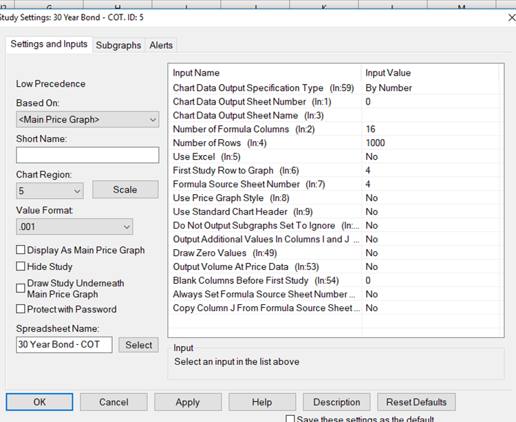

Ok I added my 3 columns of data under columns AS, AT, and AU of the spreadsheet. I then started at column K and put '=AS3' then '=AT3' for column L, then '=AU3' for column M. It has populated all of the values down the column so this appears to look good. Each cell in these columns has a small triangle in the upper right. What does that mean?
I'm expecting to have the chart graph these 3 columns in the region I've chosen but it shows only 2 of them and the values are incorrect. Plus it stops in the middle of 2016 and my values are inputted up through last week. What am I missing? I do not have values in the 3rd row as this is a weekly chart and I do not have values for this week yet. For 'first row to graph' I entered 4 since the values start at this row.
I've attached my settings for the study. Please advise.

[2017-06-26 22:31:19]
Sawtooth - Posts: 4355
This means the cell has a formula; it is not empty.
The Number of Rows is set to 1000. Do you have more than 1000 rows of data?
Values in Formula Columns will plot horizontally (not in columns) with each spreadsheet row corresponding to a chart price bar. The most recent bar is in row 3, and earlier bars are in rows below. If values are similar in each column, columns to the right might overplot those to the left.
Also, a word of caution: be careful when adding studies, or increasing the Number of Formula columns, as study outputs or new blank columns could overwrite your data in AS, AT, AU.

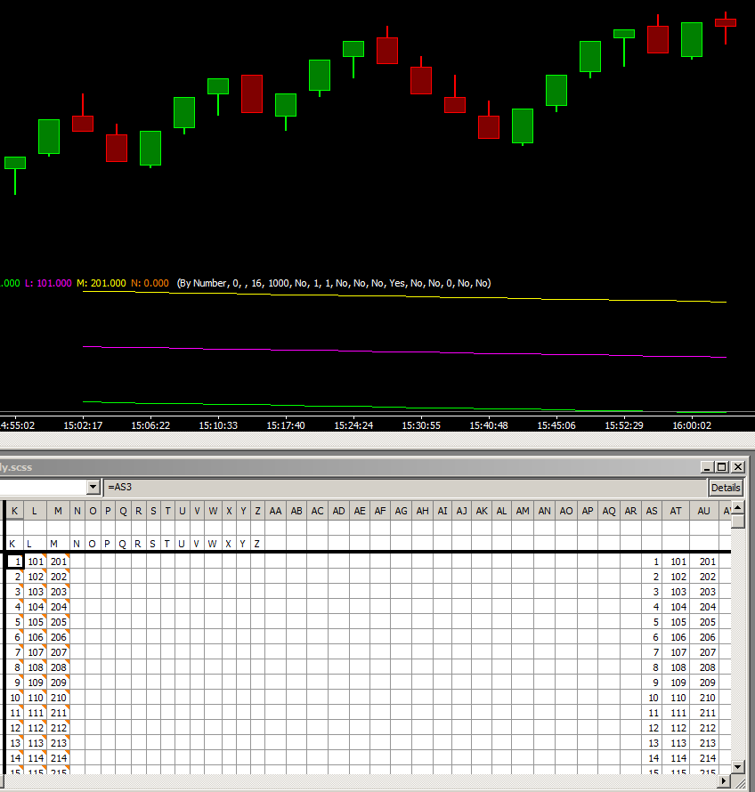

[2017-06-26 23:50:47]
I did a quick test and it works for me. See pic.
I copied/pasted from Excel into AS, AT, AU.
imagegraph data.PNG / V - Attached On 2017-06-26 23:42:29 UTC - Size: 45.5 KB - 473 views
[2017-06-26 23:54:43]
User104854 - Posts: 460
Ok. Looks good. I'll play around with it some more. If I can't get it to work I'll reach out to you by email. Thanks for testing it.
