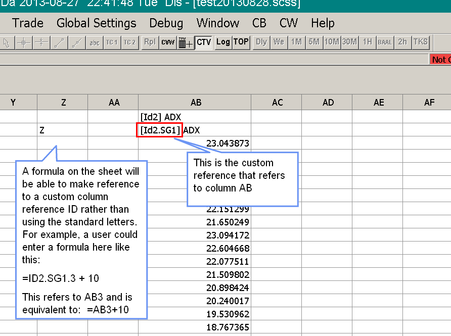

1. We are working on a new method to reference studies outputted by the Spreadsheet Study in the non-CLR version of Sierra Chart. The reference method will be by using the studies unique ID, the subgraph and the row number.
It has long been a problem when studies are added, removed or the number of subgraphs in a study changes and references to existing studies are thrown off. This makes formula maintenance difficult. We now have a comprehensive solid solution for this.
With the changes planned, any time a study is added or removed, existing references will be fine as long as they are not referring to a removed study. If the number of subgraphs in a study increases this will not be a problem either.
This image shows an example of the new format:
http://www.sierrachart.com/images/NewSpreadsheetStudyReferenceFormat.png

If using the same spreadsheet for more then one chart and all charts have the same study's it seems to me that the new method do not work as the reference number is the same for all charts on the same study.The reference number is the same on all sheets in the spreadsheet. Regards Outlander
[2013-09-07 02:26:16]
These new Study Subgraphs references are specific to individual Sheets they are displayed and used in. Unless they are prefixed with the sheet name.
For example you will be able to do something like this:
Sheet5!ID1.SG2.3
This is not quite supported yet.

What is the new address for A3 date time cell? ID0.SG0.3?
ok, understood, A3 works well. I'm just wondering why cell B3 can be referenced in both ways - using new style ID0.SG1.3 and old B3... at the same time A3 doesn't have new style address.
Date Time Of Last Edit: 2013-10-01 12:20:02
[2013-10-02 01:28:06]
There is not a new reference method for column A and there does not need to be one because that is always constant and present. Date-Time data is not normally part of studies.

To reference a cell from a study column using the new alternative reference method, use this new format:
[OptionalSheetName!]ID[StudyIDNumber].SG[SubgraphNumber]@[RowNumber]
Example:
Sheet5!ID1.SG2@3
The old format which uses a dot before the row number is no longer supported.
Date Time Of Last Edit: 2014-10-27 16:39:34
[2014-08-14 08:09:04]
Outlander - Posts: 91
It did not work get the error "#NAME?"
This is the code I used =Sheet3!ID1.SG1@3
Regards Outlander

[2014-08-14 18:53:45]
We see a problem with the alternate reference method for Study Subgraph columns on spreadsheets which will cause a NAME error.
We are working to resolve this now.
[2014-08-15 04:01:18]
The problem with using the alternate referencing method or identifier for Study Subgraph columns on a Spreadsheet, has been resolved in 1174.
Update Sierra Chart to the latest version through the Help menu.
Here is a new video we put together featuring some of the improvements in the new spreadsheets including the new alternate reference method:
