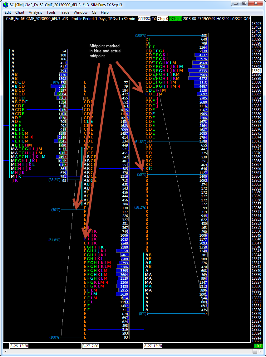

I'm using the midpoint option in the TPO chart, but it doesn't appear to be marking the actual midpoint. See attached. Any ideas?
image27-08-2013 23-44-45 midpoints.png / V - Attached On 2013-08-27 22:47:03 UTC - Size: 165.54 KB - 981 views

The common reference for midpoint in a MP strategy is half way from the high and the low of the price action. Often times this can be referenced two ways within the complete session of the profile and within each 30 min session. Sierra Charts has programmed there midpoint to be a representation of a TPO count and not the midpoint or half way back from price action. I am not aware of anyone that uses this or teaches this. Would someone from Sierra review this and determine the initial intent of this function/feature of the profile. My guess since the major teachers of this style ie Jim D., Linda R., Pete S., Richard W. etc use it in the manor I described it might have been overlooked in the design process.

The programmer who originally did the midpoint calculation for the TPO Profile chart in Sierra Chart, is no longer with us. We do not know what the basis of it was. We had a look now at the Market Profile handbook from the CME and we see the midpoint is just the middle of the price range. So we will program it to work that way.
This will be out in the next release coming out later today.

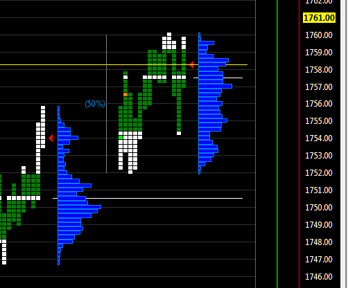

in the meantime you can use the price retracement tool showing only the 50% level - my preference is to use a vertical line from high to low, with only the 50% level selected, just to the left of the current TPO profile
[2013-10-29 12:02:32]
User16114 - Posts: 153
pic attached (I think), if this doesn't work will figure out how to attach later
imagehalfback.PNG / V - Attached On 2013-10-29 12:00:38 UTC - Size: 12.65 KB - 932 views

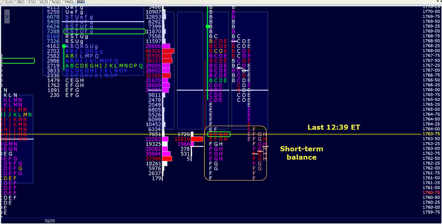

Not to overload you but a few more things we could add too the wish list are.
1. Have both the split out profile and the complete profile side by side as they develop.
2. Have two columns of volume beside the price traded showing the total volume at that price and the second showing the volume traded at that price during that 30 min session.
I have attached a screen shot of what I am talking about.
Thanks for your consideration
Doug
Date Time Of Last Edit: 2013-10-30 17:38:09
imageProfile Wish List.png / V - Attached On 2013-10-30 17:37:49 UTC - Size: 583.78 KB - 1707 views

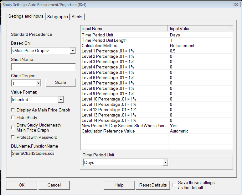

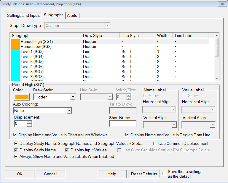

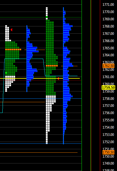

with respect to the original support request from Allan Stevenson, I have started using the "Auto Retracement/Projection" study (cyan line on attached "auto retrace 3" png) with the settings attached to automate halfback.
is there a better way out there?
imageauto retrace 1.PNG / V - Attached On 2013-10-31 12:22:46 UTC - Size: 39.66 KB - 745 views
imageauto retrace 2.PNG / V - Attached On 2013-10-31 12:22:57 UTC - Size: 41.78 KB - 789 views
imageauto retrace 3.PNG / V - Attached On 2013-10-31 12:30:46 UTC - Size: 19.01 KB - 712 views
