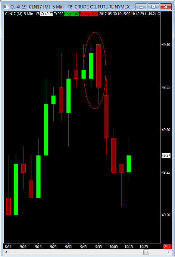

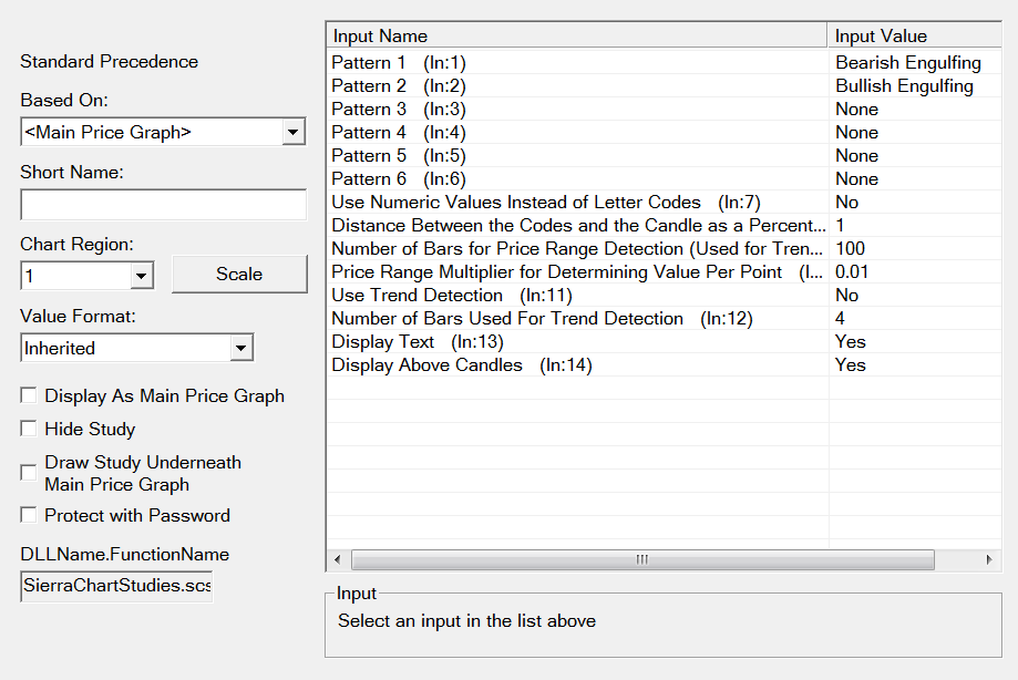

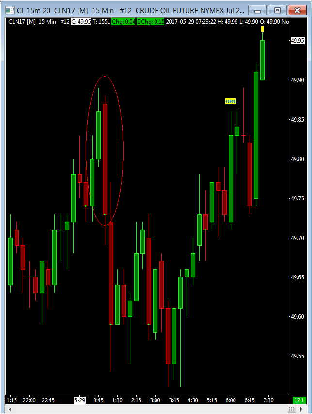

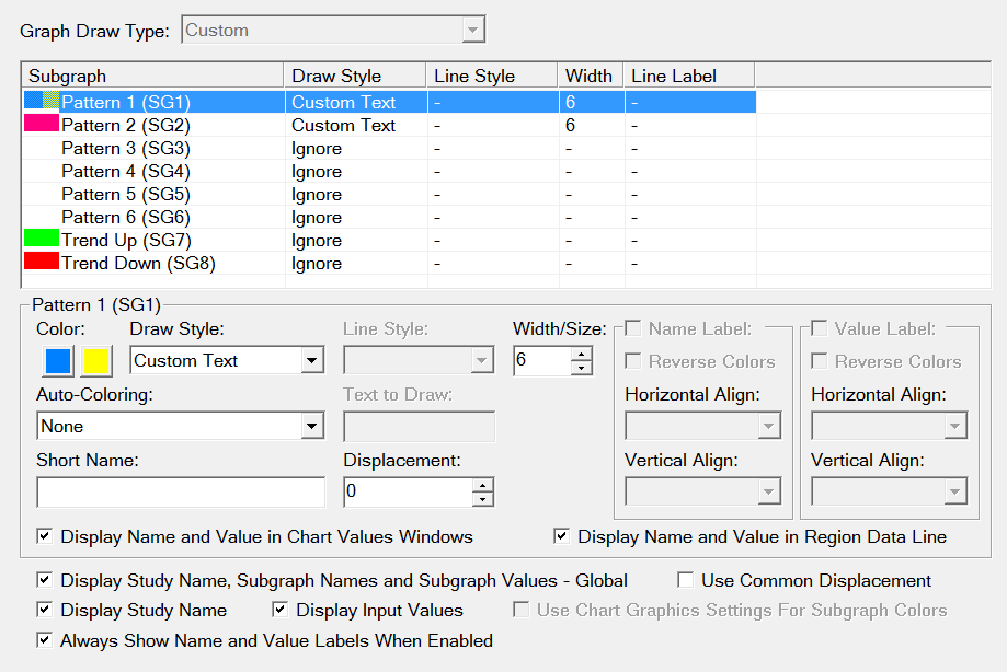

First, I dont think it identifies all of the patterns selected, but I guess I need to ask whose definitions of the candlestick patterns are you using? Second, I want to make sure I am setting up the inputs properly for MORE THAN ONE PATTERN. In my examples, I wanted to ask it to identify bullish engulfing and bearish engulfing. Engulfing definition is completely engulfing the previous bar's candle body. From what I see, it identifies SOME bull engulfing, but not others. It isn't identifying any bear engulfing from what I can see, so I question the setup of having more than one pattern selected.
The first 2 attachments are asking if the setup of the study for multiple patterns looks correct, the second 2 attachments are examples of engulfing patterns it DID NOT IDENTIFY, if I have set up properly There were others.

The Candlestick Patterns Finder settings you have are valid.
The reason for the failed detection has to do with the particular conditions that have to be met for those patterns. We have documented them here:
CandleStick Patterns Finder: Available Patterns

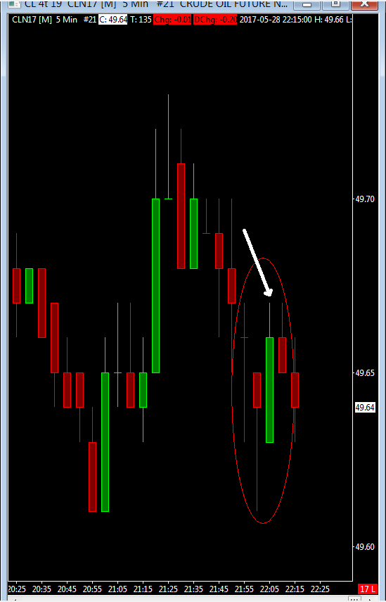

Your trigger for engulfing patterns isn't quite right.
True engulfing pattern (many of the best sources):
An engulfing pattern is characterized by a candle whose BODY engulfs the previous candle’s BODY. If the engulfing candle’s high and low engulfs the previous candle’s high and low, the pattern is found to be more valid, but not required.
Your engulfing pattern only triggers:
If the engulfing candle’s high and low engulfs the previous candle’s high and low.
This is too strict, and many good signals go unnoticed. Most principles in candlesticks rely on the open vs the close (body), not as much the tails. Can this please be changed? or have 2 categories of engulfing that differentiate between these two. IMO it makes no sense to have a pattern for engulfing if many of these slip by the system.
I have attached 2 recent examples of the engulfing pattern existing but not a trigger in SC with your strict rule.

We will add additional "bullish engulfing and bearish engulfing" pattern detectors that use the body only.
