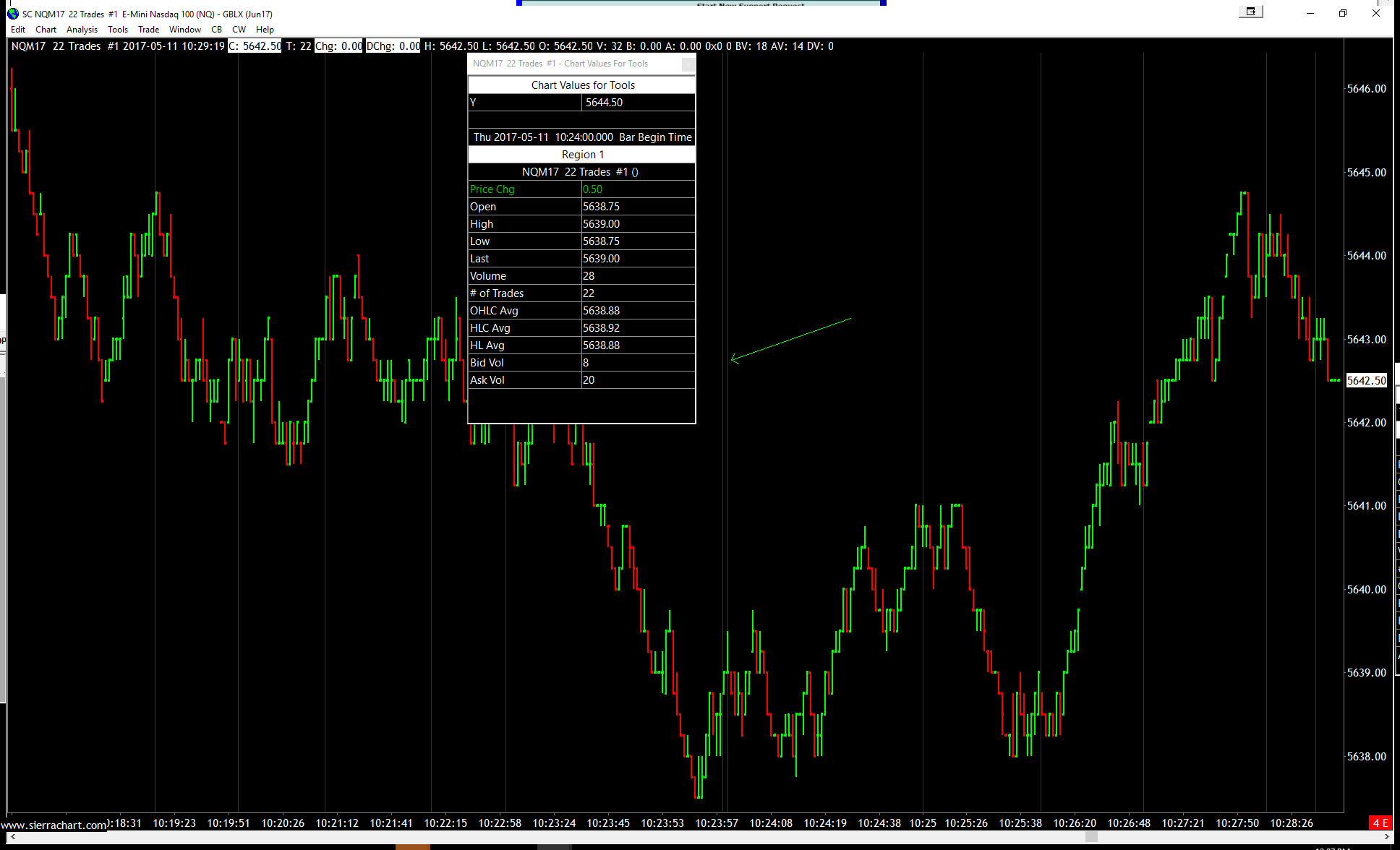

2) There is a small but annoying bug in the vertical grid line logic. On a 22-tick NQ chart, set to show a vertical grid line every 1 minute, every once in a while a duplicate line appears - two vertical grid lines are displayed on adjacent bars that are only a few seconds apart.
As far as I can tell, this only happens when the first bar starts on an exact minute boundary with .000 milliseconds. For example, with Vertical Grid Lines set to display every 1 minute, I see a line, correctly, when a bar paints at 9:33:00.000. But then another grid line appears, incorrectly, on the next bar at 9:33:01.016. Another case is 9:53:00.000 and 9:53:04.002. In every case I've checked, the first line shows at .000 milliseconds - the logic for the next bar is not recognizing that the line for that minute has already printed on the .000 bar.
Here's an example, with lines at 10:24:00.000 and 10:24:00.022:
http://www.sierrachart.com/image.php?Image=1494788824591.png
(This image also demonstrates the random relationship between the vertical grid and the time labels.)
