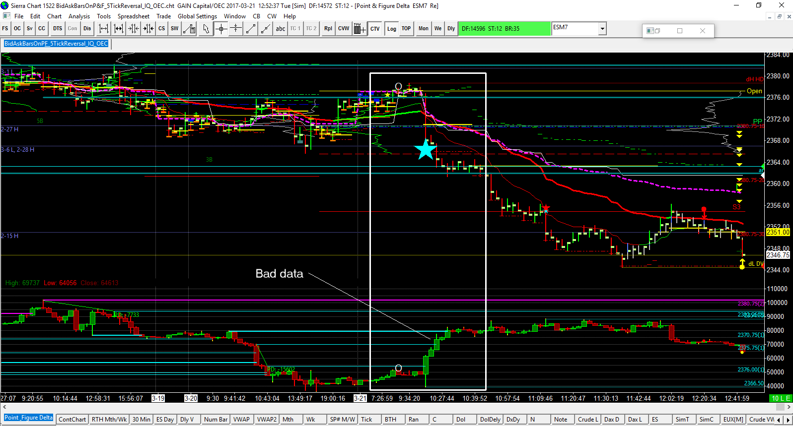

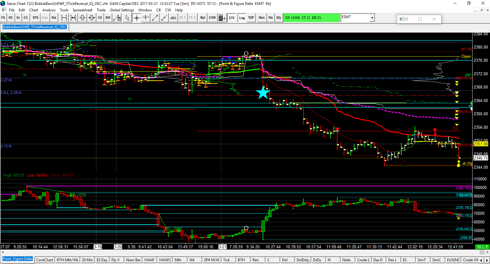

The is a problem with the historical volume data for Gain Capital. As the picture shows. The cumulative delta data is very wrong. As the market goes down, cumulative delta is going up. This is the opposite of what is expected. The real-time data looks good. The historical data is wrong.
Looks like when the market moved fast the data was not saved correctly. This has been happening for at least a week now.

This is a data feed problem from Gain Capital. Most likely there is a problem with the bid and ask data. Either it is delayed or has stopped updating or is wrong in some other way.
We will correct the data for the last week. However, we cannot solve the problem and it can reoccur. For a good data feed use the Sierra Chart Exchange Data Feed:

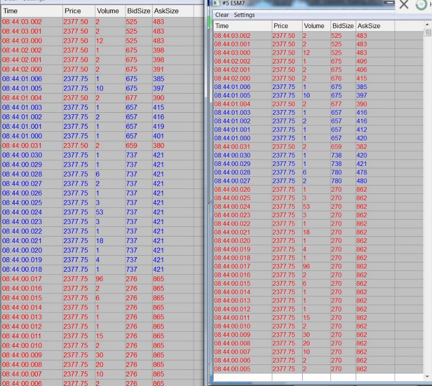

I have the same problem (with both real-time and historical data)and done a comparison between TransAct and Gain data feed.
Please look at the attached file. it seems that with Gain some Bids are reported as Ask. The one on the left is from Gain and right one is from TransAct.
You can clearly see it between:
8:44:00.018 and 8:44:00.026
Is this a Gain problem or some settings in SC?

In response to post #5, this is a data feed issue.
