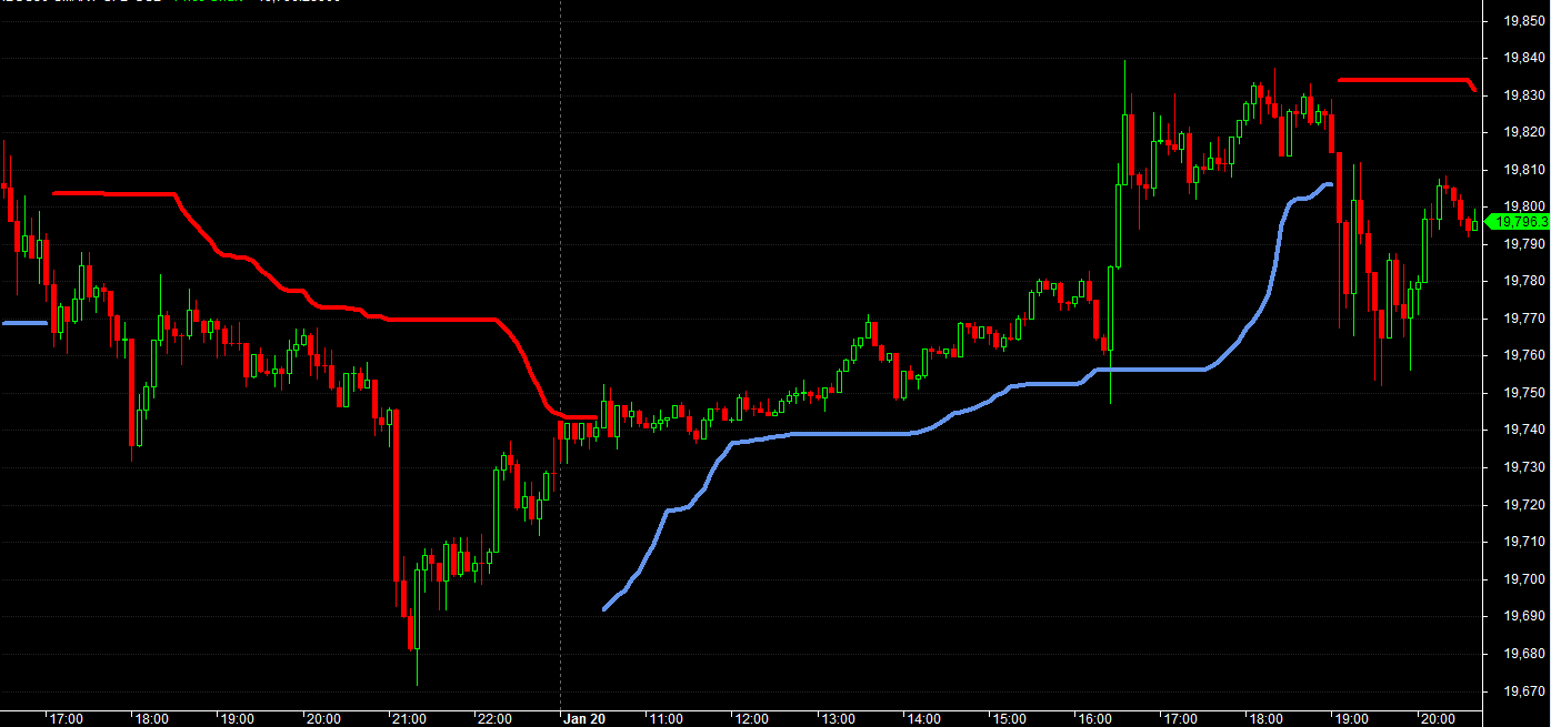

Actually What I want to finally do is track the lower line when there is a close above the upper BB, and when there is a close below the lower BB track only the upper line. I like it because I force myself to trade with the trend and keeps my chart clean.
Here is a screenshot for reference
imageBB.png / V - Attached On 2017-01-26 18:25:41 UTC - Size: 22.7 KB - 420 views
