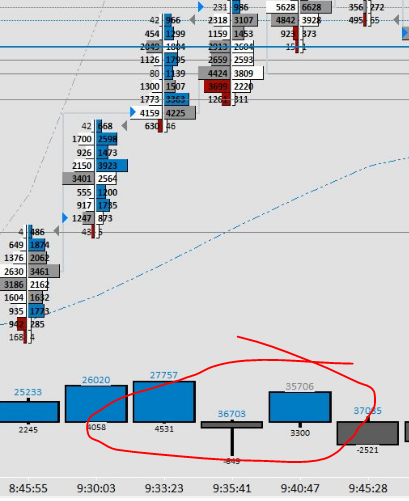

How can I have the delta volume as in the picture?

[2017-01-18 23:48:06]
What exactly do you mean by Delta Volume?
[2017-01-18 23:51:59]
User252419 - Posts: 236
The difference between the volume up and the volume down, like in the picture attached.
Thank you
[2017-01-19 02:17:33]
We still are not completely clear what you are looking for. Have a look at these two studies:
https://www.sierrachart.com/index.php?page=doc/TechnicalStudiesReference.html#s127 Bid Volume Versus Ask Volume
https://www.sierrachart.com/index.php?page=doc/TechnicalStudiesReference.html#s292 Cumulative Delta Bars-Volume
[2017-01-24 11:46:55]
I am using Cumulative Delta Bars. How could I see the high and low label of each candlestick?
So for example, in the cumulative delta bar candlestick at 11:07 I would like to see a label above the candlestick showing the cumulative volume 1465 (max of that candlestick) and a label below the candlestick showing the cumulative volume -760 (min of the candlestick).
Thank you
[2017-01-24 19:29:15]
You will want to use this study:
https://www.sierrachart.com/index.php?page=doc/TechnicalStudiesReference.html#s373 (Study Subgraph As Text Above/Below Bar)
You will need to base it on the Cumulative Delta Bars study.

[2023-09-10 22:48:50]
User260640 - Posts: 21
I think the original user was looking for a study often referred to as the Delta Indicator, just like the UpDownVolumeDifferenceBars, but for delta volume.
Grab the Original UpDownVolumeDifferenceBars study code and change the following:
  SCFloatArrayRef Array_DownVolume = sc.BaseDataIn[SC_DOWNVOL];
  SCFloatArrayRef Array_UpVolume = sc.BaseDataIn[SC_UPVOL];
  SCFloatArrayRef Array_UpDownVolumeDifferenceHigh = sc.BaseDataIn[SC_UPDOWN_VOL_DIFF_HIGH];
  SCFloatArrayRef Array_UpDownVolumeDifferenceLow = sc.BaseDataIn[SC_UPDOWN_VOL_DIFF_LOW];
to
  SCFloatArrayRef Array_DownVolume = sc.BaseDataIn[SC_BIDVOL];
  SCFloatArrayRef Array_UpVolume = sc.BaseDataIn[SC_ASKVOL];
  SCFloatArrayRef Array_UpDownVolumeDifferenceHigh = sc.BaseDataIn[SC_ASKBID_DIFF_HIGH];
  SCFloatArrayRef Array_UpDownVolumeDifferenceLow = sc.BaseDataIn[SC_ASKBID_DIFF_LOW];
Not sure this has been done, but it works.
