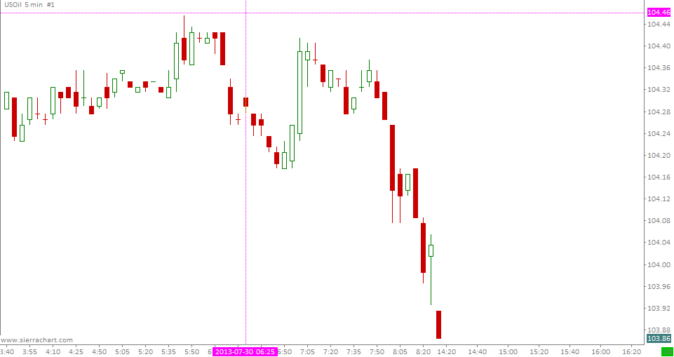

Hi, I seem to be having a problem recently in that data isn't getting updated correctly.
I normally use the associated watch list to quickly scan charts but recently I've found that the data between the time's I've viewed a chart isn't being displayed. The only way I can get this data back is by selecting 'delete and download data' every time I view the chart.
Below is a screenshot, the problem in this instance is no data between 8.25 & 14.20
http://www.sierrachart.com/image.php?l=1375190186266.png
If I leave the chart open it updates fine.
I can't see any error messages or connection errors in the message log.
Data feed I'm using is SC Forex Data(FXCM)
This isn't a one off occurrence either, it seems to be happening every time I go back to view a chart.
Can you please assist?

[2013-07-30 16:14:28]
To make sure that Sierra Chart will maintain chart data for the symbols you are following add them to Edit >> Intraday File Update List:
https://www.sierrachart.com/index.php?l=doc/doc_EditMenu.html#IntradayFileUpdateList

[2013-07-30 16:49:59]
This is unusual. Next time this happens, let us know the time it happens (in the time zone setting of Sierra Chart) and the symbol. At that time post a copy of the Message Log, by following these steps:

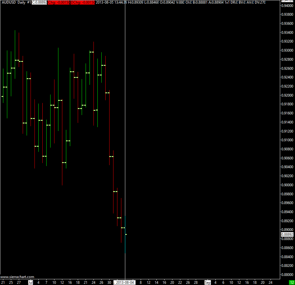

I'm having issues again today. This time its the historical/daily.
I've done a complete re-install today renaming the original SierraChart folder and then running the install file to install in a new SierraChart folder.
I've uploaded a complete message log file and attached a newly created chartbook that still has the problem.
Screenshot can be found at: http://www.sierrachart.com/image.php?l=1375706683687.png
In this example, SierraChart is displaying and updating in realtime under yesterdays date. Out of 28 currency pairs only GBPCAD & GBPNZD are showing todays date (5th).
This time selecting Edit -> 'Delete All Data And Download' doesn't fix the problem.
I do see the 'Downloading Historical Data' message in a yellow box followed by 'Historical Download Complete' in a green box when downloading both intraday & daily data for the relevant periods.
I'm going to try the pre-release and an older version now to see if they make any difference.
UPDATE: Versions 1005 & 996 display the same issue and this time all I've done to test is open a new chartbook and then use 'Find Symbol' to open a chart.

This is normal because the FXCM daily data starts on Sunday. They provide separate data for Sunday. This is explained in more detail here:
http://www.sierrachart.com/index.php?l=doc/FXCMTrading.php#HistoricalDailyBarData
