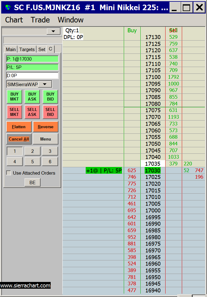

I use Sim is just to test the function before using it in live trade, but it seem doesn't work in sim mode. I use version 1468 atm.
Setting already apply, The screenshot is just to show what I have set. Thanks
imagetest.png / V - Attached On 2016-10-05 01:08:46 UTC - Size: 335.22 KB - 381 views

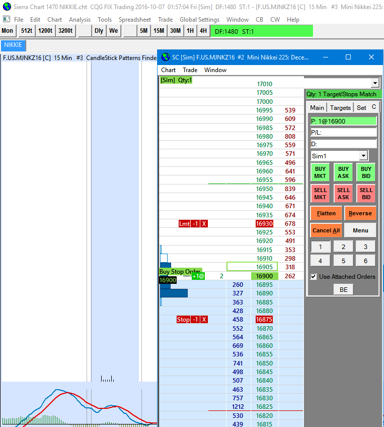

User810481 - Posts: 23
Unsure if you fixed in 1470 version, still threshold 300, still seem doesn't work in sim.
image2016-10-07_0927.png / V - Attached On 2016-10-06 23:58:07 UTC - Size: 70.81 KB - 337 views
[2016-10-06 23:59:59]
There is already have 1 long position, the order is to get the 2nd lot - for testing purposes.
[2016-10-07 04:44:26]
It should work based on what we see if the threshold is actually 300. We just did a test now and did not see a problem. Worked perfectly.
The change made is not relevant in this particular case because the ask quantity is well below the threshold.
Date Time Of Last Edit: 2016-10-07 04:45:03
