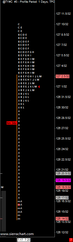

With the new Custom Sub Period on the TPO Study we can set the first 10 min bracket on the Notes.
This is really cool but it still can mislead its reading.
Looking at the image, on 7-17 we have the (m) period which is the 10 min bracket and then at 7:30 CT we initiated the (A) period.
Looking at it it seems there's a 2 period bracket on that price area where indeed that was not the case, this can mislead the profile reading.
So my idea would be to merge the first 10 min bracket with the (A) period. This would mean that the first bracket of the day would have 40 minutes instead of the standard 30 min but we would remove that (m) period and have a much better reading of the profile, without that 2 period bracket appearance.
http://www.sierrachart.com/image.php?l=1374161035835.png
Regards.

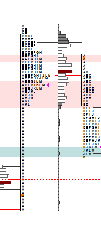

[2013-07-24 08:09:18]
trademechanics - Posts: 29
Please take a look at he following screenshot
http://www.screencast.com/t/g6wVhzAt5zS4
First chart with the 10 min sub period is gives the (A) period for those 10 min and the (B) period for the following 30 min.
But, using User24143 settings we can have indeed a 40 min initial bracket, by "merging" the initial 10 min with the following 30 min. The problem though it appears that sub period removes the (B) letter (not the period itself as I wrote on the chart). The period is there but with the letter (C).
Although setting a sub period that extends the (A) period till 8:00, the study continues to distribute the letters the same way, on 30 min intervals. That's why we can't see the (B) letter. Due to the opening at 7:20 (sorry, i've always used exchange time so it's easier for me to mention Chicago time), even though we set the sub period, the study continues to read that initial 10 min as (A), the following 30 min as (B) and finally at 8:00 it initiates (C).
The sub period should force the study to calculate the letter distribution differently. Yes, it continues to distribute the letter on 30 min intervals but always from that sub period onward.
So if the sub period is between 7:20 and 7:59:59, which is the (A) period, at 8:00 the study should start the (B) period, not the (C). From there the distribution would run as usual, 8:30 (C), 9:00 (D), 9:30 (E) and so on...
Of course theoretically it's easy to talk about this. If it's possible to code it, maintaining the integrity of all the other calculations that's another problem.
Date Time Of Last Edit: 2013-07-24 08:16:26

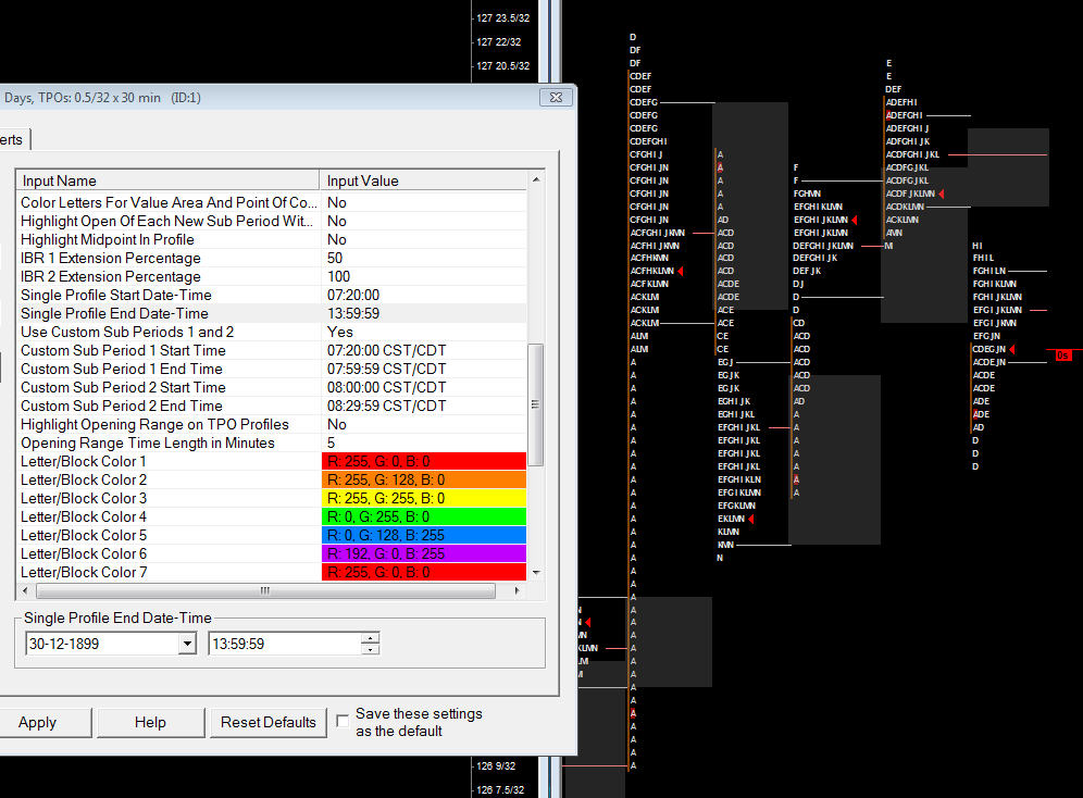

[2013-07-24 09:44:18]
Which version are you using?
I'm on 999.
I do not have a B period
image10min_bracket03.png / V - Attached On 2013-07-24 09:44:06 UTC - Size: 84.93 KB - 820 views

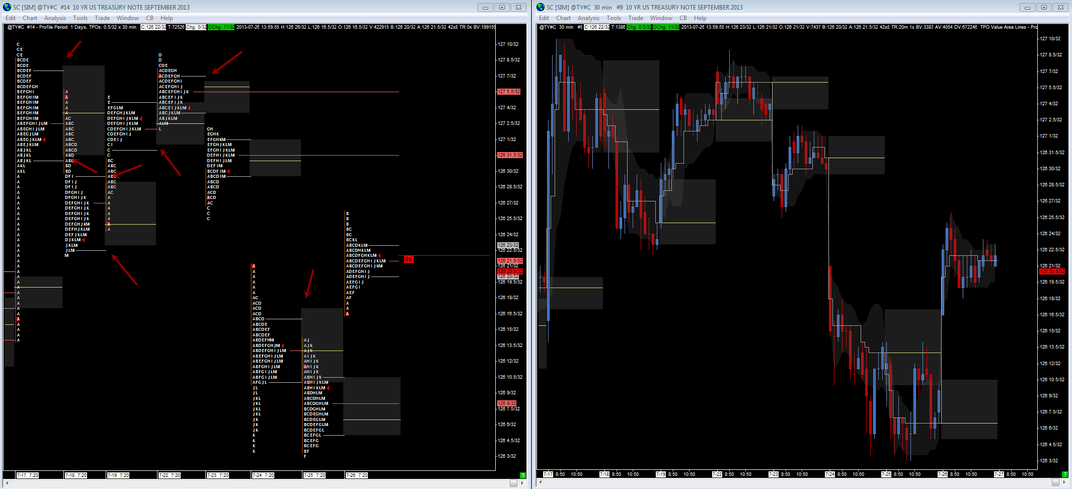

[2013-07-27 12:41:17]
I didn't know where to post this message since this is related to the TPO Value Area Study but since it's also related to the new merge option I decided to put it in here.
Please see attached image.
I'm overlaying on the TPO chart the TPO Value Area applied on the candle chart extending the previous day value area onto today's trading day.
As you can see, there's a couple of value areas and POCs that are out of sync with the previous days value area on the TPO chart.
Is it possible to fix this or since the calculations are based on a 30 min chart it's impossible to work with the "odd" open period?
EDIT: Just been working with a couple of charts and different time frames and if I set the candlestick to a 10 min periodicity, the same as the "odd" open period the value areas become in sync with the TPO.
Nice.
Thank you
Date Time Of Last Edit: 2013-07-27 16:29:19
imageTPO_overlayed.png / V - Attached On 2013-07-27 12:41:13 UTC - Size: 117.67 KB - 876 views

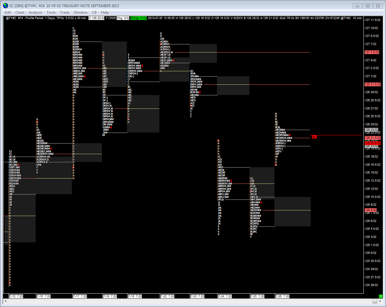

[2013-07-27 15:02:47]
If of interest, I made a request a few days ago about this here : TPO Value Area Lines problem when first period is diffrent
Yes, I saw that thread. Maybe I should have posted it there...
Anyway, like I said, the issue with the out of sync is resolved with a 10 min chart:
imageTPO_overlayed02.png / V - Attached On 2013-07-27 15:02:40 UTC - Size: 97.66 KB - 787 views
[2013-07-27 20:09:48]
Yes this is essential. Otherwise, it is not possible to do accurate calculations. You can also use 1 minute and 5 minutes.
