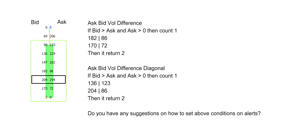

[2016-07-13 04:03:53]
User701247 - Posts: 117
Del ...
Date Time Of Last Edit: 2016-07-13 04:29:30
[2016-07-13 04:14:15]
We do not understand the question.
[2016-07-13 04:30:36]
Please see attached image, I would like to know on how to set conditions for alert.
Do you have any suggestions?
Thanks you very much for any suggestions
imageCounting.JPG / V - Attached On 2016-07-13 04:30:33 UTC - Size: 93.19 KB - 553 views
[2016-07-13 04:53:51]
We do not provide alert formula programming help.

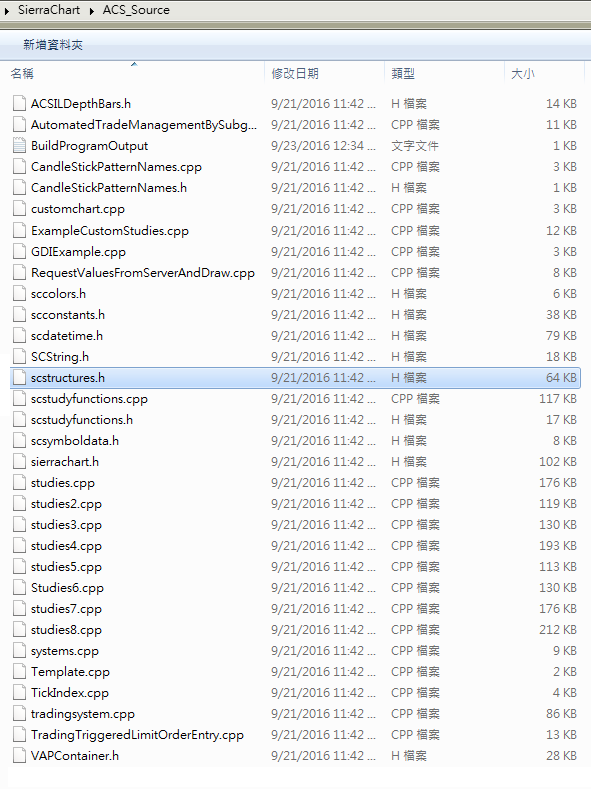

When I build custom studies DLL, I get following error "fatal error C1083" as shown below.
I have checked that the following both files are existed.
C:\Program Files (x86)\Microsoft Visual Studio 14.0\VC\vcvarsall.bat
c:\sierrachart\acs_source\scstructures.h
Do you have any suggestions on what wrong it is?
Thank you very much for any suggestions :>
-- Starting build of Custom Studies Source files: Sample.cpp. -- 06:37:18
C:\Windows\system32\cmd.exe /C "C:\SierraChart\ACS_Source\VisualCCompile.Bat"
C:\SierraChart\ACS_Source>call "C:\Program Files (x86)\Microsoft Visual Studio 14.0\VC\vcvarsall.bat"
Sample.cpp
c:\sierrachart\acs_source\scstructures.h(6): fatal error C1083: Cannot open include file: 'windows.h': No such file or directory
-- End of Build -- 06:37:20
Date Time Of Last Edit: 2016-09-23 04:36:07
[2016-09-23 04:07:21]
Do you notice this error when you compile the Template.cpp file?
[2016-09-23 04:19:17]
Go to Build Advance Custom Studies DLL
1) Select file(s) Template.cpp
2) Click Build Custom Studies DLL Button
3) and get following Build Output
Please see attached file, c:\sierrachart\acs_source\scstructures.h is existed
-- Starting build of Custom Studies Source files: Template.cpp. -- 12:34:20
Template.cpp
-- End of Build -- 12:34:24

imagescstructures.png / V - Attached On 2016-09-23 11:33:20 UTC - Size: 90.64 KB - 533 views

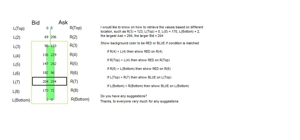

[2016-09-28 23:19:13]
In regards to post #19, we think you are going to have a difficult time using ACSIL to do what you want on your own due to lack of knowledge. We do not provide this kind of support that you are looking for.
It would be best that you describe what you want to do and we will give you a quotation to program it for you.
So tell us exactly what you want to do.
[2016-09-29 11:36:51]
Please see attached image for details
Date Time Of Last Edit: 2016-09-29 11:45:48
imageCounting2.JPG / V - Attached On 2016-09-29 11:45:46 UTC - Size: 68.8 KB - 531 views

[2016-10-10 00:16:32]
The key issue is how to retrieve the value based on different levels.
I am still waiting :>
