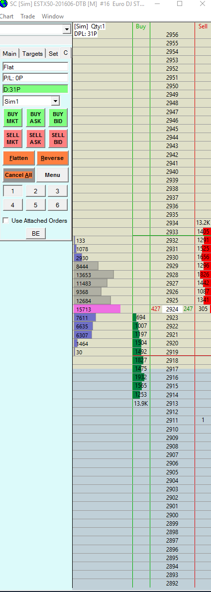

I am using version 1414 and the SC data feed. I noticed that the price and background (grey color) in the DOM are not matching up with each other. Even if I restart SC.
This affects only Eurex and here FESX and FDAX so far.
Please see the image attached.
imageDOM.PNG / V - Attached On 2016-05-20 07:18:17 UTC - Size: 36.53 KB - 478 views

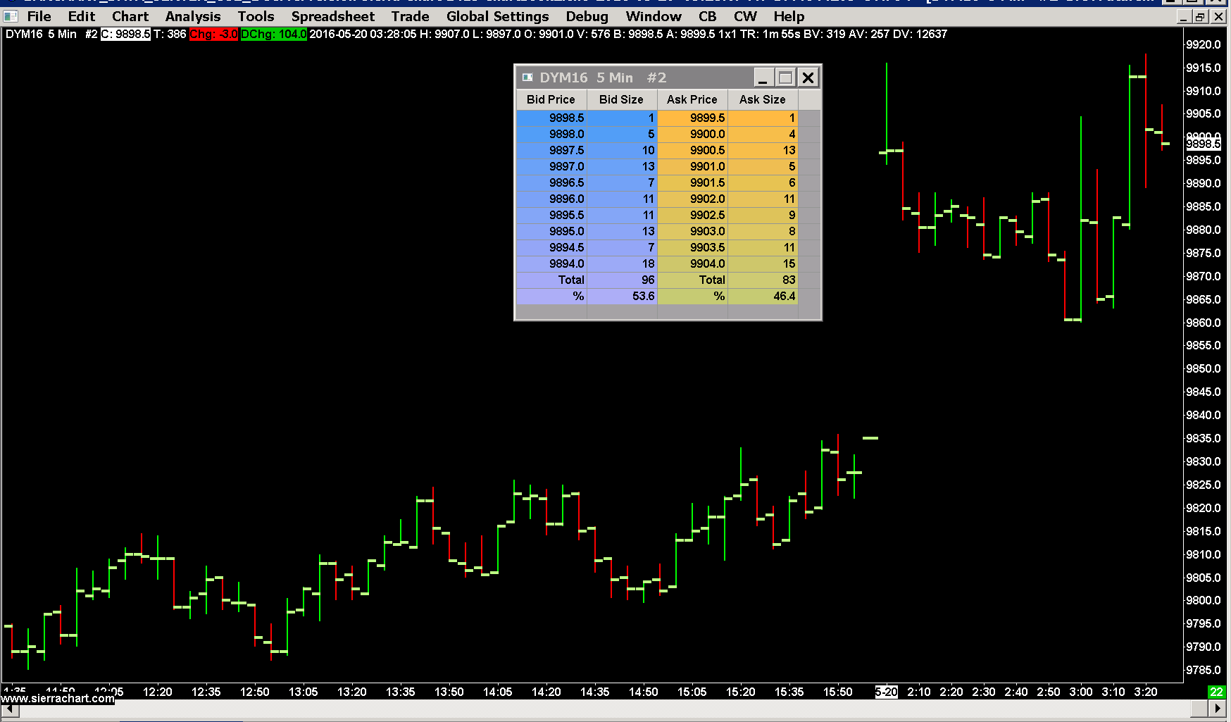

This is what we currently see for the DAX:
http://www.sierrachart.com/image.php?Image=1463729288172.png

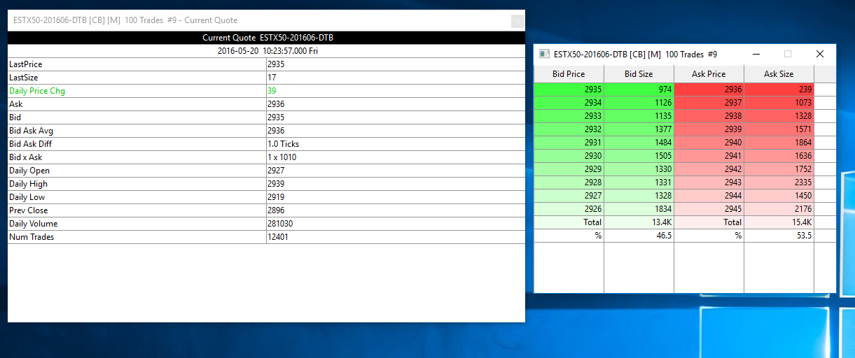

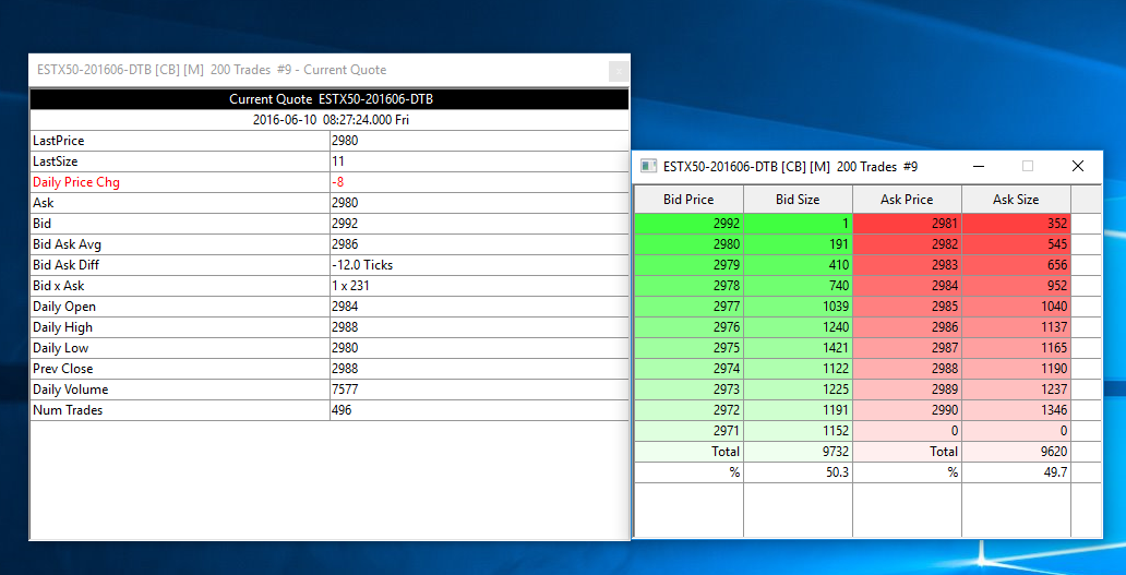

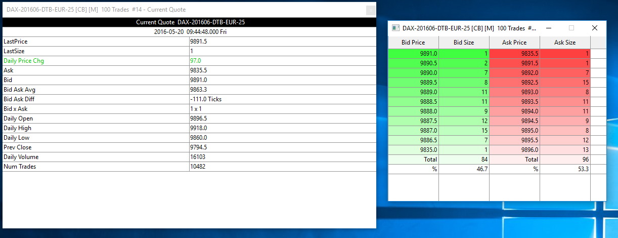

I have attached a screenshot from FESX and FDAX.
FESX has a Bid / Ask difference from 20 ticks and FDAX from 111 ticks in the quote window.
Date Time Of Last Edit: 2016-05-20 07:48:44
imageFESX.PNG / V - Attached On 2016-05-20 07:48:19 UTC - Size: 136.13 KB - 469 views
imageFDAX.PNG / V - Attached On 2016-05-20 07:48:23 UTC - Size: 125.4 KB - 351 views
[2016-05-20 07:57:43]
We are not seeing these incorrect values on the server. So this appears not to be a Barchart data problem.
There may be another cause that is related to the Interactive Brokers connection.
We are going to make a change to filter out these values if they are coming from TWS.
This will be out in the next release.

[2016-05-20 08:10:50]
We are reproducing a problem. This is not a Barchart data problem. It is something else. We are looking into it now. Very puzzling.

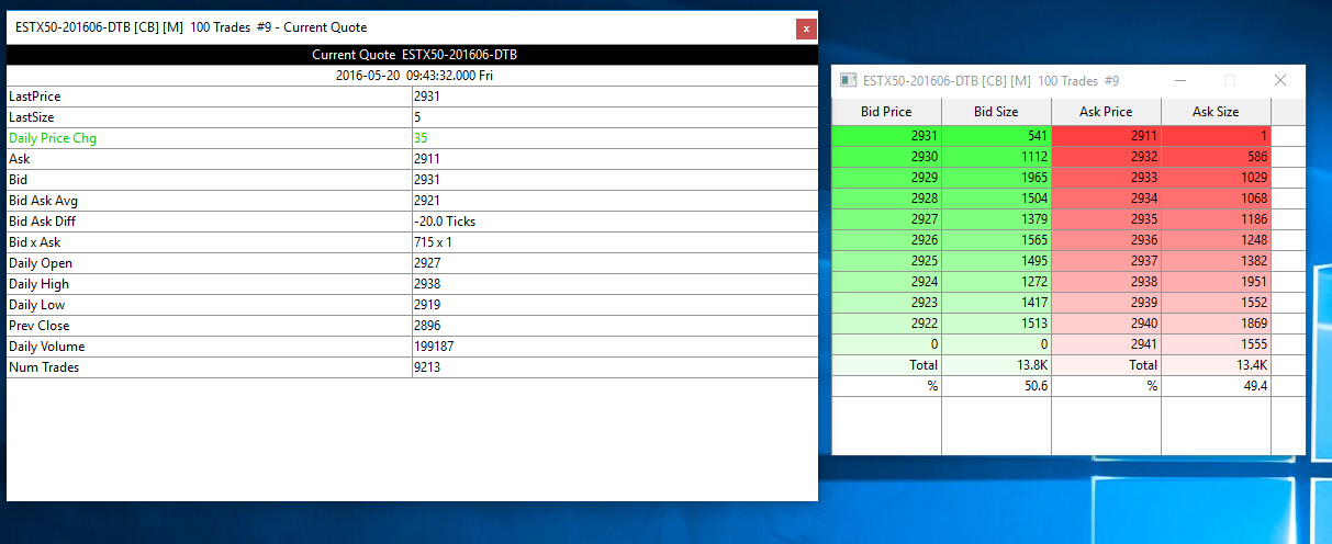

Futurestrader77 - Posts: 126
I assume that you just changed something, now it seems to work fine. Thank you.

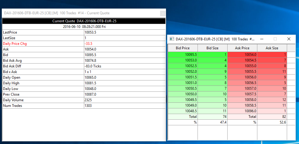

Dear Support Team,
I am having problems with the SC Data Feed on Eurex (FESX and FDAX, not the Bund) again. Please see the attachments.

[2016-06-10 06:53:01]
We are checking this now.

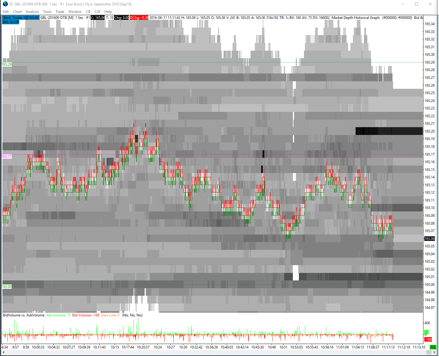

[2016-06-17 09:20:20]
Dear Support Team,
sometimes I am seeing gaps in the market depth on Eurex with the SC Data Feed. I have attached a picture showing the new historical market depth study where you can see a gap in the level 2 quotes at 10:52 CET in the Bund Futures.
Best regards.
imagelvl2.PNG / V - Attached On 2016-06-17 09:19:14 UTC - Size: 222.57 KB - 431 views
[2016-06-17 09:42:57]
It is impossible for us to know the cause of that from the chart. We must see the actual Market Depth window itself showing what appears to be the missing levels.

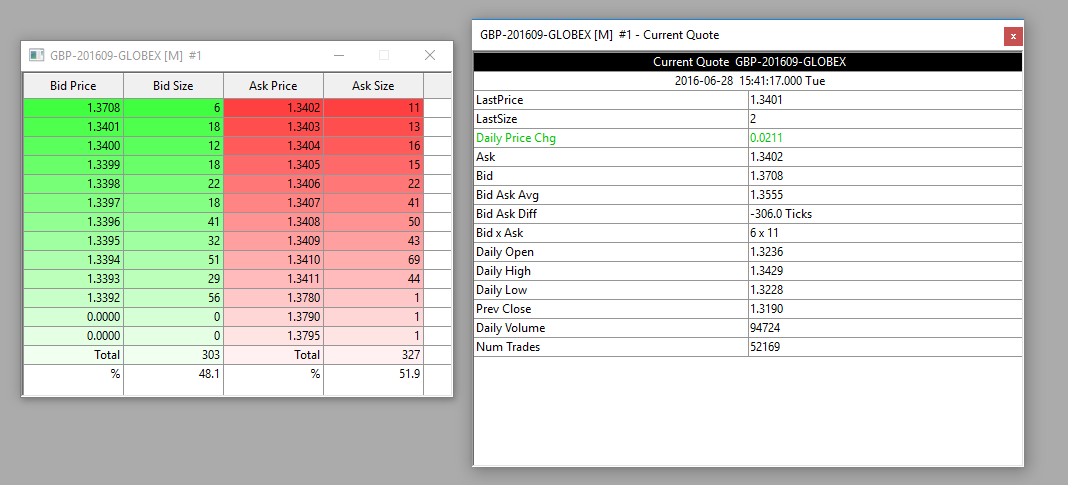

[2016-06-28 13:45:02]
I am seeing again this problem in the cable (GBP/USD), please see the image attached.
imageGBP.PNG / V - Attached On 2016-06-28 13:44:24 UTC - Size: 35.89 KB - 394 views
[2016-06-28 16:39:25]
The fact that you do not see this with EUREX shows that the problem has been solved for EUREX. And this gives us a good idea as to what the likely cause is.
We will solve this for the CME symbols as well. We have now temporarily solved it.
[2016-06-28 16:46:55]
If you still see out of order levels on the Market Depth window, reconnect to the data feed to switch to our other server.
