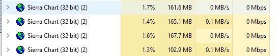

as an avid user of more data loaded charts , i have came to the conclusion that sierra just cant handle the cpu load of which im throwing at it , i have to have 4 instances open at one time to cover all the 4 markets i like to trade , i use 8 charts on each and have to sacrifice chart update interval to 1000 on each chart besides my entry chart to not have mouse lag or fast market lag, this is a little annoying having to do it this way .
this is ok for now but i would suggest you guys keep working on ways to speed up the charting cpu load as speed and data are key to alot of traders with newer tools and technology .
thanks for all ur help working to get this sorted and i love and will continue to use your software . but please keep working on it

So you have a total of 32 charts basically? That's not something that should require a 1s chart update interval. Here's how to diagnose this IMO:
Close a single chart, watch CPU, close the next chart, watch CPU, continue until you either find a single chart contributing to high CPU and/or you come to the conclusion there is no single chart that's contributing to it. Remove studies and strip everything down to just the minimum, but still have 32 charts up and see how that affects overall usage. Then add things back until you find the culprit, if any.

We see you are using various custom studies. Restart Sierra Chart and enable "ACS Safe Mode". Those can be the cause of the high CPU usage.
We also see what appears to be the same configured Volume by Price study twice on at least some of the charts. There should be just one of them especially in the case of TPO charts.
You are also using some User Contributed Studies. Remove all of those from the charts to see how much the CPU usage drops by.
At least one of those is definitely the source of high CPU usage.
This Chartbook runs at about 2 to 3% with a replay at a speed of 1 using tick by tick data. This is with the custom and user contributed studies removed. We assume no responsibility whatsoever for those studies. You should have also advised us of those. It is not our responsibility to be bothered with those.

Yea the double profile is cause I want out line and separate poc and value area levels on a button , which I have asked for but u said u had no interest in making , but I did take them off and no change as there just on vp
I will go over what u asked me to do and get back to u tomorrow , thanks for the help its a start

User20450 - Posts: 330
ok so it did lower me down some , for the one chart book but when i have 3 of them open i jump back up again to over 10% , and this is in safe mode
[2016-04-25 16:31:28]
Just to make absolutely certain you are on the latest release which will not load User Contributed Studies in safe mode, after the close, update Sierra Chart again with Help >> Download Prerelease.
