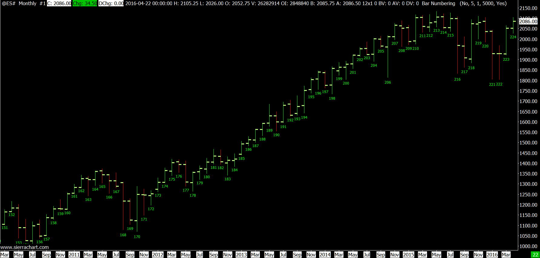

I find that when I try to load longer term charts, such as monthly, I only get about thirty bars of data. I have checked your help files but have been unable to find a solution to the problem.
Can you help?
thanks
peter

We see you are using IQFeed. Can you give us the symbol of one of these monthly charts, so we can give you the proper instructions.

My impression is that it happens on all longer term charts. The ones I have specifically tried are: ES, SPY, MSFT and TMV.
THANKS

In the case of stock charts, refer to this page:
No Historical Chart or Blank Chart | Historical Chart Not Updating | Missing Historical Chart Data
In the case of futures charts, you need to use the continuous futures contracts symbols from IQ Feed. For example use: @ES#

As a matter of fact, I did use the continuous contract (@ES#). If I'm not mistaken, SPY is the cash index, so a continuous contract would not be relevant.

There is no continuous futures contract symbol for SPY.
Go to one of the charts you are having a problem with and then re-download the data with Edit >> Delete All Data Download.
If there still is insufficient data, post a copy of the Message Log by following these instructions:

@ES# Weekly #2 | Reloading chart. | 2016-04-22 15:56:56
IQFeed | Using primary service for historical data for @ES# | 2016-04-22 15:56:56
@ES# Monthly #1 | Reloading chart. | 2016-04-22 15:56:56
SPY Monthly #11 | Reloading chart. | 2016-04-22 15:56:56

HD Request # 37 | Downloading Historical Daily chart data for @ES#. Starting date: 2016-04-20. Service: dtn | 2016-04-23 12:19:48
HD Request # 37 | Requesting 5 days of historical daily data. RequestID: 36 | 2016-04-23 12:19:48
HD Request # 37 | Receiving Daily data for @ES# | 2016-04-23 12:19:49
HD Request # 37 | Receiving historical Daily data for @ES# starting at 2016-04-20 | 2016-04-23 12:19:49
HD Request # 37 | Writing historical Daily data to the file @ES#.dly | 2016-04-23 12:19:49
HD Request # 37 | Received 5 records from 2016-04-20 00:00:00 to 2016-04-22 00:00:00 (3.0 days) and wrote 3 records for @ES# | 2016-04-23 12:19:49
HD Request # 37 | Daily download COMPLETE for @ES#. Completion time: 0s. Unique request ID: 36 | 2016-04-23 12:19:49
Removed historical data download ID 36 | 2016-04-23 12:19:49
@ES# Monthly #1 | Reloading chart. | 2016-04-23 12:19:49
IQFeed | Using primary service for historical data for @ES# | 2016-04-23 12:19:49
@ES# Weekly #2 | Reloading chart. | 2016-04-23 12:19:49
IQFeed | Using primary service for historical data for @ES# | 2016-04-23 14:10:13
HD Request # 38 | Downloading Historical Daily chart data for @ES#. Starting date: 1966-04-24. Service: dtn | 2016-04-23 14:10:13
HD Request # 38 | Requesting 18263 days of historical daily data. RequestID: 37 | 2016-04-23 14:10:13
HD Request # 38 | Receiving Daily data for @ES# | 2016-04-23 14:10:14
HD Request # 38 | Receiving historical Daily data for @ES# starting at 1997-09-09 | 2016-04-23 14:10:14
HD Request # 38 | Writing historical Daily data to the file @ES#.dly | 2016-04-23 14:10:14
HD Request # 38 | Received 4722 records from 1997-09-09 00:00:00 to 2016-04-22 00:00:00 (18.6 years) and wrote 4722 records for @ES# | 2016-04-23 14:10:14
HD Request # 38 | Daily download COMPLETE for @ES#. Completion time: 1s. Unique request ID: 37 | 2016-04-23 14:10:14
Removed historical data download ID 37 | 2016-04-23 14:10:14
@ES# Monthly #1 | Reloading chart. | 2016-04-23 14:10:14
IQFeed | Using primary service for historical data for @ES# | 2016-04-23 14:10:14
@ES# Weekly #2 | Reloading chart. | 2016-04-23 14:10:14
@ES# Monthly #1 | Reloading chart. | 2016-04-23 14:10:50
IQFeed | Using primary service for historical data for @ES# | 2016-04-23 14:10:50
IQFeed | Using primary service for historical data for @ES# | 2016-04-23 14:11:04
HD Request # 39 | Downloading Historical Daily chart data for @ES#. Starting date: 1966-04-24. Service: dtn | 2016-04-23 14:11:04
HD Request # 39 | Requesting 18263 days of historical daily data. RequestID: 38 | 2016-04-23 14:11:04
HD Request # 39 | Receiving Daily data for @ES# | 2016-04-23 14:11:05
HD Request # 39 | Receiving historical Daily data for @ES# starting at 1997-09-09 | 2016-04-23 14:11:05
HD Request # 39 | Writing historical Daily data to the file @ES#.dly | 2016-04-23 14:11:05
HD Request # 39 | Received 4722 records from 1997-09-09 00:00:00 to 2016-04-22 00:00:00 (18.6 years) and wrote 4722 records for @ES# | 2016-04-23 14:11:05
HD Request # 39 | Daily download COMPLETE for @ES#. Completion time: 0s. Unique request ID: 38 | 2016-04-23 14:11:05
Removed historical data download ID 38 | 2016-04-23 14:11:05
@ES# Monthly #1 | Reloading chart. | 2016-04-23 14:11:05
IQFeed | Using primary service for historical data for @ES# | 2016-04-23 14:11:05

In the case of a monthly chart, since the ES futures data starts in 1997 there will only be 224 bars:
http://www.sierrachart.com/image.php?Image=1461532047499.png
This contract did not exist before then.
