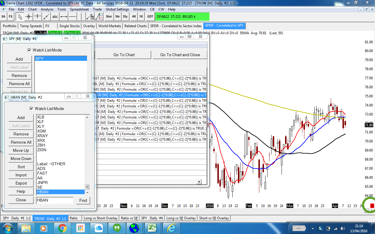

I am confused about what is being returned TRUE for the Stock scanning Alert formula I have:
=OR(C<=(C[-1]*0.98),C<=(C[-2]*0.98))
I want the list of stocks (in Associated Watchlist) to download the latest prices (I do this towards the end of the day), and get a list of stocks where the "last" price (on download ie TODAYS Last price) is 2% lower than previous day close or 2% lower than previous-previous day close.
When the scan run and it detects where the condition is true, for some reason, it selects stocks where it is true but not for the latest price. do i need to have something selected so that it only runs the condition for the last bar?
"Subscribe RT data & Download historical data during Scan" is selected in settings.
imageError.png / V - Attached On 2016-04-13 20:20:51 UTC - Size: 200.83 KB - 382 views

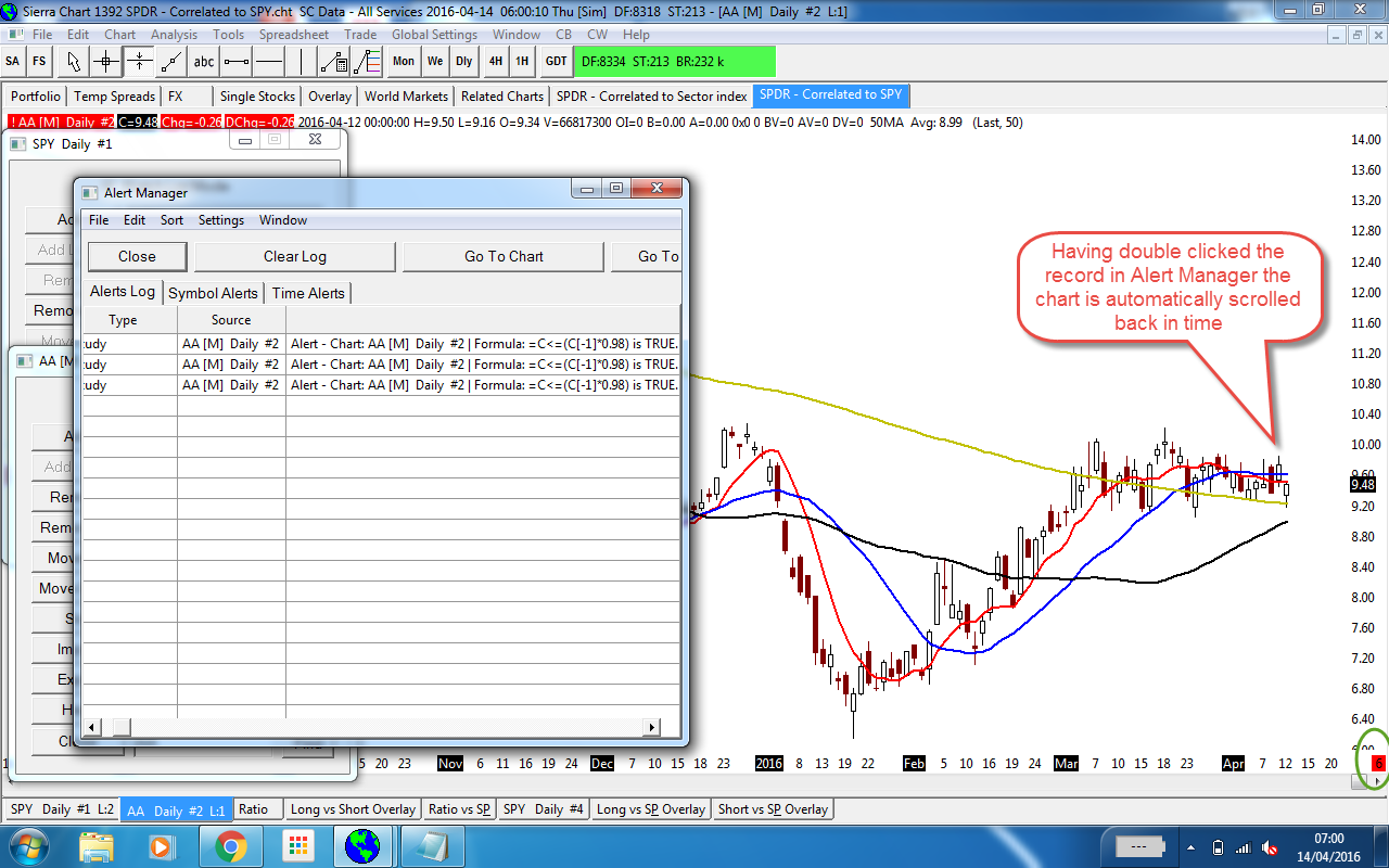

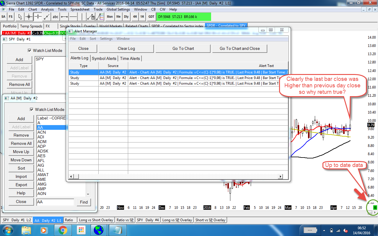

But, even
C<=(C[-1]*0.98)
returns true for the attcahed chart.
Alert - Chart: AA [M] Daily #2 | Formula: =C<=(C[-1]*0.98) is TRUE. | Last Price: 9.48 | Bar Start Time: 2016-04-12 00:00:00 | Alert: AlertSound (1)
I fail to see how this isn't a bug at the moment if the Alert is based on the last price in the chart.
I am happy to address any mis-logic in my alert but I am struggling to see that right now and the logic should be trivial.
The evaluation of the Alert Formula is always on the last bar.
In the Alerts Window when I double click the record to take me to the chart it takes me to the time period when the condition is true so doenst appear to work from the "last" bar in th chart
imageError detail.png / V - Attached On 2016-04-14 05:57:08 UTC - Size: 197.59 KB - 451 views
imageError detail 2.png / V - Attached On 2016-04-14 06:01:55 UTC - Size: 188.73 KB - 453 views
[2016-04-14 06:07:00]
CarlRostron - Posts: 80
Just tested this:
C<=C[-1]
and this does the same. It is not working off the latest bar i have downloaded so returns true unexpectedly.
[2016-04-14 06:16:33]
Also
C<O
is only true for the data for the penultimate bar, not the last bar in the chart as I would have expected.
[2016-04-14 08:08:22]
We do not think there is a problem here. And also apparently you did not take note of all of the information in post #2. Maybe when you read that post all of the information was not there.
We need some time to prepare documentation to explain how all of this works. There is one potential problem that we do need to address but it does not appear to be relevant in this particular case.
This is what we want you to do:
-Restart Sierra Chart.
-Run the scan for all your symbols on a Historical Daily chart.
-Select Window >> Alerts Manager >> Alerts Log >> Clear Log.
-Run the scan again.
At this point in time, the scan will only be on the most recent bar since no download will have occurred during the second scan.
When a download occurs, there will be two evaluations: On what is the last bar in the chart before the download, and the new last bar after the download.
Date Time Of Last Edit: 2016-04-14 08:30:38
