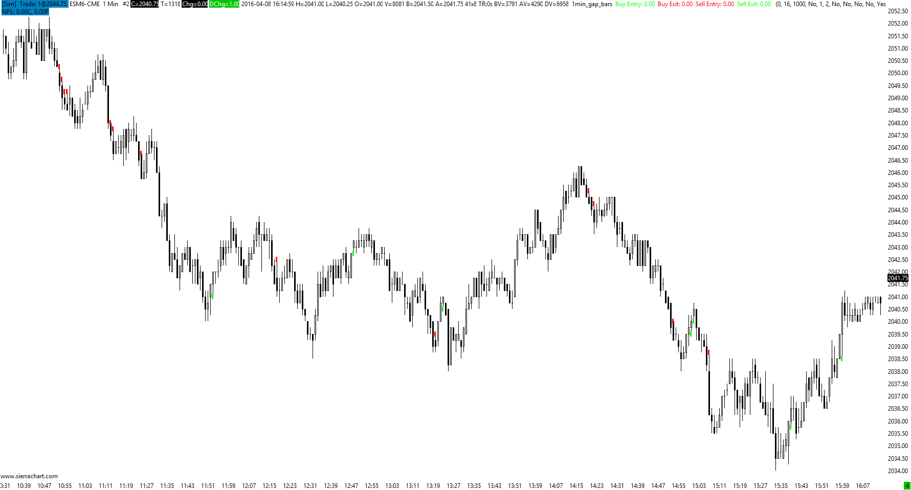

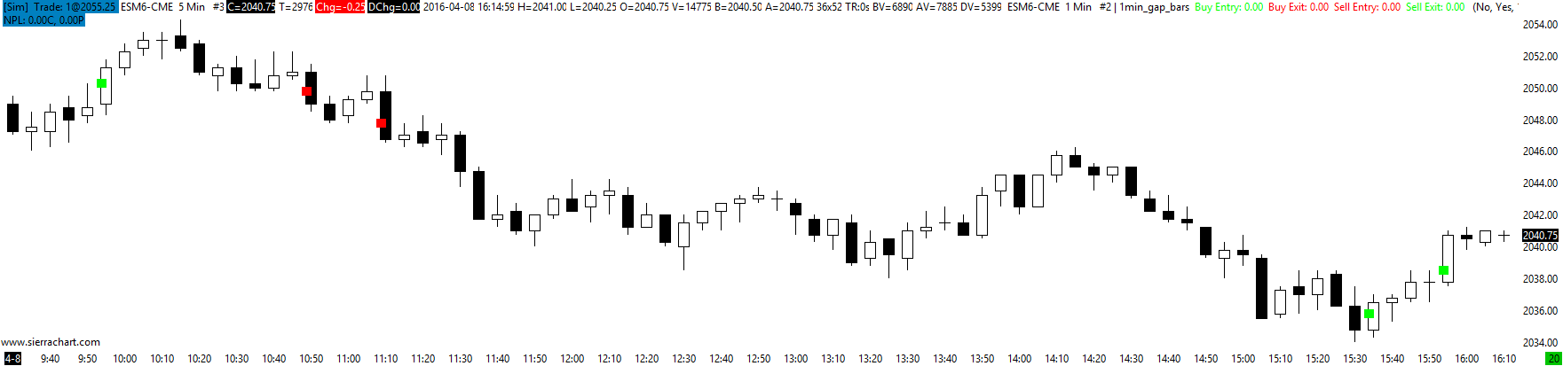

I have inserted a Study/Price Overlay onto a 5 min chart where the source study is a spreadsheet system/study with buy and sell formulas for a 1 min chart.
The 1 minute chart displays all of the alerts as expected but I expect to see them all using the overlay in the 5 minute chart too but I only see some of them. I have tried every combination of input settings and none of them show all of the 1 minute alerts in the 5 minute chart.
Please find the screenshot attached. The 1 minute chart has 14 red hashes visible and only 2 on the 5 minute. There are 7 green visible on the 1 min and only 2 on the 5 min.
http://www.sierrachart.com/image.php?Image=1460328057492.png
EDIT - It looks like the 1 minute didn't come over. It was tiled. Here it is standalone.
http://www.sierrachart.com/image.php?Image=1460329505193.png
When I replay the chart for all charts in the chartbook, the signals DO show up on the 5 minute but then some vanish from the 5 min yet still are seen on the 1 min.
Both of the charts have the same session times from the chart settings.

The Study/Price Overlay study will not do what you want.
Obviously there are 5 1-minute bars to every 5-minute bar so they cannot all be overlaid.
Have a look at using the Study Overlay-OHLC study:
https://www.sierrachart.com/index.php?page=doc/doc_TechnicalStudiesReference.html#s149
That study is not really designed for this purpose but it might accomplish what you want if it is displayed in another Chart Region other than Chart Region 1.
