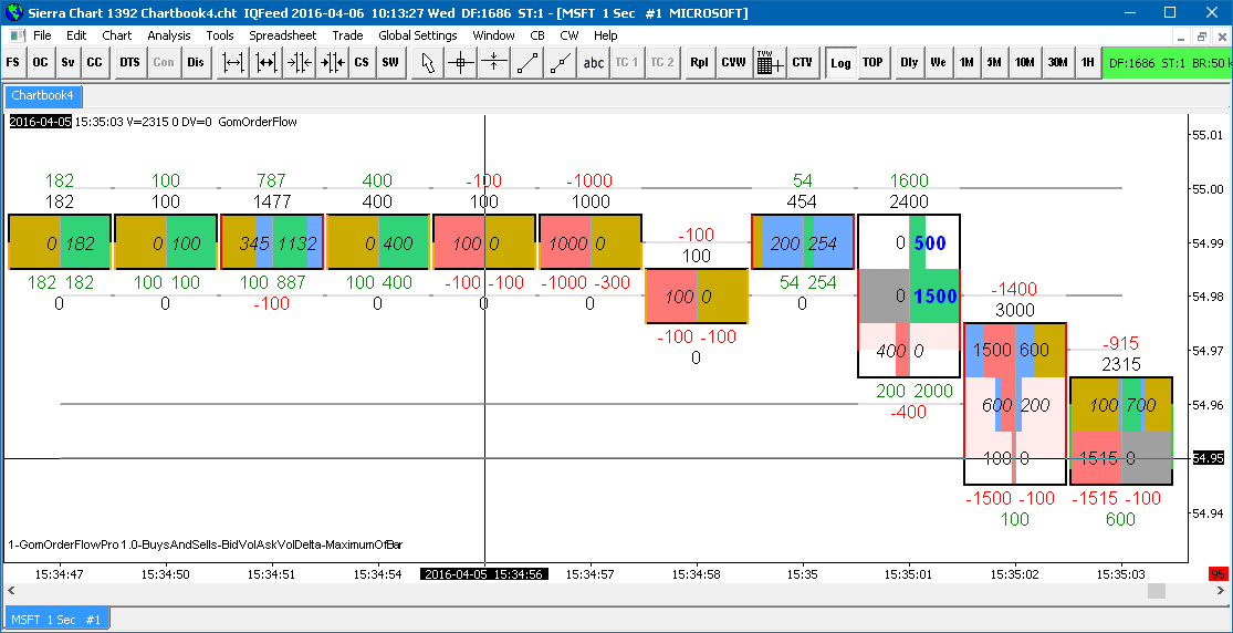

Here's a couple executions on MSFT, you see they're executed between the best bid and ask.
However sierra always reports them as sells
Wouldn't it be more appropriate the split the volume on the buy and sell sides ?

[2016-04-06 19:01:53]
How this works is documented here:
Numbers Bars: Definitions
We would not split the volume. Also, the trade must have occurred either at the bid or the ask, but the problem is it is hard to determine which one if it cannot be directly matched to either based on the bid and ask prices at the time.

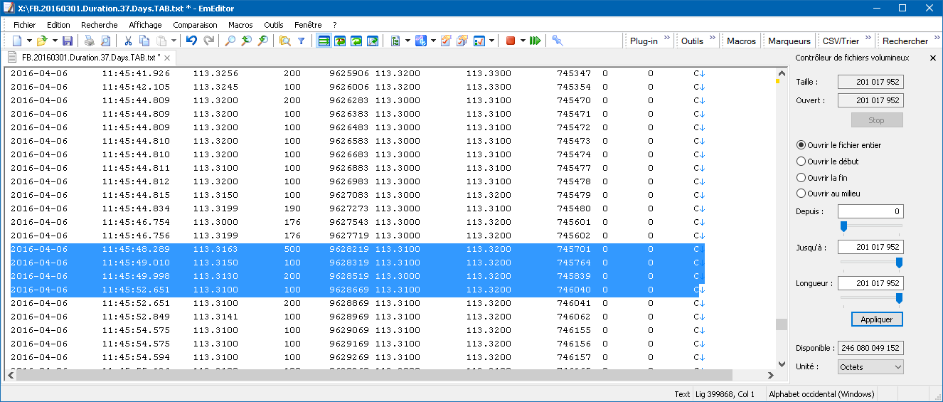

OK so I'm running a couple of tests, here's a case, Facebook, yesterday, 11:45:49.998 , price 113.3130
Datasource IQ
Execution is between bid/ask, price went down (113.3150 to 113.3130), bid went down (113.31 to 113.30)
According to the rule "3. The trade occurred between the Bid and the Ask and the Trade direction is a downtick and the Bid direction is a downtick.", shouldn't it be considered a downtick ?
However sierra reports an uptick (see pic)

[2016-04-07 08:50:17]
Was this from data collected in real time from IQ Feed because that does make a difference.
The implementation of this for historical IQ Feed data is different.
Also what time zone is this?
[2016-04-07 08:55:17]
gomifromparis - Posts: 244
no it's not real time, this is a IQ historical download using the API
File is NY time so 11:45, the sierra chart pic I posted is Paris time hence the 17:45 timestamp
The tick I mentioned 11:45:49.998 is NY time.
[2016-04-07 09:10:37]
OK that explains it. Those rules do not apply.
We can fix that. We will get it done.
