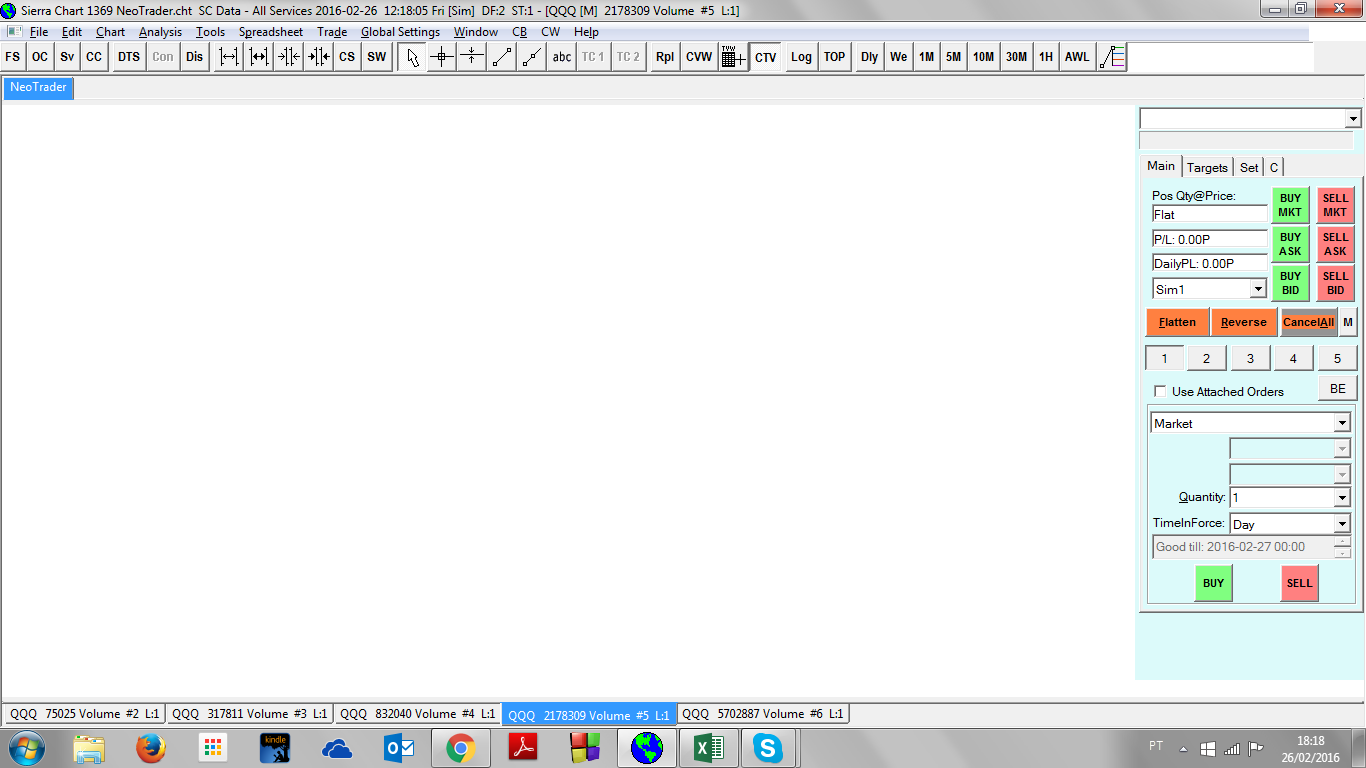

As we talked about, the problem has just started, so I´m informing you to do the Remote Assistance. The charts disappeared and in their place, appeared only a white space. I took a print screen from it, just in case. Here´s the print. CPU usage is currently at 25%.
Date Time Of Last Edit: 2016-02-26 14:17:11

NeoTrader86 - Posts: 32

Another time, it just went blank again. Took another Print Screen. CPU Usage Again at 25%.
imageCPU Usage.png / V - Attached On 2016-02-26 17:18:51 UTC - Size: 146.22 KB - 441 views
imageSierraProblemSecondTime.png / V - Attached On 2016-02-26 17:19:02 UTC - Size: 87.62 KB - 448 views
And now it´s back again by it´s own. CPU usage 1%.
