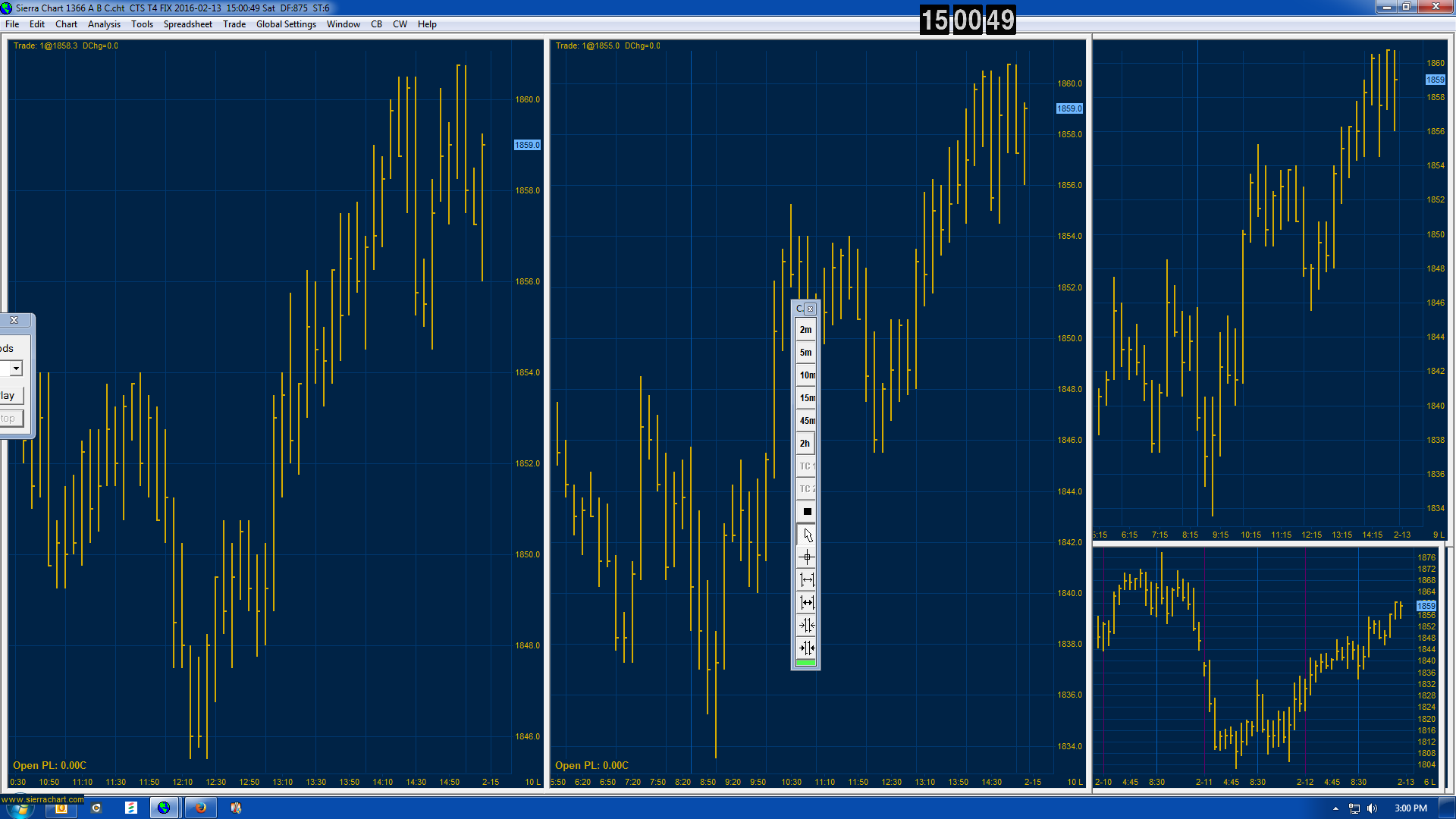

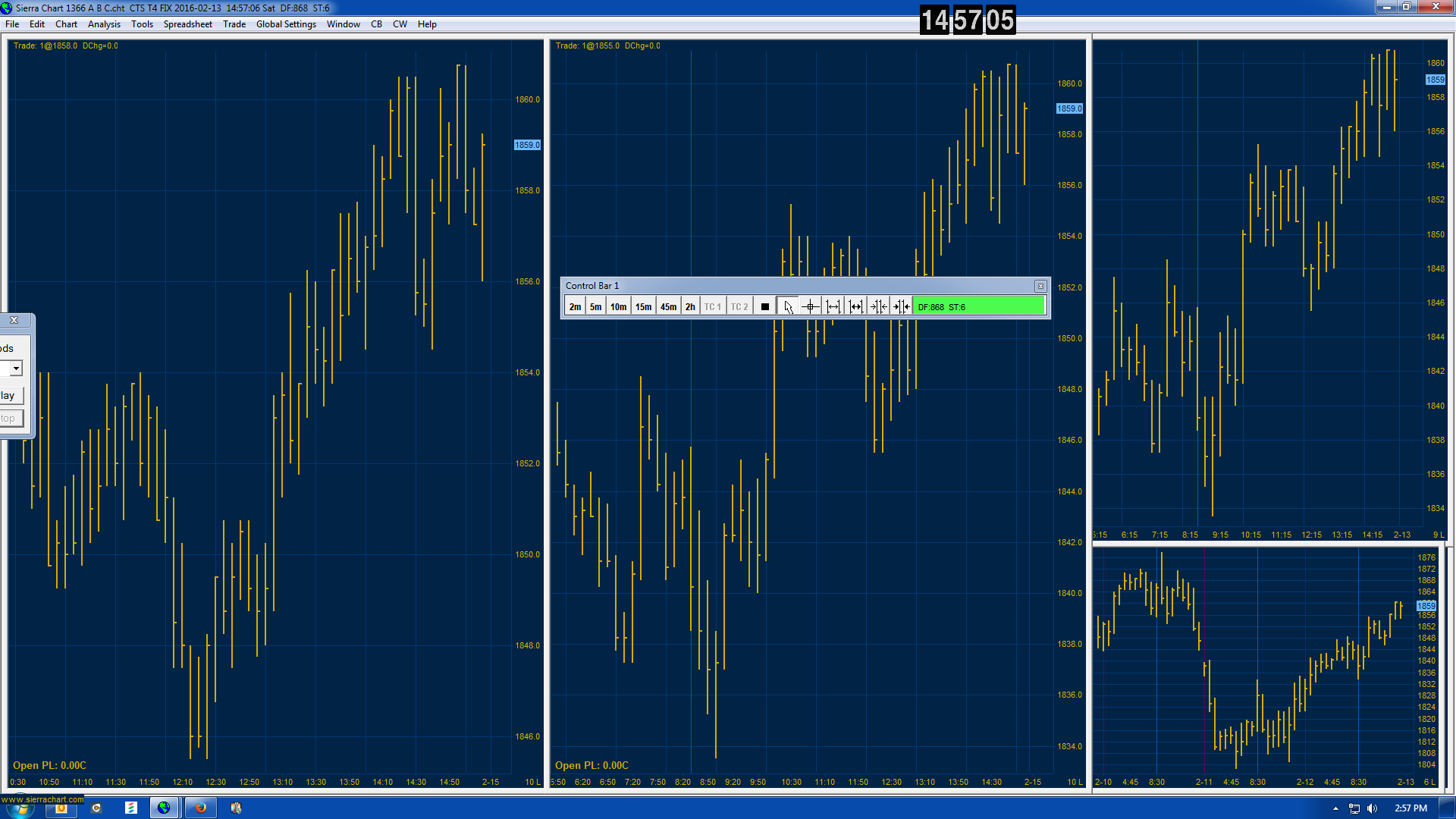

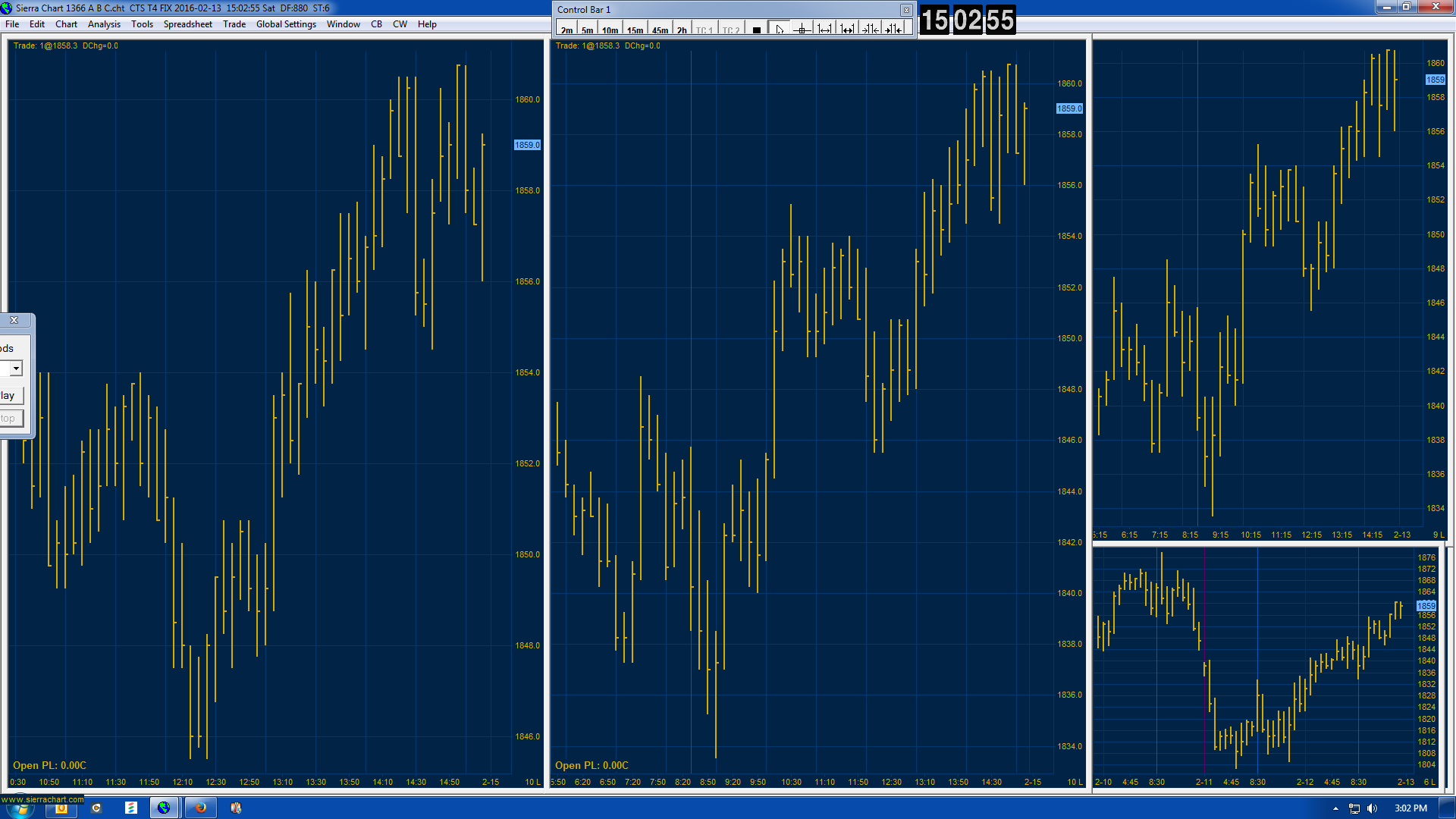

For the longest time I've been using a vertical control bar and the green status bar was located at the bottom of the control bar, a little sliver of green, just enough to see it. I've recently switched to a horizontal control bar and now I am unable to get the "little" sliver of green at the end of the control bar, it's either the full width of the status bar (in my case that's 3 inches) or nothing (when the control bar border comes into contact with the green the green immediately drops to the lower level). Is it possible to have a little sliver of green at the end of a horizontal control bar, or is it all or nothing?

The 3rd screenshot is the normal location of my toolbar, the empty space within the control bar at the right border is where I want my sliver of green to be.

What you see is normal because it has to do with how the control bar items are arranged on a horizontal floating control bar.
You need to open another Control Bar, set it to only have a Status Bar, and you can size and position it as needed.
