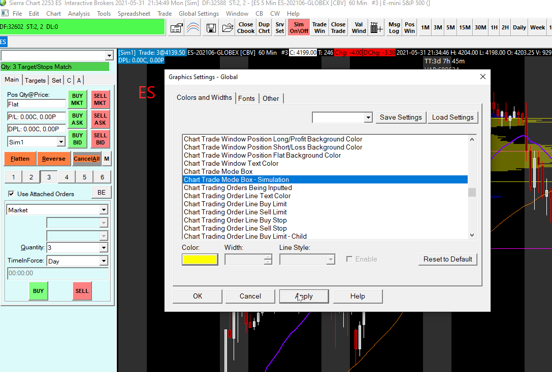

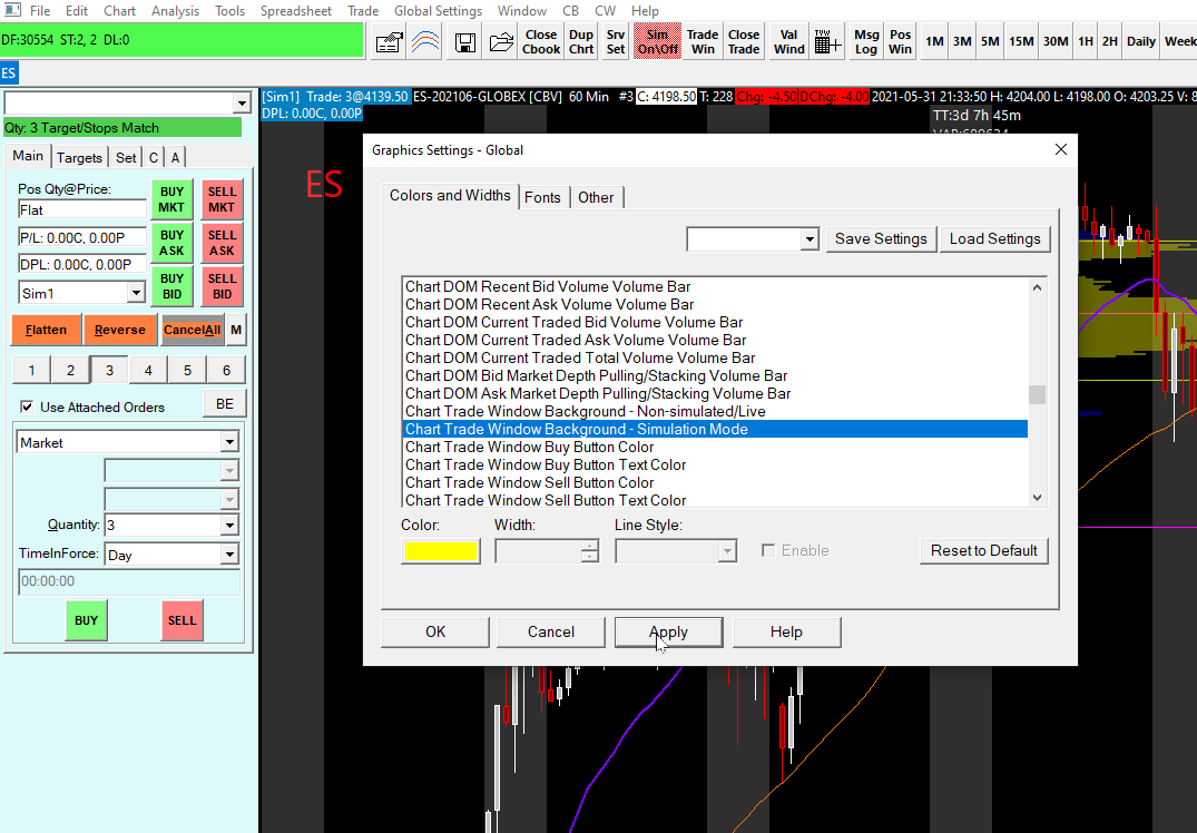

Atmos37 - Posts: 11
See screenshots. Changing the Graphics Settings - Global. Im used to yellow as sim from TOS/Etrade.
Thank you
image2021-05-31_21-34-01.png / V - Attached On 2021-06-01 04:17:53 UTC - Size: 82.39 KB - 389 views
image2021-05-31_21-35-08.png / V - Attached On 2021-06-01 04:17:58 UTC - Size: 82.8 KB - 381 views

Regarding the Chart Trade Mode box, make sure you are using the correct Graphics Settings window. There are two of them:
Graphics Settings: Introduction
Regarding the Trade Window Background color, you do have to close and reopen the trade window to see that color change.
