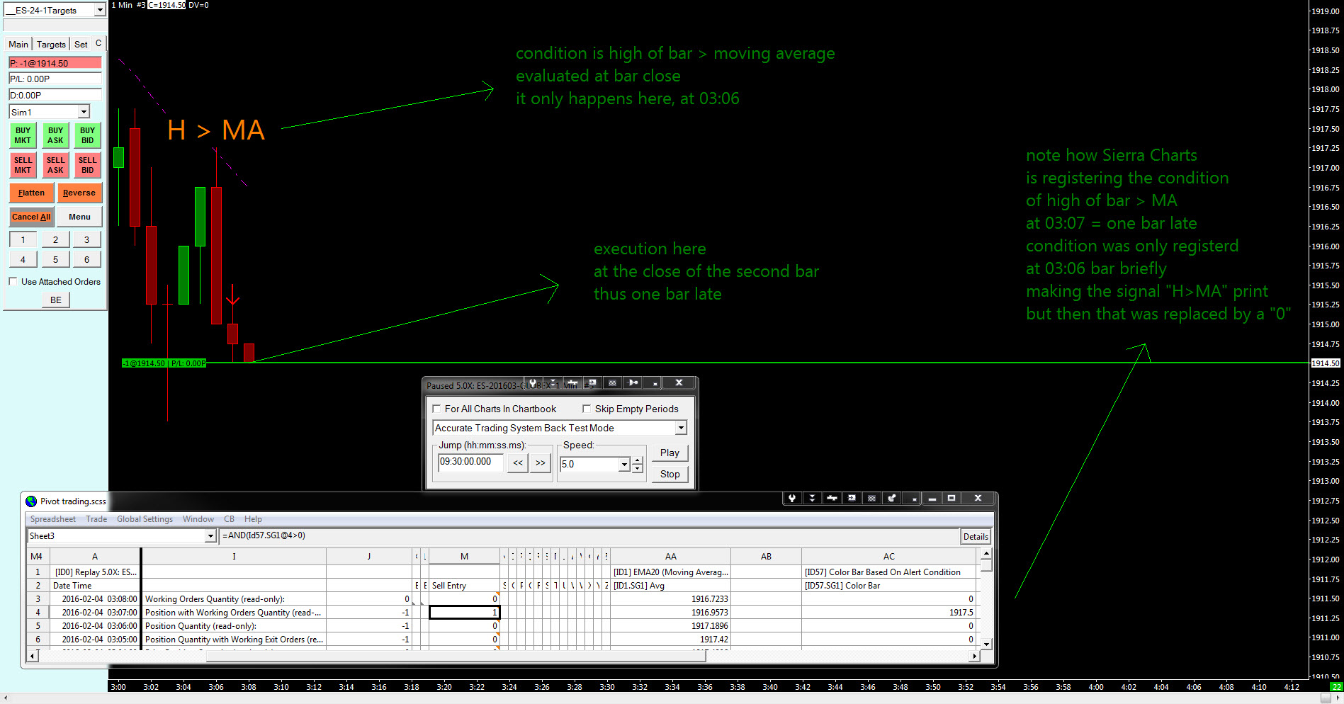

There are no assumptions here. The issue/behavior I described happens with the most simple conditions that leave absolutely no room for doubt, such as the "High of a bar being greater than a moving average". At the moment a cell is evaluated on bar close, Sierra Charts records a condition that is true (i.e. High of a bar being greater than a moving average) only as true at bar close, briefly, then replaces the true condition for a 0 immediately, and then re-registers the condition as true at the close of the following bar. Once the High of a bar is greater than X, it is greater than X permanently. Thus, the condition should remain recorded as true permanently. The condition should not appear and disappear. This results in trade execution two bars after the signal took place, instead of at bar close. This is basic Sierra Charts functionality. No coding here. Signals are not properly recorded when true. Or to be more precise, signals are recorded when true only briefly, and then recorded as true one bar late. Why does this happen? What is the solution?
I am attaching a screenshot and a seconds long video showing a replay with the example of "High of a bar being greater than a moving average". Both the screenshot and the video show the problem very clearly. Can also attach a bare bones chart if needed.
I need support with basic Sierra Charts functionality regarding unexpected behavior of true/false conditions that do not register correctly. We are not Troubleshooting Automated Trading System Behavior.
imageScreenshot.jpg / V - Attached On 2016-02-06 00:30:49 UTC - Size: 444.69 KB - 725 views

I truly do not care why Sierra Charts does not register signals correctly (as shown above).
What I need to know is how to get a TRUE condition to execute a trade at the open of the subsequent bar.
My experience is Sierra Chart, after a TRUE condition, executes trades at the open of two subsequent bars (if using "evaluate on close" or "signal only on bar close" or referencing manually row @4) or at the moment the condition is registered before bar close (if not using bar on close). As shown above this is for any signal Sierra produces, even one based on a condition as simple as "High of bar > X". I can't find the in between. I need the in between. Is this asking too much?

The video you provided stops at 22 seconds. But it appears to be longer than that.
What you are doing does raises some questions to us of things we need to look into and we are examining that.
There is also a potential precedence issue. Your Color Bar study must be above the Spreadsheet Study in the list of studies.

[2016-02-06 18:20:10]
rhovega - Posts: 279
Moving the Spreadsheet Study to the bottom of the list of studies solved the problem. Before the studies order was 1. Trading System. 2. Moving Average 3. Color Bar. After moving the Trading System below signals record properly, and trade execution using bar on close takes place at the open of the bar following signal. All good. Thanks. You may want to make a note of this in your Spreadsheet system / Trading system documentation.
