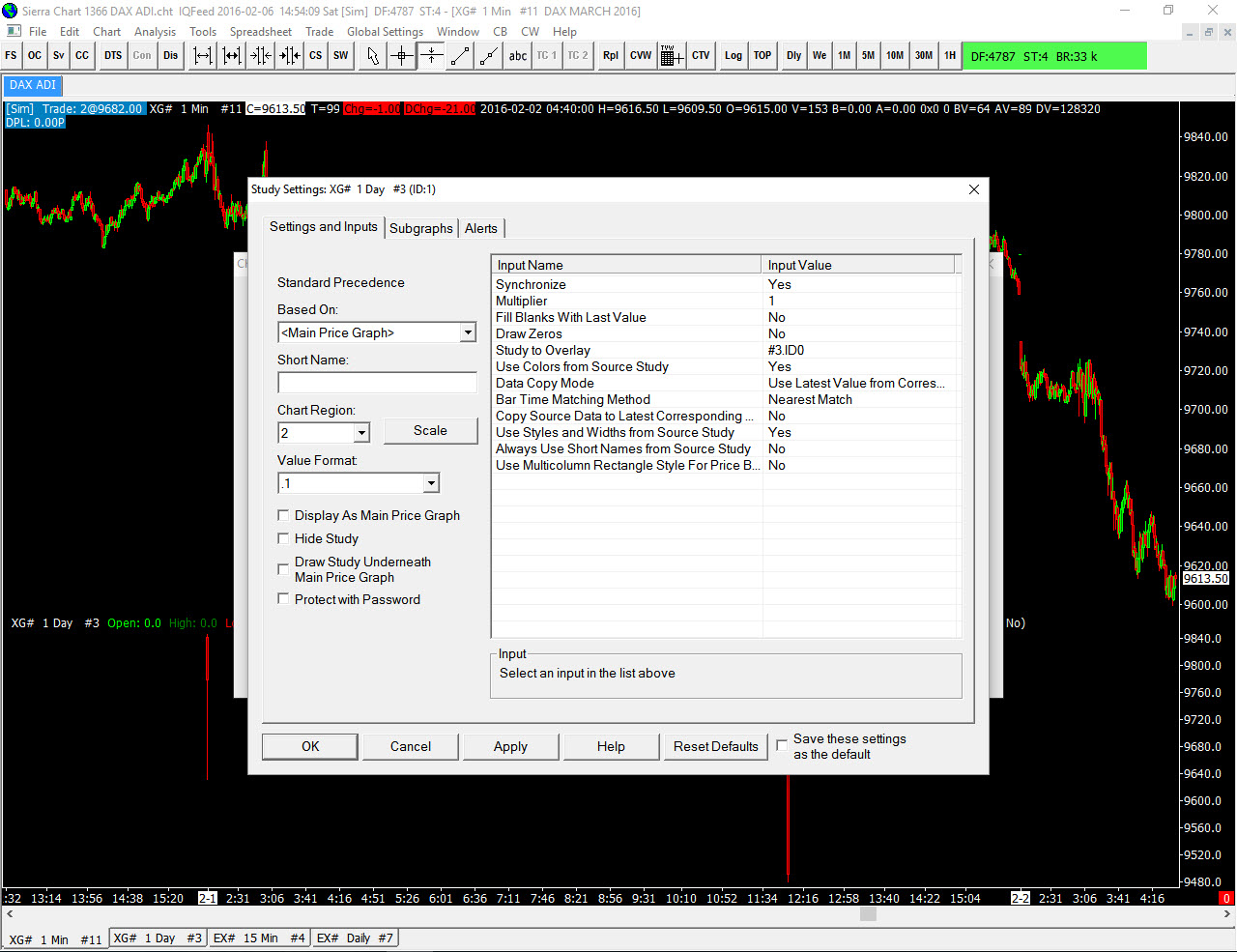

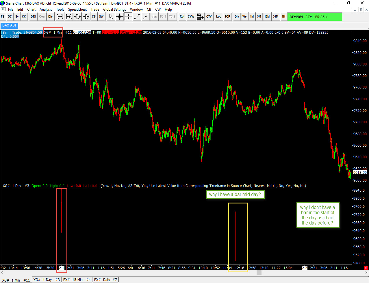

[2016-02-06 20:01:24]
User61576 - Posts: 458
1. as part of the code i wanted to use the perior daily close as a parameter.
i understood that i will need to use the overlay indicator and read this http://www.sierrachart.com/index.php?page=doc/doc_StudyPriceOverlayStudy.php
when applying it over my 1min chart, i have an issue that the daily data is not showed on the same time of the day. i would expect it to be on the first 1 of the day
i am attaching my settings of the study and my result of the chart
2. later, in my code i will refer to the close of the day before if to go long or short (if close[-1] > open [-1] than buy
after reading the guide here http://www.sierrachart.com/index.php?page=doc/doc_ACSILRefOtherTimeFrames.php
i am still don't understand how to make a simple calc of close vs open as the example is more confuing.
do i need to add this line
SCInputRef DailyClose = sc.Input[7];
to the head of the script? that's how i manually set parameters from the settings box ?
SCFloatArray Study1Array;
sc.GetStudyArrayUsingID(Study1.GetStudyID(),Study1Subgraph.GetSubgraphIndex(),Study1Array);
how do i get close and open from the study overlay?
bottom line after putting a lot of time reding again and again, i still don't understand ho to use this in ACSIL.
thanks for clearing this for me!
Date Time Of Last Edit: 2016-02-06 21:11:43
imageoverlay problem.jpg / V - Attached On 2016-02-06 19:57:39 UTC - Size: 315.38 KB - 664 views
imageoverlay settings.jpg / V - Attached On 2016-02-06 19:57:49 UTC - Size: 349.81 KB - 546 views

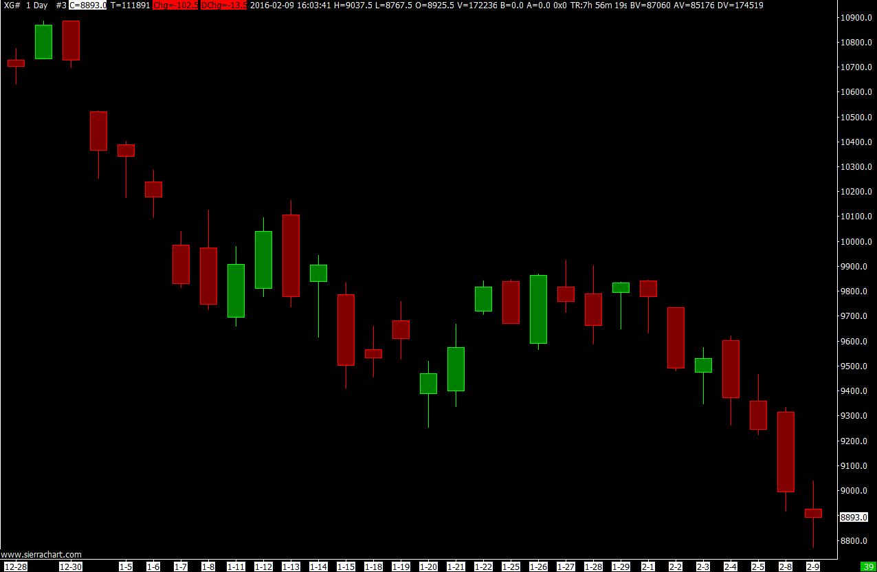

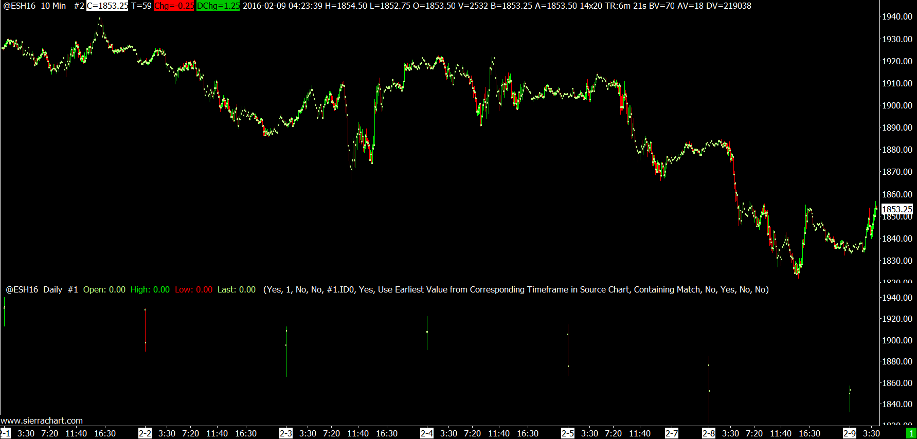

[2016-02-09 10:38:39]
Here is a chart image showing overlaying Daily bars on an Intraday chart:
http://www.sierrachart.com/image.php?l=1455009822290.png
It shows all of the Input settings being used.

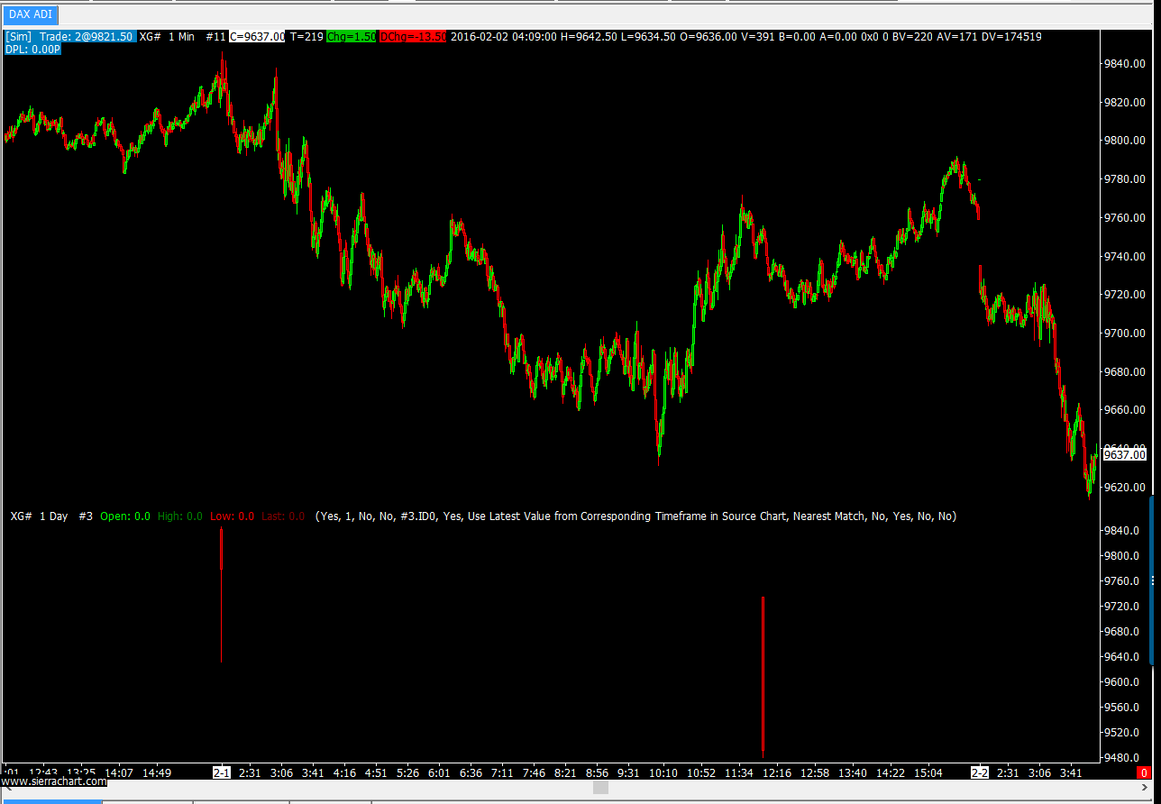

[2016-02-10 06:13:58]
that's what i would expect. yet, here is my study again, which shows mid day bars as for the study overlay
hers is the daily chart http://www.sierrachart.com/image.php?l=1455084542690.png
here is the 1 min chart with overlays http://www.sierrachart.com/image.php?l=1455084595656.png where you can see there are bars in the middle of the day and if i use daily bars as the source this should not happen
