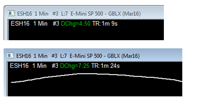

The 1 min candlestick bar charts sometimes have a Timeframe Longer than 1 min. It will start building a new bar but the time remaining timer says the bar has, for example 1 min 24 sec till it finishes. Its not a consistent amount of time, sometimes it will say 1 min 15 sec other times its 1 min 10 seconds. You get the idea. I have it displayed on my charts with TR and it counts down till bar completion.

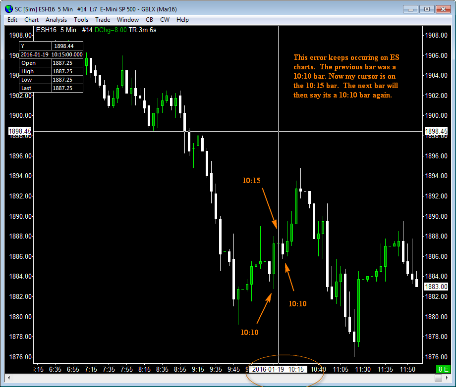

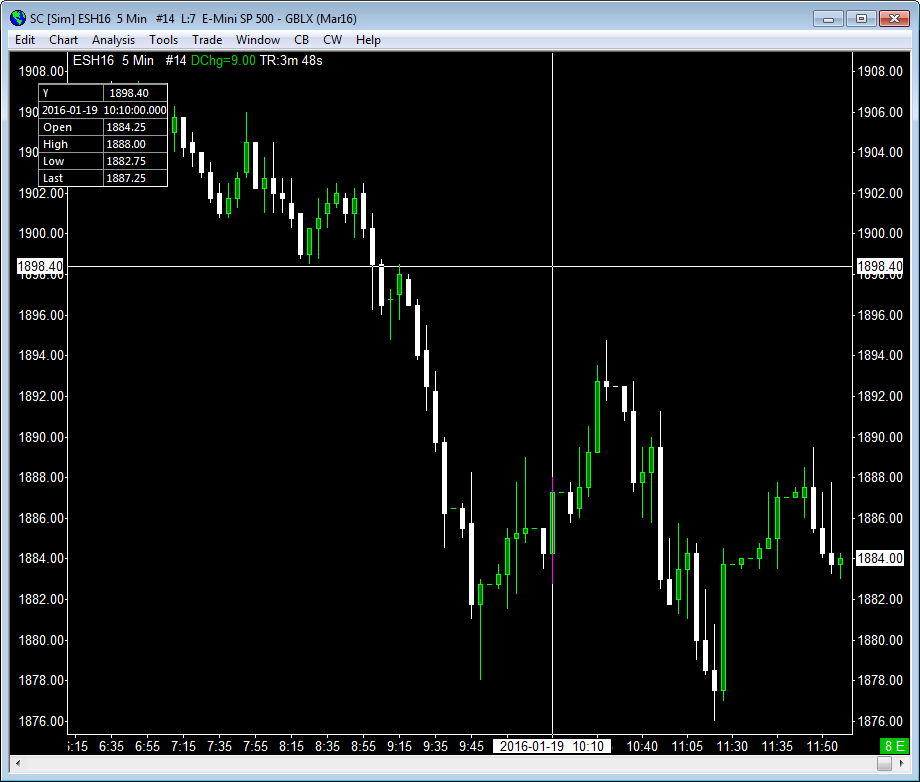

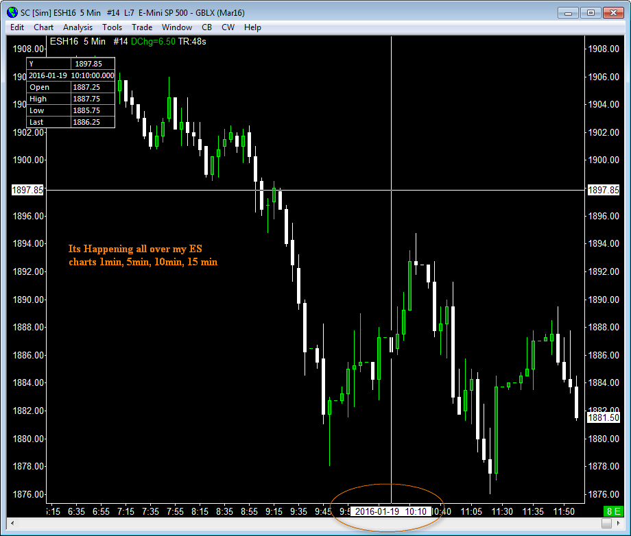

Another error that is occurring is the candlestick charts are repeating bars with different timeframes. For instance 10:10 a bar completed on the 5 min chart, 10:15 another bar completed, at 10:20 another bar completes but states that its bar time is 10:10. This occurs at different time frames on the chart and again not a consistent amount of time.

image1 Min Errors Jan 19 2016.png / V - Attached On 2016-01-19 18:42:47 UTC - Size: 56.12 KB - 365 views
imageES Errors 5 min 01.png / V - Attached On 2016-01-19 18:43:01 UTC - Size: 23.67 KB - 400 views
image5 Min ES Error 02.png / V - Attached On 2016-01-19 18:43:13 UTC - Size: 34.23 KB - 353 views
image5 Min ES Error 03.png / V - Attached On 2016-01-19 18:43:24 UTC - Size: 30.05 KB - 378 views

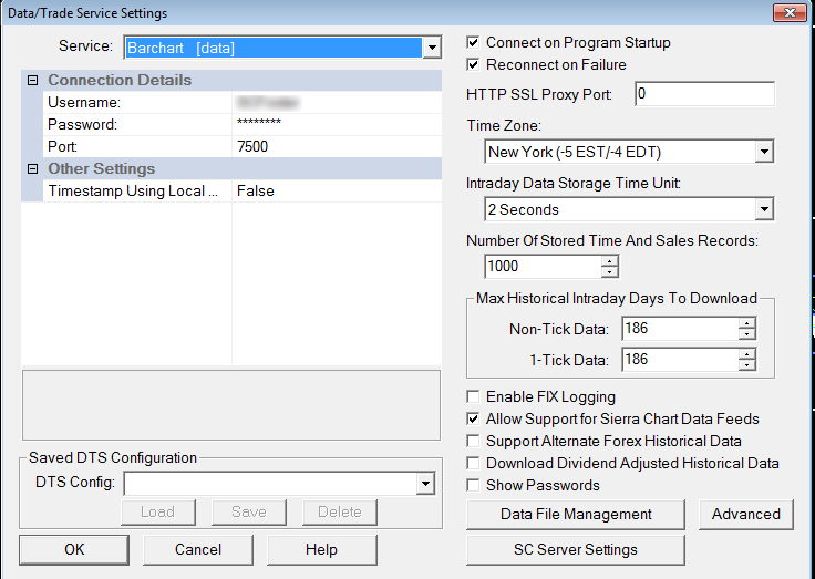

How do you have Global Settings >> Data/Trade Service Settings >> Other Settings >> Timestamp Using Local Computer Clock set?

There is no >>Other Settings>> in my data/trade service settings.
imageData Trade Service Setting Jan 19 2016.png / V - Attached On 2016-01-19 19:48:57 UTC - Size: 21.76 KB - 443 views

We see that Time Stamp Using Local Computer Clock is false in your Sierra Chart.
That is what it should be. Post likely we are going to have to look into this using remote assistance.

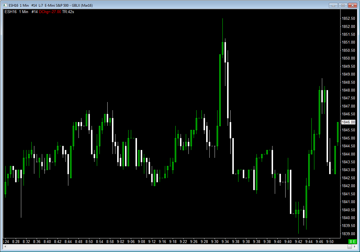

Jimmyz - Posts: 7
Its even worse this morning.
imageES 1 Min Worse Jan 20 2016.png / V - Attached On 2016-01-20 14:52:53 UTC - Size: 24.88 KB - 447 views

Jimmyz - Posts: 7
I reset my internal clock and reloaded the data. After the reload it disappeared and has not occurred again. I will see how tomorrow works and post the results here if it still occurs. Thanks for the response and I will post tomorrow at some time during the day. I update my account information with my phone number as per your request.

OK just let us know if you want us to look into this. We know it is some time stamping problem. We want to understand if that is occurring with the historical or real-time data.
[2016-01-22 11:20:37]
Jimmyz - Posts: 7
No Problems all day yesterday. If anything changes I will let you know. Thanks for taking the time to respond and help diagnose.
