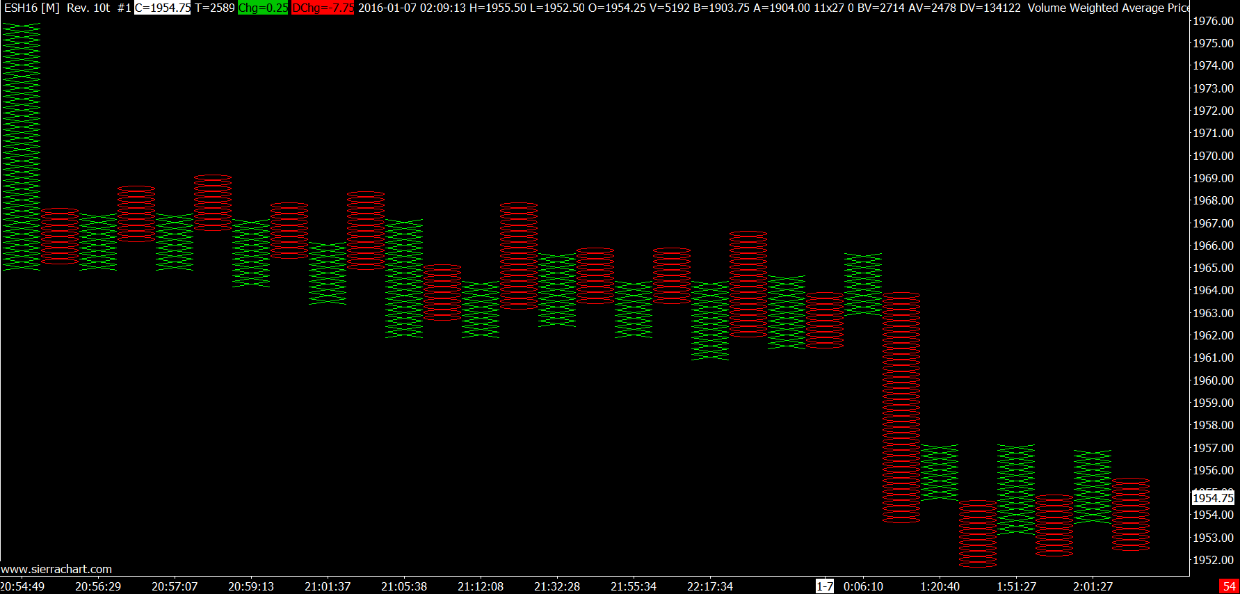

Anyway, we now have this solved:
http://www.sierrachart.com/image.php?l=1452478913718.png
But we still think there is a much better drawing method. The current method is >100 years old and meant for graph paper.

[2016-01-11 12:34:06]
User884307 - Posts: 173
hi
what version is this resolved in, im using v1352 and not displaying correctly as per you screenshot?
cheers
[2016-01-11 18:22:26]
This will be out in the next release which has not yet been released yet.

[2016-01-12 15:29:05]
Hi there
I have just downloaded the latest version of SC and used Overlay(bar) on my numbers bars chart with the XO bar type, unfortunately it still displays incorrectly.
However, if you create a new chart with reversal bars and select XO from chart settings it displays correctly.
Any ideas?
Thanks :-)
[2016-01-12 17:43:17]
You will not be able to use the Overlay study with Reversal bars and the Point and Figure XO Graph Draw Type. It will not work properly.
Date Time Of Last Edit: 2016-01-12 17:43:32
