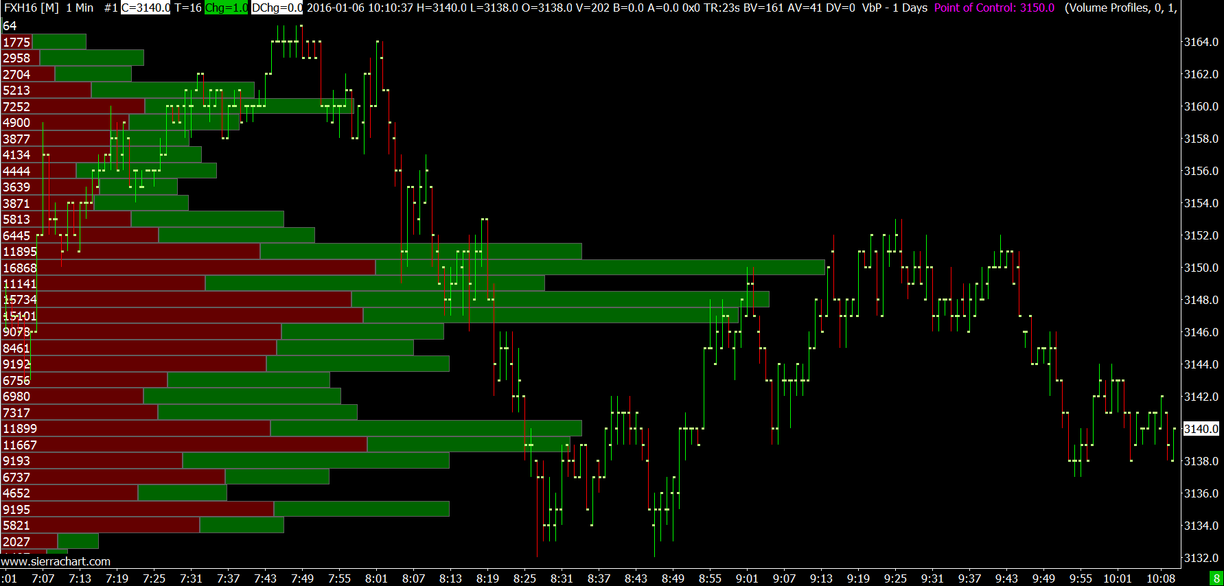

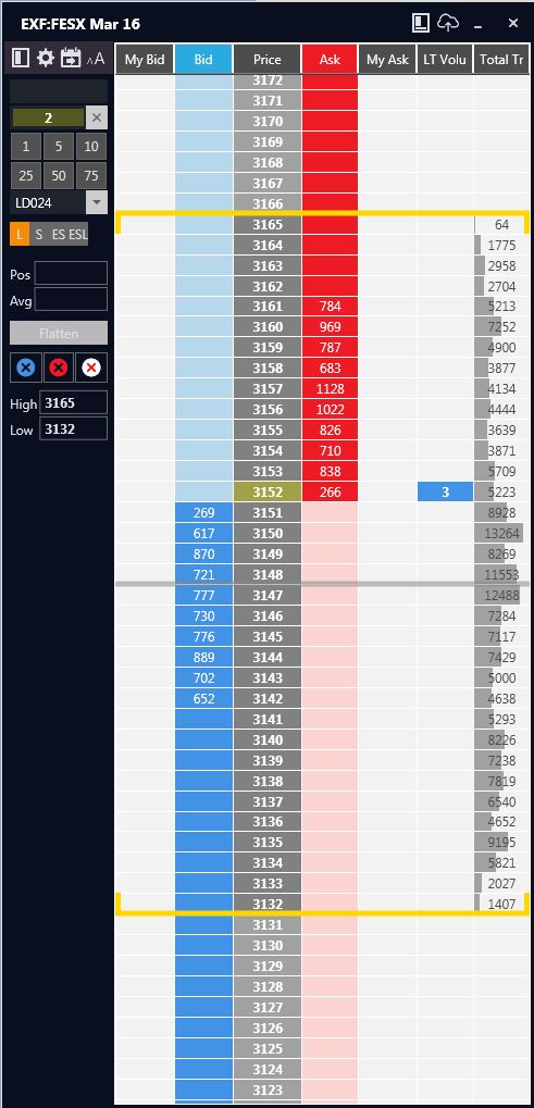

The volume in my numbers bars chart is not adding up to what is going through on the exchange. See the volume on the chart below compared to the volume on my ladder (attached). Both are using the easyscreen feed so should they not reflect the same volumes at prices? For example at a price of 3135 my ladder shows that 9195 lots have traded whereas on the chart only 2450 lots have traded at that price. This seems to be a recurring problem at every price level and more importantly Sierra doesn't seem to register alot of the bigger sized trades. Is there a fix for this?

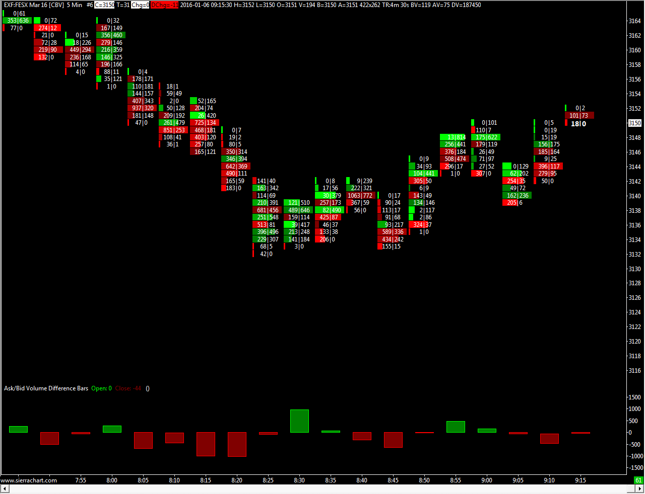

Here is a screenshot of the FESX for 2016-01-06 from the Sierra Chart Exchange Data Feed:
http://www.sierrachart.com/image.php?l=1452075743181.png
This is not from the Easy Screen data. But our own data feed.
Easy Screen is not providing the same data for charting as your trading ladder.
We will contact them about this. When did this start happening?

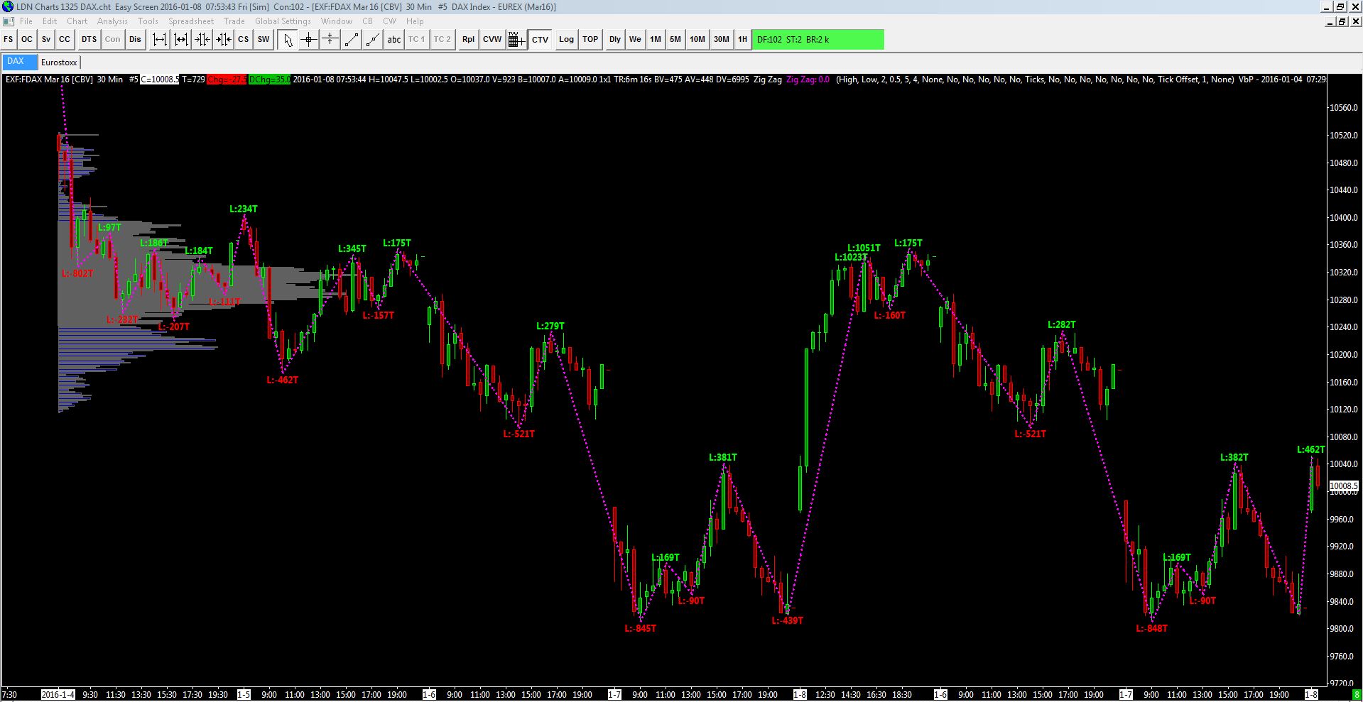

FYI I've noticed that the DAX charts aren't correct either as data from this week's trading has been duplicated (see attachment) and the volume on the Numbers Bars study isn't matching up to the volume on my ladder either.
imageDAX.JPG / V - Attached On 2016-01-08 07:56:44 UTC - Size: 196.55 KB - 601 views

Checking on the DAX historical data now.
[2016-01-08 08:21:36]
I do not see a problem with the historical data for DAX on our server. Therefore, most likely an incorrect timestamp caused that duplicate data.
If you re-download the data in the chart with Edit >> Delete All Data and Download it should be corrected. If not let us know.
