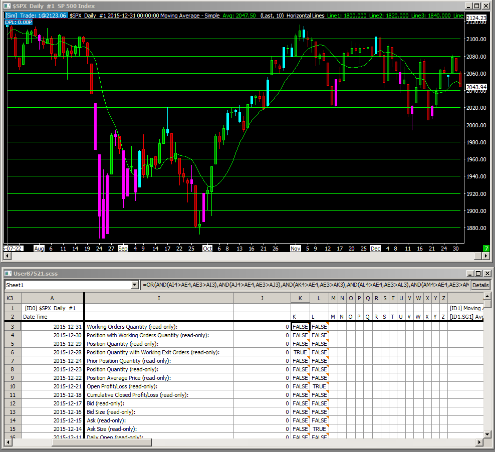

User87521 - Posts: 116
Thanks very much Tom. I did some work on this. Will this work with multiple pivot points? I ask because of the following:
My spreadsheet is structured like this:
MA last cell - AE3 (most up to date MA value)
Pivot point cells - AI3 to AX3 (from horizontal line study)
Cells are also populated from AI3 to AI "xx", AJ3 to AJ "xx"- etc.
My formula for the Buy Entry is as follows:
=OR(AND(AI4>AE4,AE3>AI3),AND(AJ4>AE4,AE3>AJ3),AND(AK4>AE4,AE3>AK3),AND(AL4>AE4,AE3>AL3),AND(AM4>AE4,AE3>AM3),AND(AN4>AE4,AE3>AN3),AND(AO4>AE4,AE3>AO3),AND(AP4>AE4,AE3>AP3),AND(AQ4>AE4,AE3>AQ3),AND(AR4>AE4,AE3>AR3),AND(AS4>AE4,AE3>AS3),AND(AT4>AE4,AE3>AT3),AND(AU4>AE4,AE3>AU3),AND(AV4>AE4,AE3>AV3),AND(AW4>AE4,AE3>AW3),AND(AX4>AE4,AE3>AX3))
And for the Buy Exit:
=OR(AND(AI4<AE4,AE3<AI3),AND(AJ4<AE4,AE3<AJ3),AND(AK4<AE4,AE3<AK3),AND(AL4<AE4,AE3<AL3),AND(AM4<AE4,AE3<AM3),AND(AN4<AE4,AE3<AN3),AND(AO4<AE4,AE3<AO3),AND(AP4<AE4,AE3<AP3),AND(AQ4<AE4,AE3<AQ3),AND(AR4<AE4,AE3<AR3),AND(AS4<AE4,AE3<AS3),AND(AT4<AE4,AE3<AT3),AND(AU4<AE4,AE3<AU3),AND(AV4<AE4,AE3<AV3),AND(AW4<AE4,AE3<AW3),AND(AX4<AE4,AE3<AX3))
No syntax errors recognized.
Both the buy entry and the buy exit register "FALSE". Currently, the Buy Exit should register "TRUE".

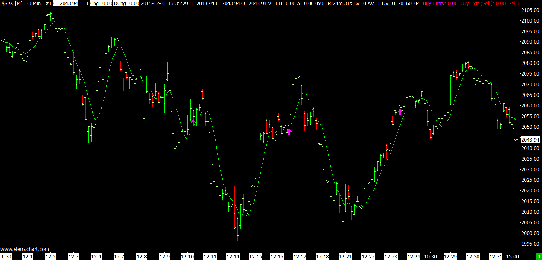

[2016-01-04 02:29:20]
Sawtooth - Posts: 4362
It works for me. Cross from belows are cyan color bars; cross from aboves are magenta color bars. See attached.
This means the formulas are valid, so here are some possible reasons you only see FALSE:
1) The symbol you are using has a very small Tick Size and the Value Format of the MA and Horizontal Lines needs to be equal or smaller.
2) There are some crossovers where the MA value equals the Horizontal Line value.
3) The default Tick Size from the data feed is too large. Change the Tick Size in the Symbol Settings to a smaller value and Delete All Data And Download. (This is rare and usually only with Forex).
Only #2 would apply to the SPX.

[2024-03-30 20:11:07]
My question is what exactly is is the chartbook about?
The chartbook/spreadsheet colors the bar when the SMA10 (ID3) crosses any of the Horizontal lines; cyan for a crossfrombelow, and magenta for a crossfromabove.
It is intended to only be an example.
I updated the chartbook for compatibility with the latest versions. See attached.
