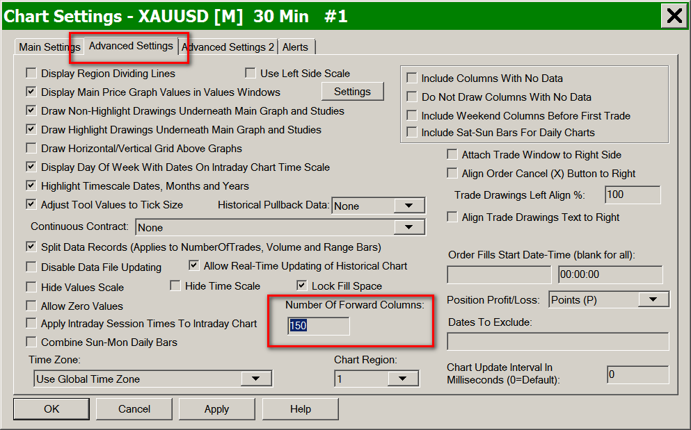

Have checked and rechecked "Charts|Chart Settings|Advanced Settings" and can find nothing at all there that is described as "Number of Forward Columns."
I have Package 1 and am using version 1335.
Am I allowed to upgrade to a more recent version that will let me choose the "Load Sunday Data" option?
[2015-12-15 10:19:04]
Refer to the attachment for the location of this control.
Version 1335 is sufficient for the above setting.
Follow the instructions here to update to the current version:
https://www.sierrachart.com/index.php?page=doc/download.php#FastUpdate
Yes you are allowed to do that.
imageNumberOfForwardColumnsSetting.png / V - Attached On 2015-12-15 10:18:09 UTC - Size: 41.07 KB - 438 views

However, "Charts|Chart Settings|Advanced Settings" does not appear to have changed at all. What I have looks nothing like the attached image you were thoughtful to provide. Despite the update to 1336, I still can't find anything described as "Number of Forward Columns." No idea what is going wrong.

The control for "Number of Forward Columns" does indeed appear in "Chart|Chart Settings|Advanced Settings" and I missed it.
If I increase the "Number of Forward Columns" from the default of 150 to 1500, will that cause memory problems?
[2015-12-17 05:42:51]
We apologize for the delay with responding to post #10.
We now understand that you did find the Number of Forward Columns control.
It is perfectly acceptable to set it to 1500.

"Number of Forward Columns": As to attempts to extend into fill space to the right and work (on a Friday, for example, as above) on charts beyond Monday, however, no matter how much I increase the number in the control for "Number of Forward Columns" under "Chart|Chart Settings|Advanced Settings" there is no effect whatsoever on the amount of fill space to the right made available. The "Lock Fill Space" control just above is unchecked - if that makes any difference. I can move only so far forward into the following week's charts, so I am wondering what exactly the control for "Number of Forward Columns" achieves.

NUMBER OF FORWARD COLUMNS:
No matter how much I increase the number in the control for "Number of Forward Columns" under "Chart|Chart Settings|Advanced Settings" there is no effect whatsoever on the amount of fill space to the right made available.
The extent to which I can move forward into the future on the charts seems to be fixed. So I am wondering what exactly the control for "Number of Forward Columns" should achieve.

Using the Maximum Amount of Space from Number of Forward Columns Setting:
To take advantage of the maximum amount of space on the right side of a chart when using a higher Chart >> Chart Settings >> Advanced Settings >> Number of Forward Columns setting, follow these instructions:
- Increase the Chart >> Chart Settings >> Advanced Settings >> Number of Forward Columns setting to what you require.
-Unlock the fill space by removing checkmark from Chart >> Lock Fill Space.
-Decrease the spacing in the chart by pressing the down arrow key on the keyboard or by using the "Large Decrease Spacing" Control Bar button. Decrease it to an absolute minimum. You will see 0 at the lower right of the chart when it is at the minimum.
- Press the right arrow on the scrollbar at the bottom of the chart to scroll the chart bars towards the left, so only 1 bar appears on the left of the chart.
-Optionally increase the timeframe of the chart bars until you see the Date-Times in the right side fill space that you require.
- As you may already have observed, any of the above, only needs to be done to the extent that you require to get the Date-Times in the right side fill space that you require. You can then draw Chart Drawings into that right side.
