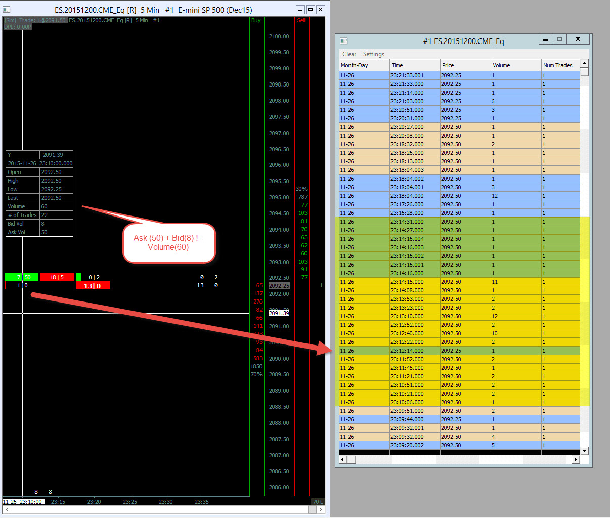

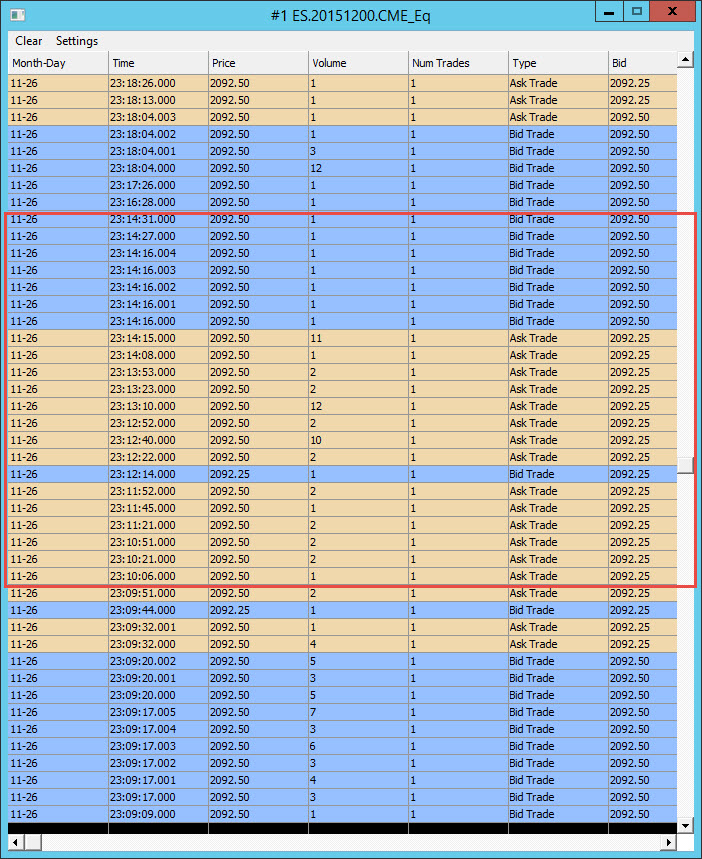

SC Team - There seems to be a discrepency with the Bid + Ask Volume not being equal with the volume (few occasions).
As you can see from this image - Volume calculated is accurate but Bid + Ask Volume doesn't represent this volume. This is a 5 minute bar with CTS Data.
screencast.com/t/AZe03q5Snv
screencast.com/t/DHHzwDdMVv9N
When you get a chance - would you please review this? Please note that this is realtime bar and NOT during replay. Image also has T&S records highlighted which makes up the bar.

So is the problem that the Bid Volume and Ask Volume does not equal the Volume in an Intraday chart? There should never be a problem with this unless there is not Bid Volume or Ask Volume available historically. In which case those would be zero.

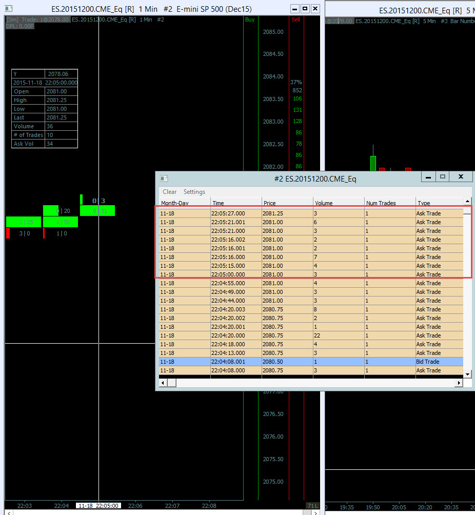

[2015-11-27 06:25:17]
ejtrader - Posts: 689
This is an intraday chart - and I am referring to a single 5 minute bar.
Attached are the images describing the issue. ( first 2 images are from today and the third image is from 11/18).

[2015-11-27 06:55:58]
We have an idea why this happens but it is a little difficult to solve. It has to do with the CTS historical data.

[2015-11-27 09:25:43]
We found the problem. It has to do with inserted Time and Sales records in the historical data. It is now resolved.
Although part of the problem was with CTS historical data as well.
Date Time Of Last Edit: 2015-11-27 09:28:04

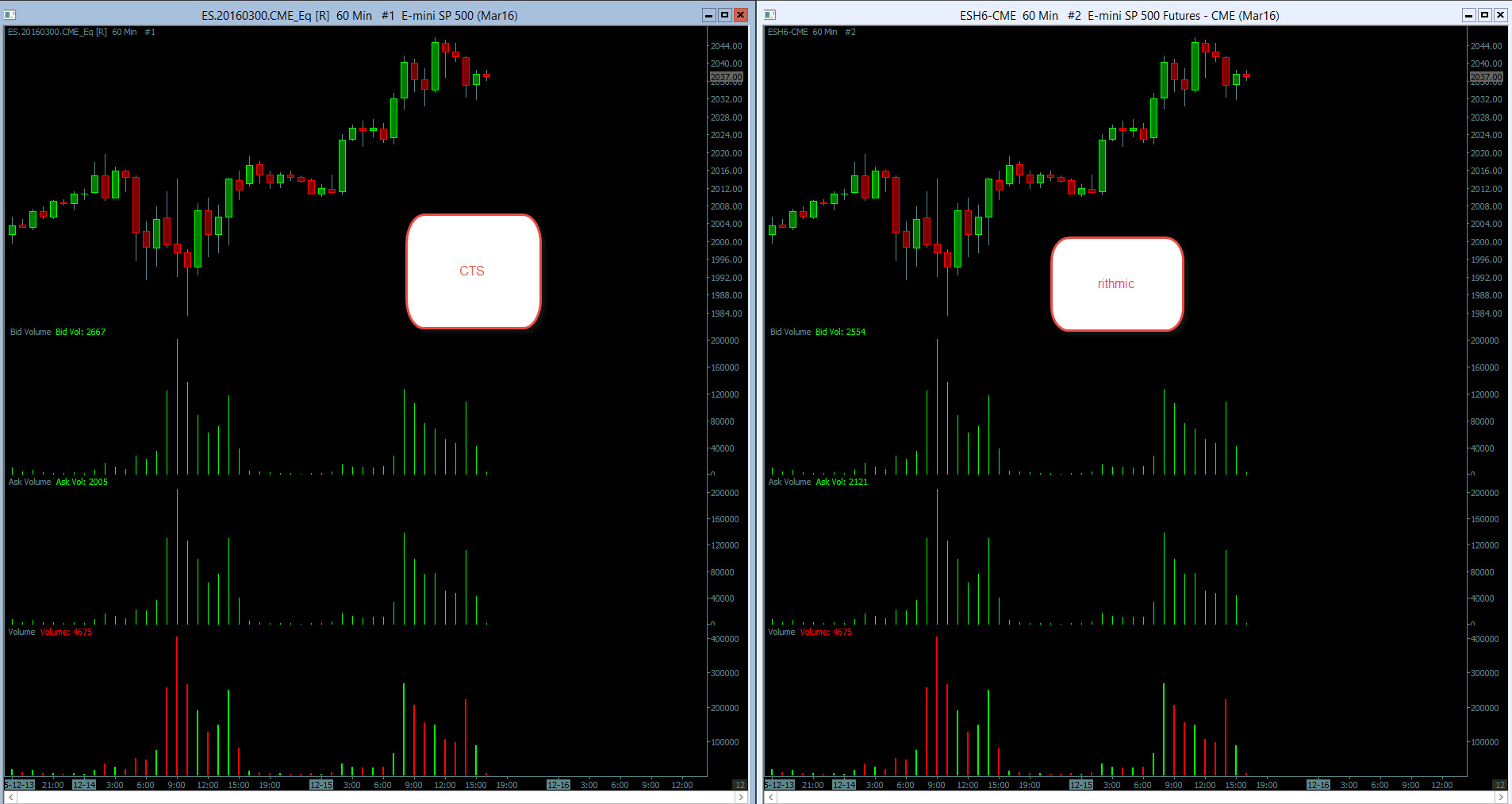

SC Team - This problem seems to have popped up again ( using latest version - 1339)
Would you please review?
PS:This seems to be only with CTS but not with rithmic. Volume/Bid/Ask - standard SC studies used in the image to demonstrate the issue.

However - got to admit this has given enough grief as I was building a custom study for which these values are important. It was more of a wild goose chase as I kept on trying to fix a non-existing problem with the code :( Would be using rithmic/CQG data until you get a chance to work on this. Though it is very minor - I just couldn't get my study to work reliably with CTS data in it's current state but no issues with rithmic/CQG data.
May be a hint - My observation has been - this is when the chart is First loaded and this is true for the very last bar in question. Otherwise when a new bar is formed during realtime - haven't noticed this volume discrepancy issue (volume != ask+bid volumes). Would update if I could locate any other patterns.
Attached is the image - which shows the data for the very last bar on 60 minute chart - which shows the discrepancy.

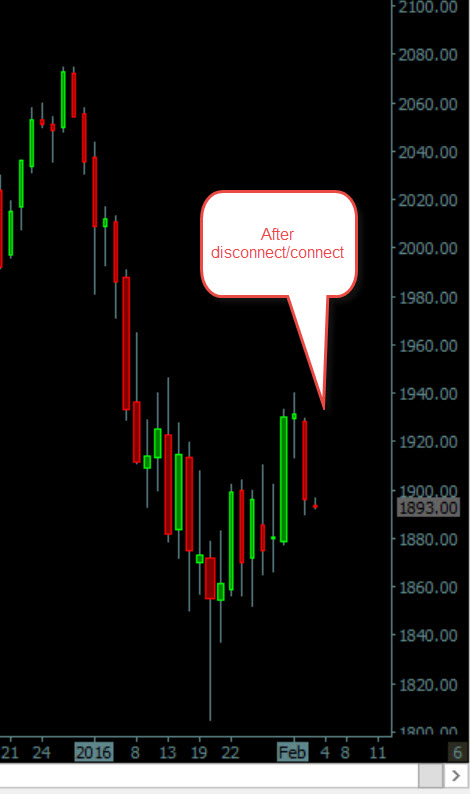

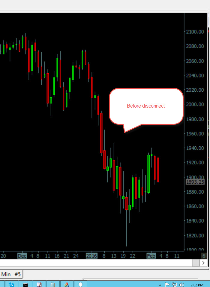

[2016-02-03 01:08:14]
SC Team - This is still an issue at present. Would you please have this checked one more time?
As you can see from attached images of Daily Charts - you can see the OHLC of last bar is incorrect while running. This gets fixed only after disconnect/connect ( refresh / reload doesn't fix it).
imageSC_CTS_Daily_before_reconnect.jpg / V - Attached On 2016-02-03 01:06:56 UTC - Size: 95.03 KB - 388 views
imageSC_CTS_Daily_After_reconnect.jpg / V - Attached On 2016-02-03 01:07:08 UTC - Size: 60.72 KB - 483 views

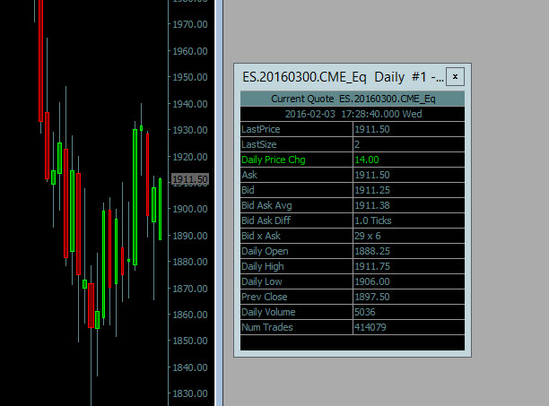

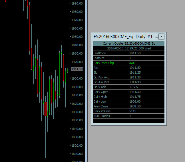

[2016-02-03 23:31:18]
SC Team - Even the Current Quote window is incorrect. Attached are the images.
imagesc_CTS_Daily_incorrect.jpg / V - Attached On 2016-02-03 23:31:01 UTC - Size: 77.29 KB - 468 views
imagesc_CTS_Daily_After_reconnect2.jpg / V - Attached On 2016-02-03 23:31:08 UTC - Size: 84.14 KB - 459 views
