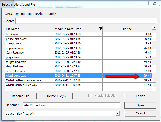

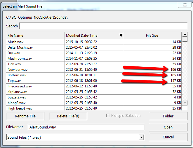

[2015-10-15 09:18:46]
Zosimus - Posts: 345
I noticed that the 4 sound alert files that do work are much larger then all the other that don't work. See attached screenshots.
Does this help make any sense of this problem?
imageSoundAlertFiles2.png / V - Attached On 2015-10-15 09:18:04 UTC - Size: 45.34 KB - 546 views
imageSoundAlertFiles1.png / V - Attached On 2015-10-15 09:18:17 UTC - Size: 52.81 KB - 588 views
[2015-10-15 09:39:53]
No not really. The next version will actually display the operating system error message indicating what the problem is.
