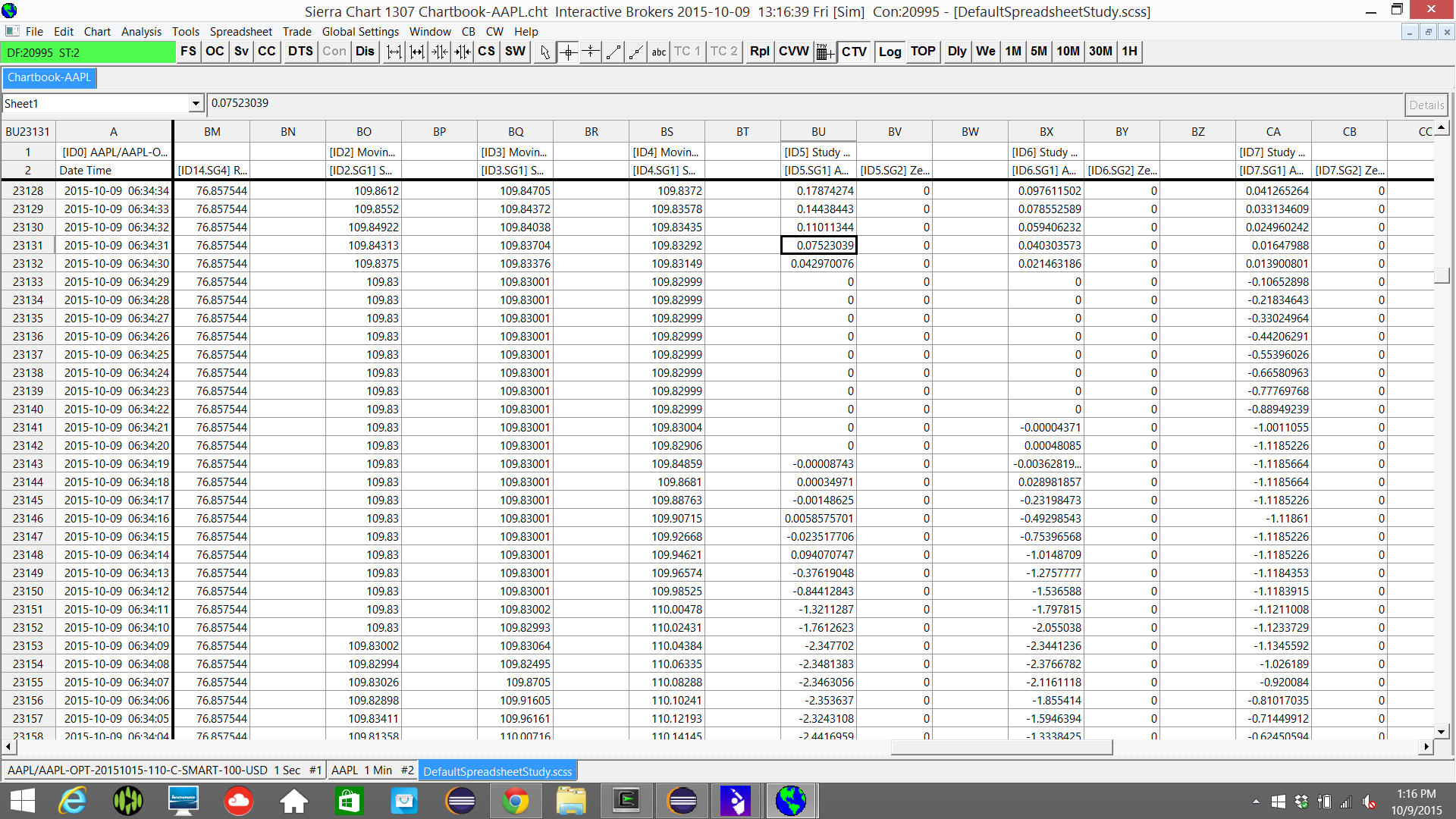

Please review attached docs, looking at the sec data, is there a filter to enable all columns to be filled?
imageimage.png / V - Attached On 2015-10-10 21:12:01 UTC - Size: 244.22 KB - 384 views

[2015-10-10 22:37:26]
User713273 - Posts: 409
For instance in these columns/rows (BU - 23142 - 23133 & BX 23140 - 23133), the data is not established I believe due to the 1 sec data indicator arent outputting data. I would need these data points to be produced, even if it means duplicating the prior cells data.

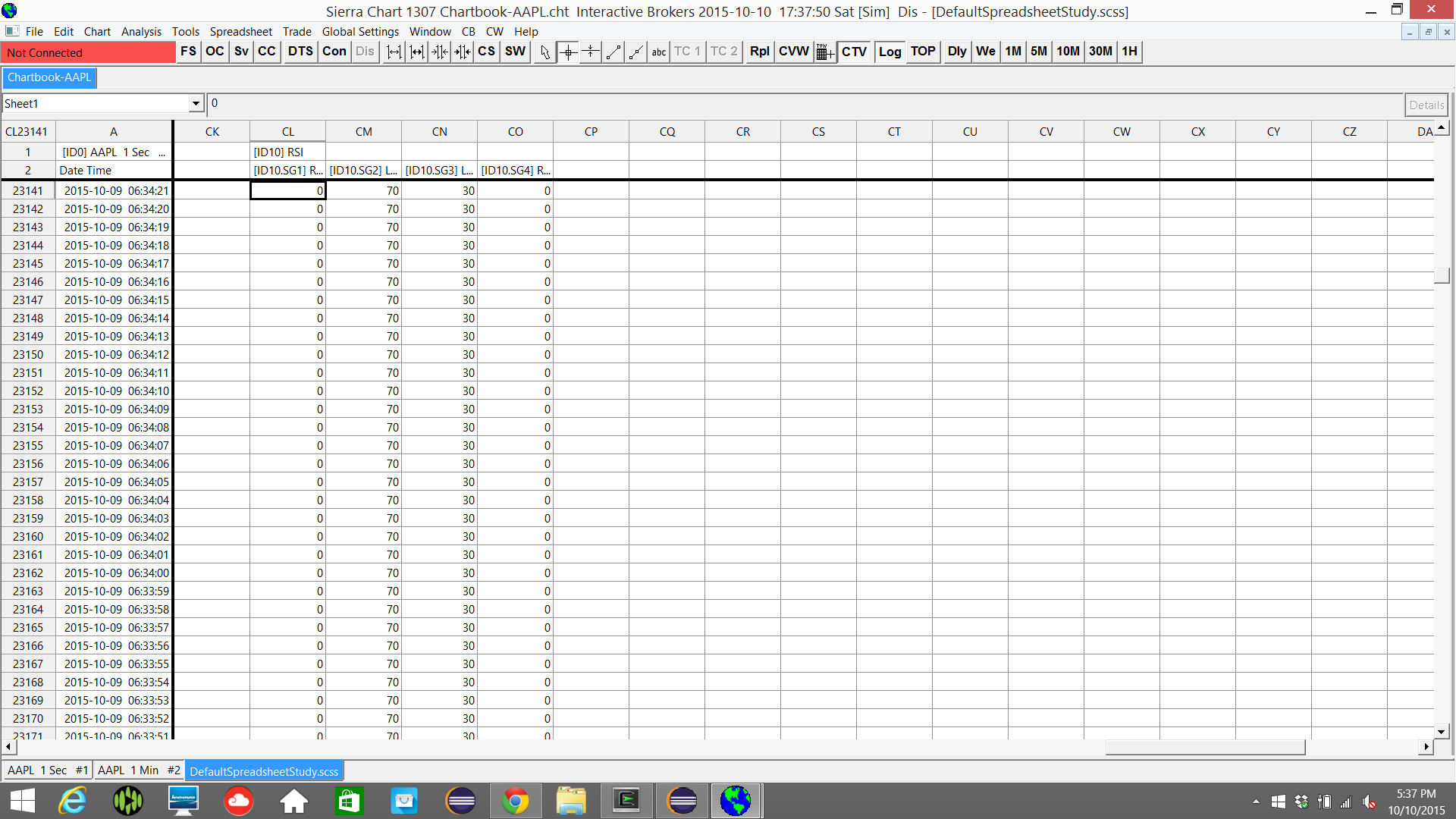

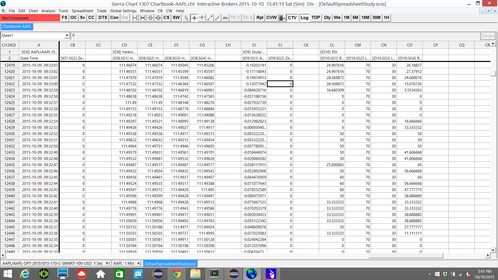

Those are study angle values. I also attached a 2nd screenshot highlighting RSI values which are also 0 in some instances.
imageimage (2).png / V - Attached On 2015-10-10 22:43:38 UTC - Size: 231.13 KB - 397 views
[2015-10-10 23:56:48]
If they are zero, then they are zero. Zero is the result of the calculations being performed by the study. This cannot be changed.

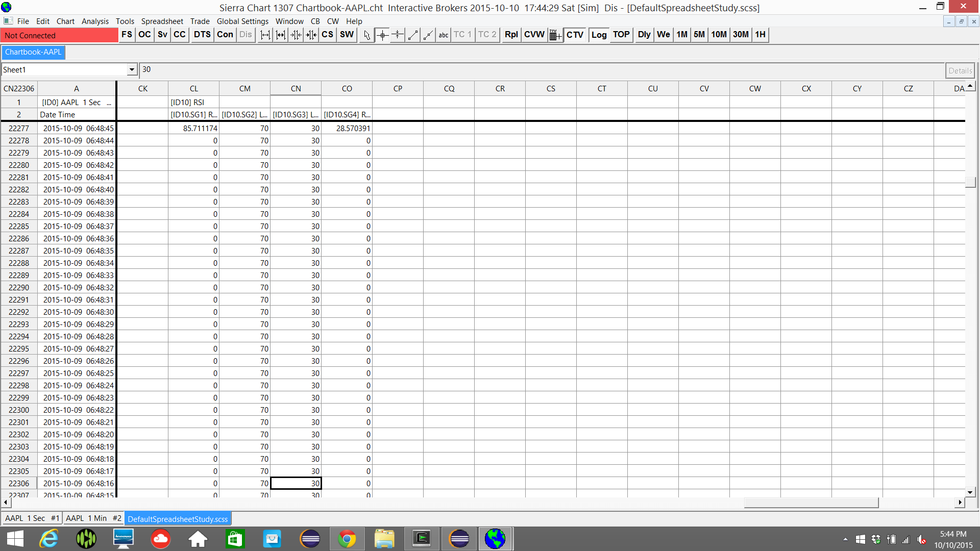

[2015-10-11 00:45:41]
I have attached another screen shot that I would like for you to look at. These RSI data points on the 1 sec chart stay at that numerical rate from 6:33:51 - 6:48:44 on 10/9 for symbol AAPL. Is this normal? I did recalculate the chart.
imageimage (3).png / V - Attached On 2015-10-11 00:42:58 UTC - Size: 185.95 KB - 444 views
imageimage (4).png / V - Attached On 2015-10-11 00:45:27 UTC - Size: 188.77 KB - 468 views

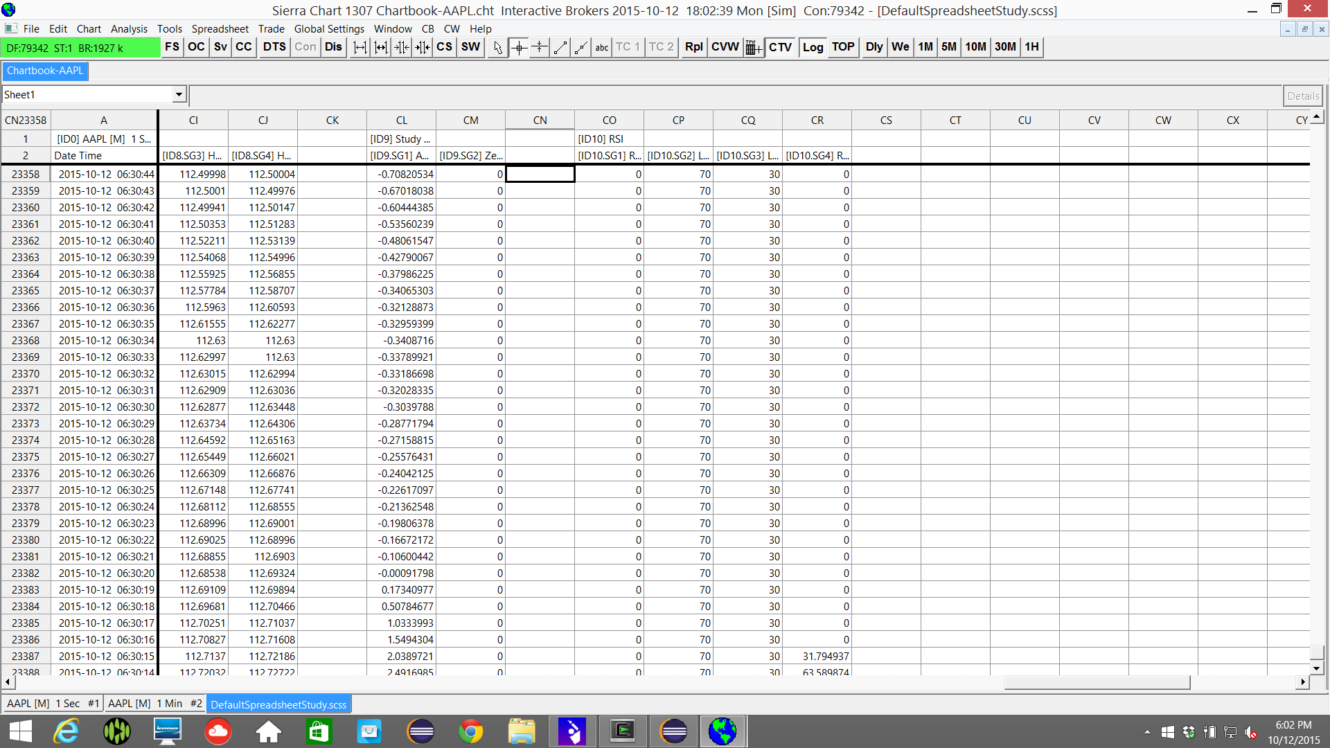

imageimage.png / V - Attached On 2015-10-13 01:06:53 UTC - Size: 217.73 KB - 396 views
[2015-10-13 02:01:09]
Once again, if RSI is giving a result of 0 that is the result based upon the data and the RSI formula. You can always create your own RSI study to do what you require.
