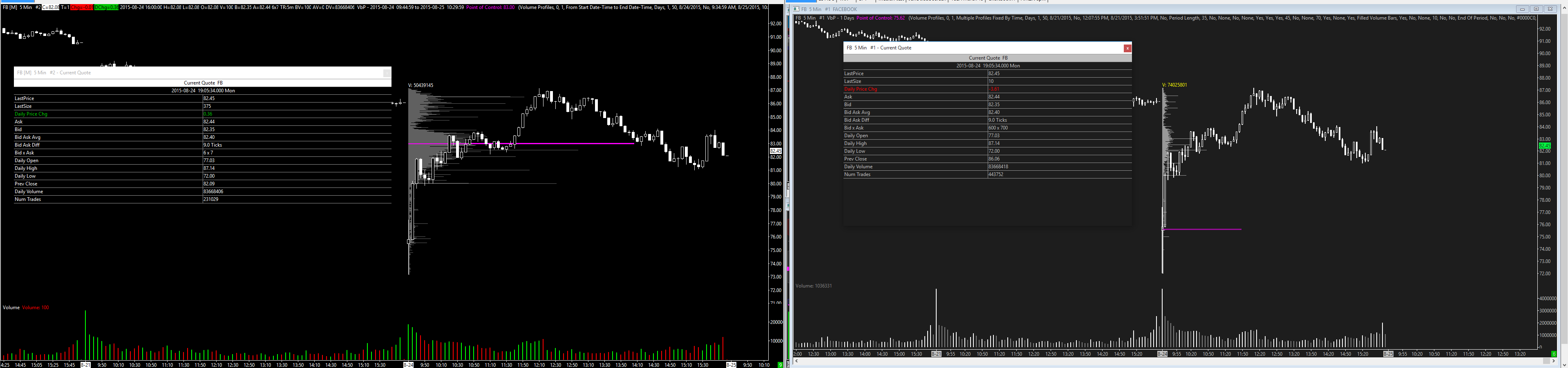

[2015-08-24 23:25:42]
Neo - Posts: 198
I followed this up with Barchart, their support confirmed that they do account for all trades at the NBBO- the comments regarding sub exchanges are to do with level 2 bid/ask data in the orderbook, which has nothing to do with volumes traded.
To confirm they do account for all trades I had bar chart support quote some volume numbers for Facebook today using a 12:15pm* timestamp. Their data had 182k traded based on a 1min chart, and 2556K on a 15min chart( this is basically the same volume numbers I'm getting from IQ feed used in SC). When I look at the same time stamps using the Bar chart feed inside SC, I get around 151k on a 1min chart, and 1990k on a 15min chart- only partial data.
Attached is a 5min chart of FB using Bar chart data on the left and IQ feed data on the right. As you can see the historical/ daily volumes virtually match, however the intraday volumes/ number of trades are well off.
Can someone please confirm the volume numbers I'm getting from the SC/bar chart feed are what you're also getting, and that it's not some issue with my PC/ connection. If you're getting the same values as me then what's going on? Where's the rest of the volume at when it appears Barchart do actually provide it?
Cheers

[2015-08-25 00:46:19]
We do see what you mean, and we are checking with Barchart about this.
It is not a problem on your side.

[2015-08-27 03:41:48]
We think we know what the problem is. There are certain types of trades that our system will filter out which is reducing the volume. This is to eliminate price spikes in charts.
We are going to make some changes to this filtering which should increase the volume. We will be doing some testing tomorrow.

[2015-08-28 17:47:04]
Yes, we did identify "inter market sweeps" as a trade condition on a trade which was being filtered. These will be included, effective at the close today.
Date Time Of Last Edit: 2015-08-28 17:47:29

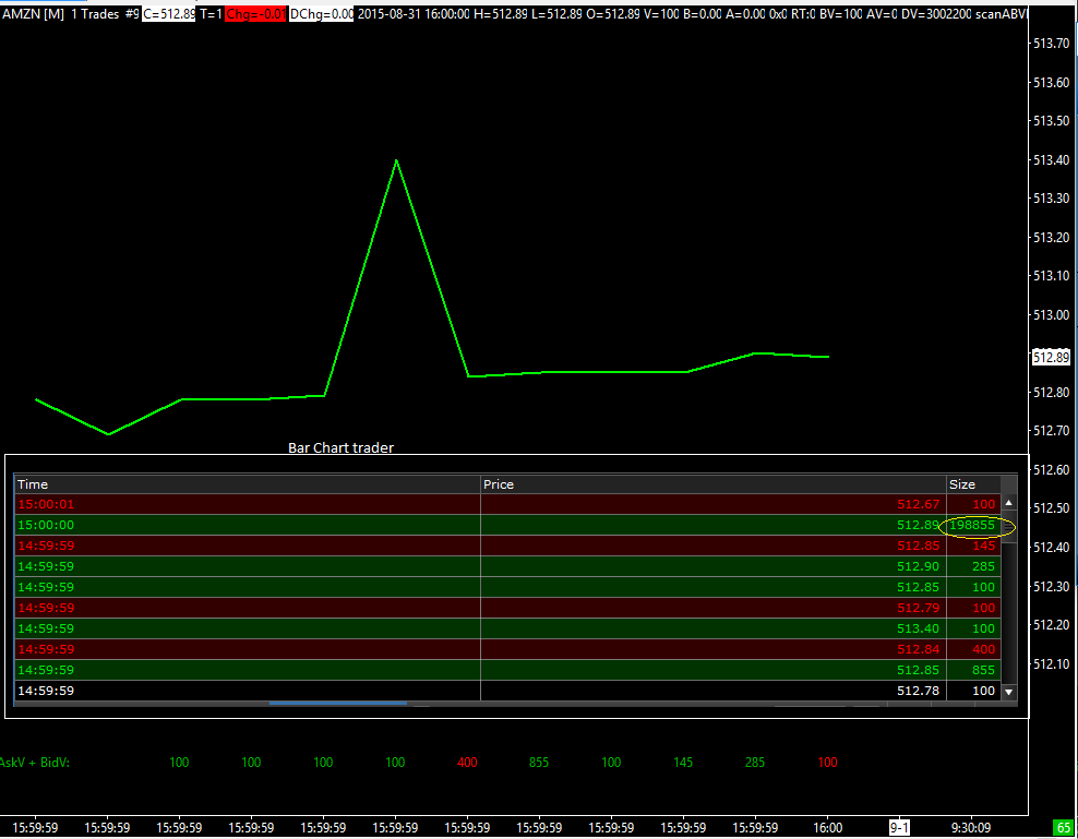

Here's an example from today using AMZN.
For comparison I've inserted the last 10 trades of the day as per Bar charts trader platform, where you can see the cross trade that went through on the close @15:00 CST. Same sort of thing happens on the open.
imageSCvsBC.png / V - Attached On 2015-09-01 06:36:52 UTC - Size: 26.08 KB - 501 views

[2015-09-04 00:11:05]
Neo - Posts: 198
Do you have an update on this? It looks like SC is now recognizing the cross trades on open/close?
Do you guys plan to backfill the historical data so it also reflects these trades?
[2015-09-04 00:28:19]
Yes these have been included.
Not sure how soon we can get to the historical data. This may still be two weeks away. It has to be carefully planned. It is a significant operation.
Date Time Of Last Edit: 2015-09-04 00:28:37
