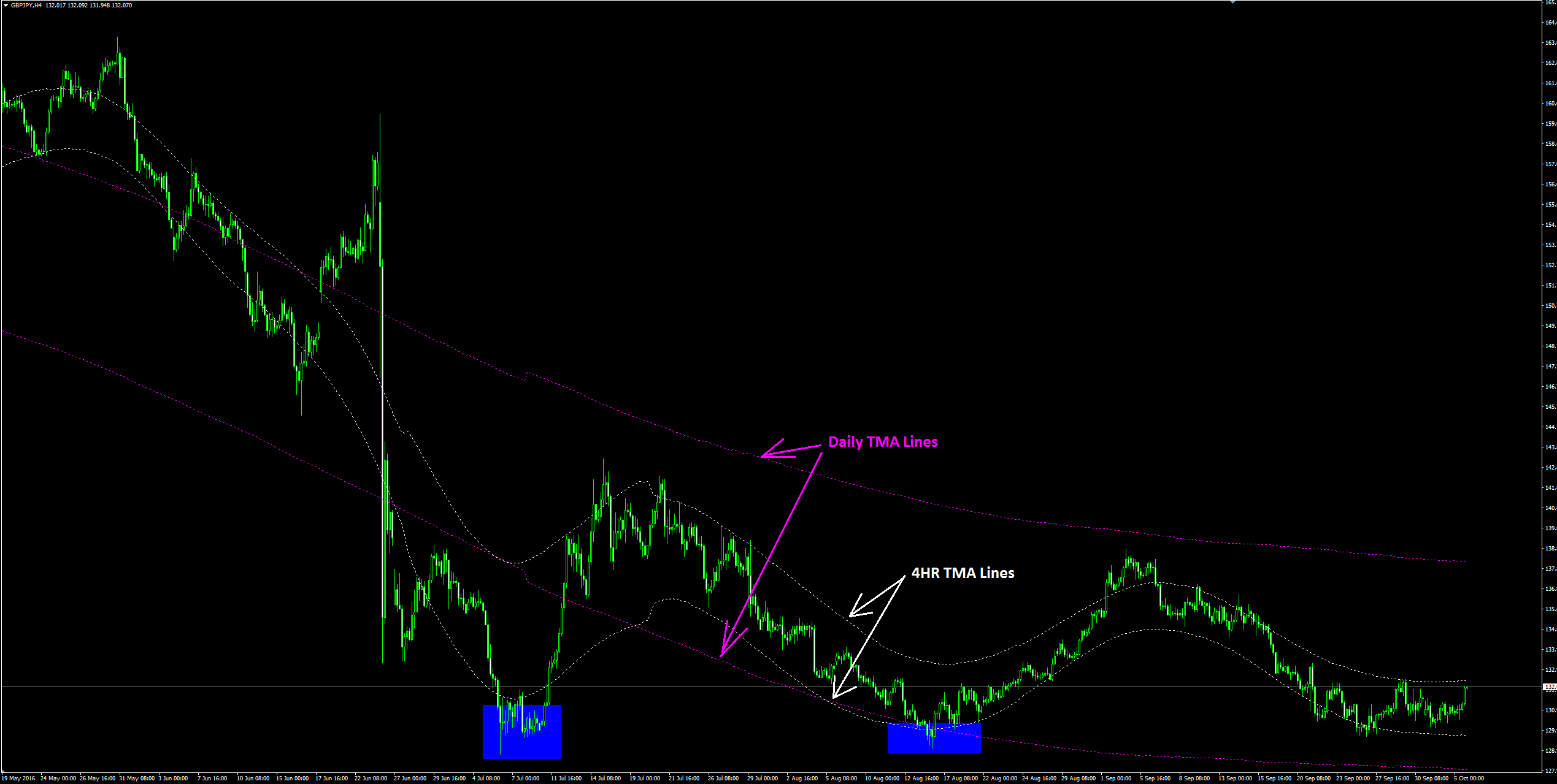

I found an indicator at ff in this thread (link below) and my question is, if
somebody here is able to code it for Sierra ?
It`s called TMA, but has nothing or nearly nothing to do with the Triangular moving average we have in the sierra indicator list.
It`s a channel with upper, middle and lower band.
The post in the link below shows screenshots how it looks and how it`s coded for metatrader4
http://www.forexfactory.com/showthread.php?p=6609629#post6609629
At the end of the post it`s the TMA.mq4 I`m interested in.
BTW. Im not interested in this trading system, just in this TMA-Channel.
Mike

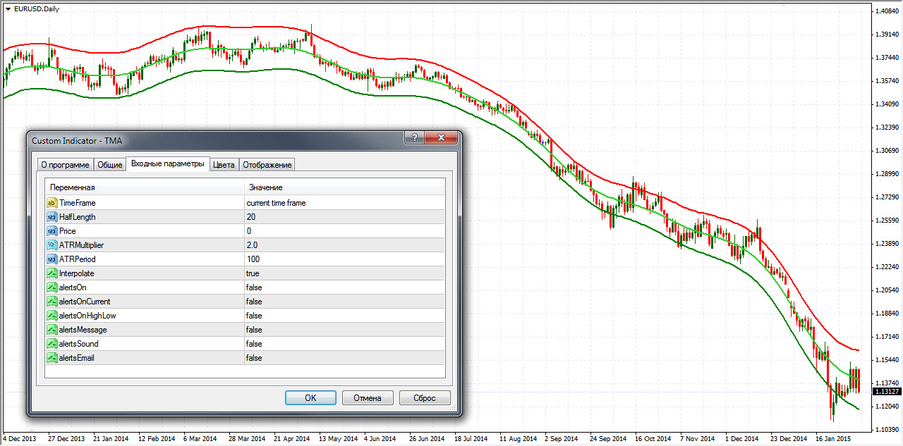

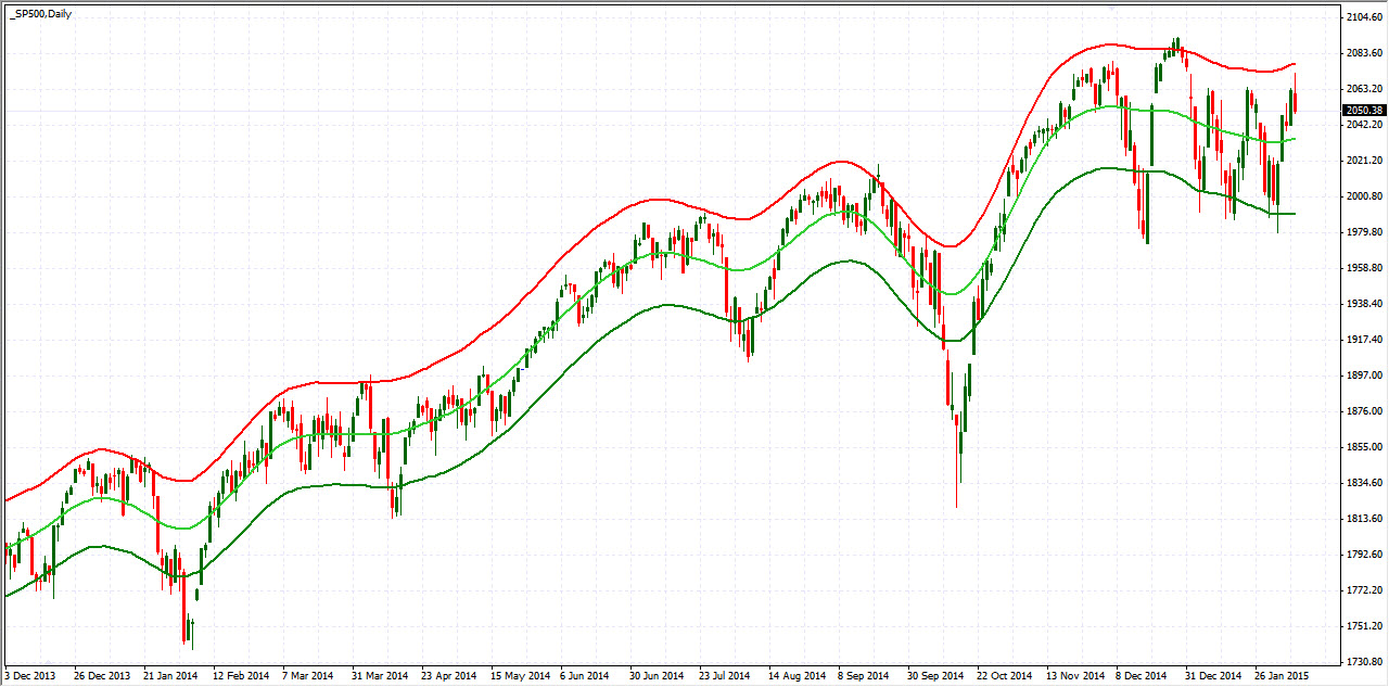

[2015-02-08 16:18:01]
User89195 - Posts: 5
Please take a look, alerts are not important.. Thank U!
Date Time Of Last Edit: 2015-02-08 16:19:51
image2015-02-08_16-09-10.jpg / V - Attached On 2015-02-08 16:15:08 UTC - Size: 259.97 KB - 1431 views
image2015-02-08_16-12-49.jpg / V - Attached On 2015-02-08 16:15:25 UTC - Size: 239.42 KB - 1165 views
[2015-02-08 16:47:40]
ehlaban - Posts: 50
Thanks this is what i needed.
Can you also tell what the settings are in both pictures like halflength and ATR and ATR multiplier.
This is crucial for me to replicate the indicator!

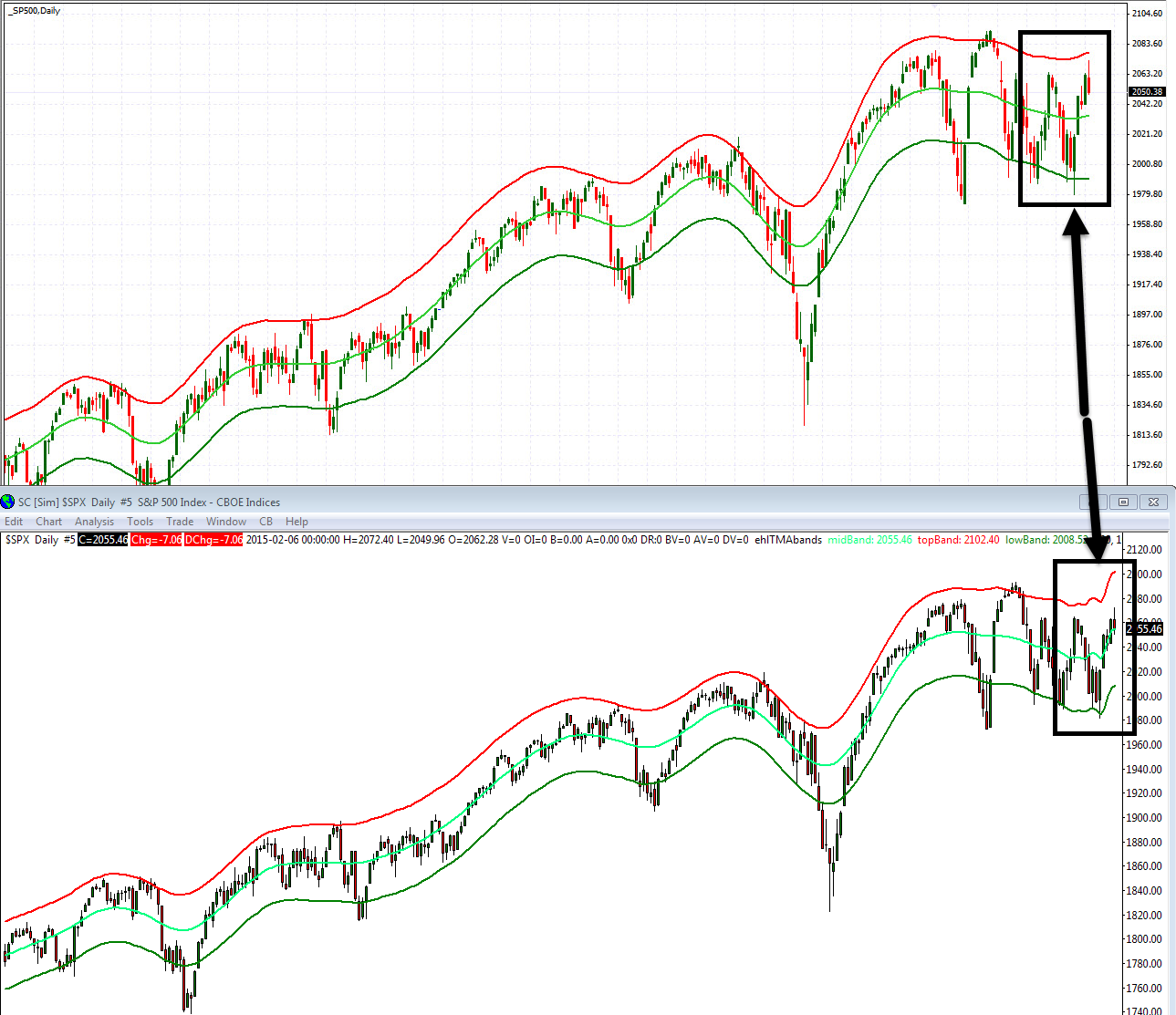

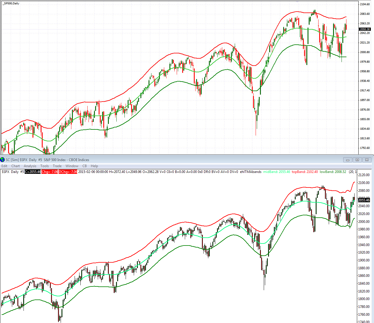

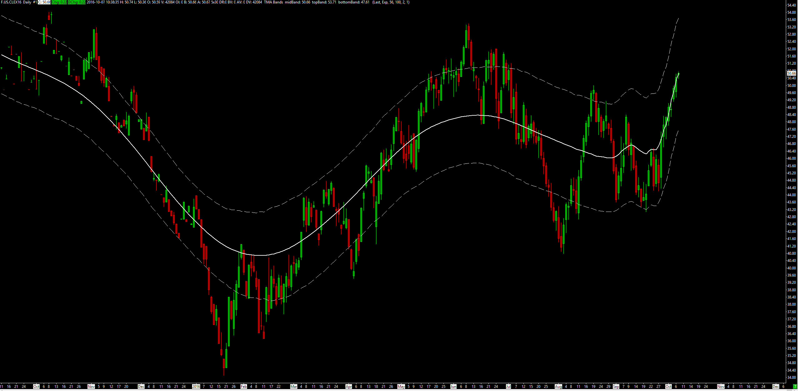

[2015-02-08 17:47:58]
ehlaban - Posts: 50
This is what i got so far, quite identical. Try to end it in a few days.
imageTMA bands.PNG / V - Attached On 2015-02-08 17:46:04 UTC - Size: 313.62 KB - 1436 views

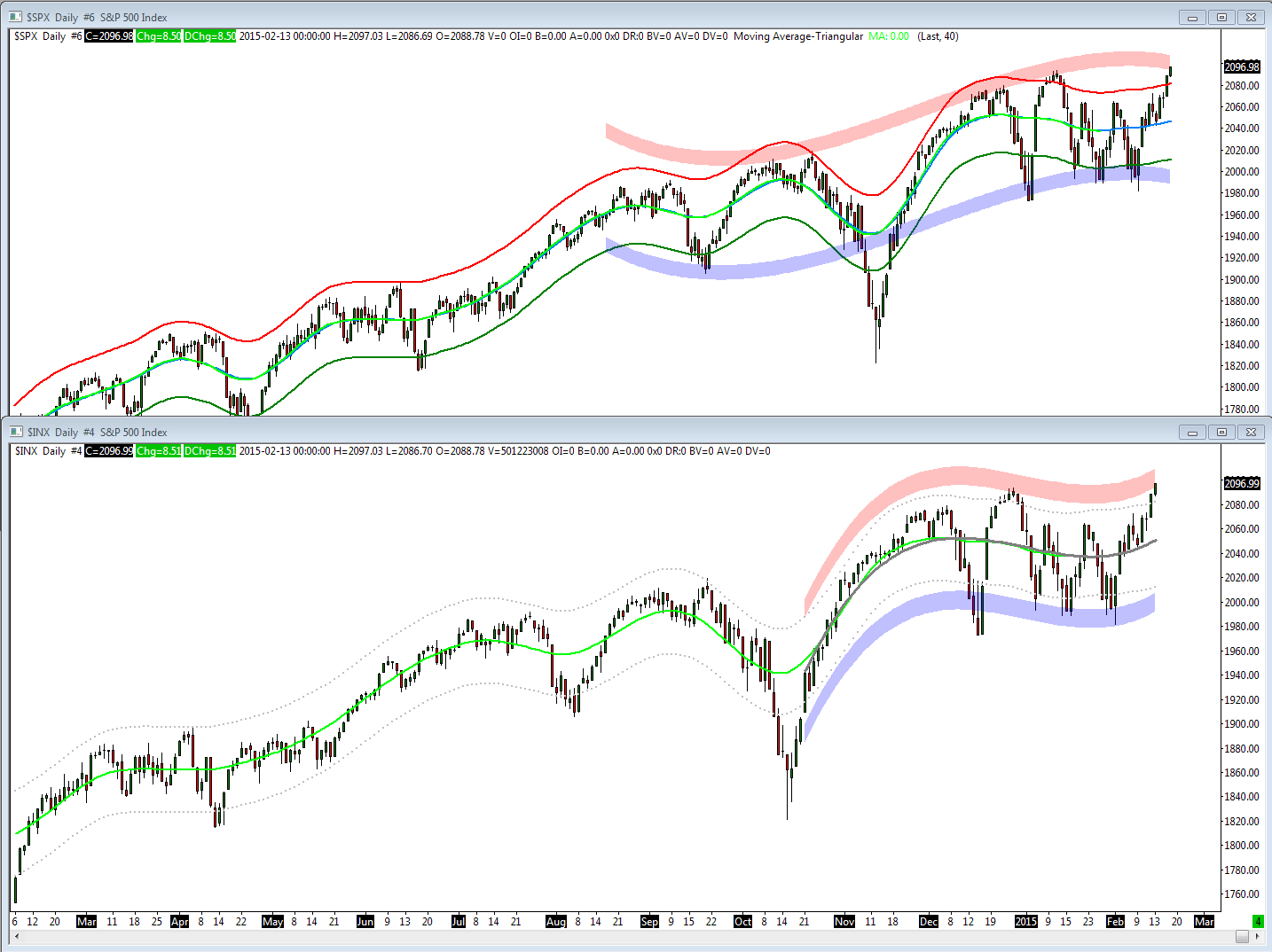

[2015-02-09 08:00:40]
Please see. In more detail, I do not know.
image2015-02-09_7-55-34.jpg / V - Attached On 2015-02-09 08:00:25 UTC - Size: 56.7 KB - 1108 views
[2015-02-09 08:11:29]
Please see drawn. Thanks!
image11.PNG / V - Attached On 2015-02-09 08:11:17 UTC - Size: 307.64 KB - 1054 views
[2015-02-12 18:55:47]
ehlaban - Posts: 50
As I don't know Metatrader i looked at http://www.traderji.com/amibroker/74960-triangular-moving-average-tma-bands.html for a reference.
But i'm afraid i can't get it correctly coded. The last part is always wrong.
Perhaps somebody else can figure it out.

[2015-02-15 10:52:52]
ehlaban - Posts: 50
I finally created something that actually can be very useful. I hope.
In the coming week(s) i will do some posts in a separate thread to show
how it works.
imageTMA-bands.PNG / V - Attached On 2015-02-15 10:51:49 UTC - Size: 93.41 KB - 1730 views

[2016-10-05 18:46:11]
User964132 - Posts: 104
Hi I really like that TMA indicator too, and use it to find the extremes on a 4hr chart, I think it repaints but on higher time frames this is not noticeable.
Would love to have this coded!
Keep smiling, Cheers
imageDAILY AND 4HR TMA lines.png / V - Attached On 2016-10-05 18:44:28 UTC - Size: 62.77 KB - 1208 views
Private File

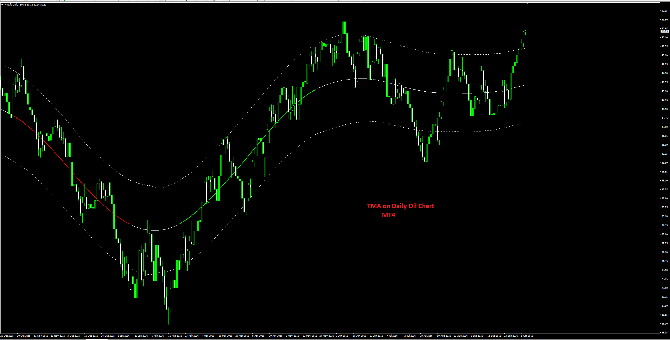

[2016-10-07 08:57:22]
Hi MKata! Thanks for coding this! And so fast! THANKS!.
I attached a daily CL chart from MT4 and Sierra, unfortunately there are quite some big differences the closer you come to the current price, I tried all the different moving averages (the Linear Regression MA, does not give any output)but can't get anywhere close to the TMA lines from the MT4 original indicator :-( It doesn't need to be exact, since I am looking for the area's, it gives a nice head's up (IF you combine a weekly, daily and 4Hr TMA) Could you take one more look at this? You help is Highly appreciated!! Keep smiling, Nicolaas
imageoil daily CL.png / V - Attached On 2016-10-07 08:51:50 UTC - Size: 55.6 KB - 1106 views
imageOil daily on Sierra charts.png / V - Attached On 2016-10-07 08:52:26 UTC - Size: 102.9 KB - 1393 views

I am using your TMA indy a lot, and although it repaints, it is very useful to point out a possible area of overboard-oversold.
Is it possible to update the indicator with a second ATR multiplier, in the same indicator? So you have two top-band lines, two bottom-band lines and one middle band line.(see attachment)
Again, THANKS A LOT!
Nicolaas
imageOil TMA bands.PNG / V - Attached On 2018-05-03 13:44:25 UTC - Size: 197.2 KB - 1301 views
