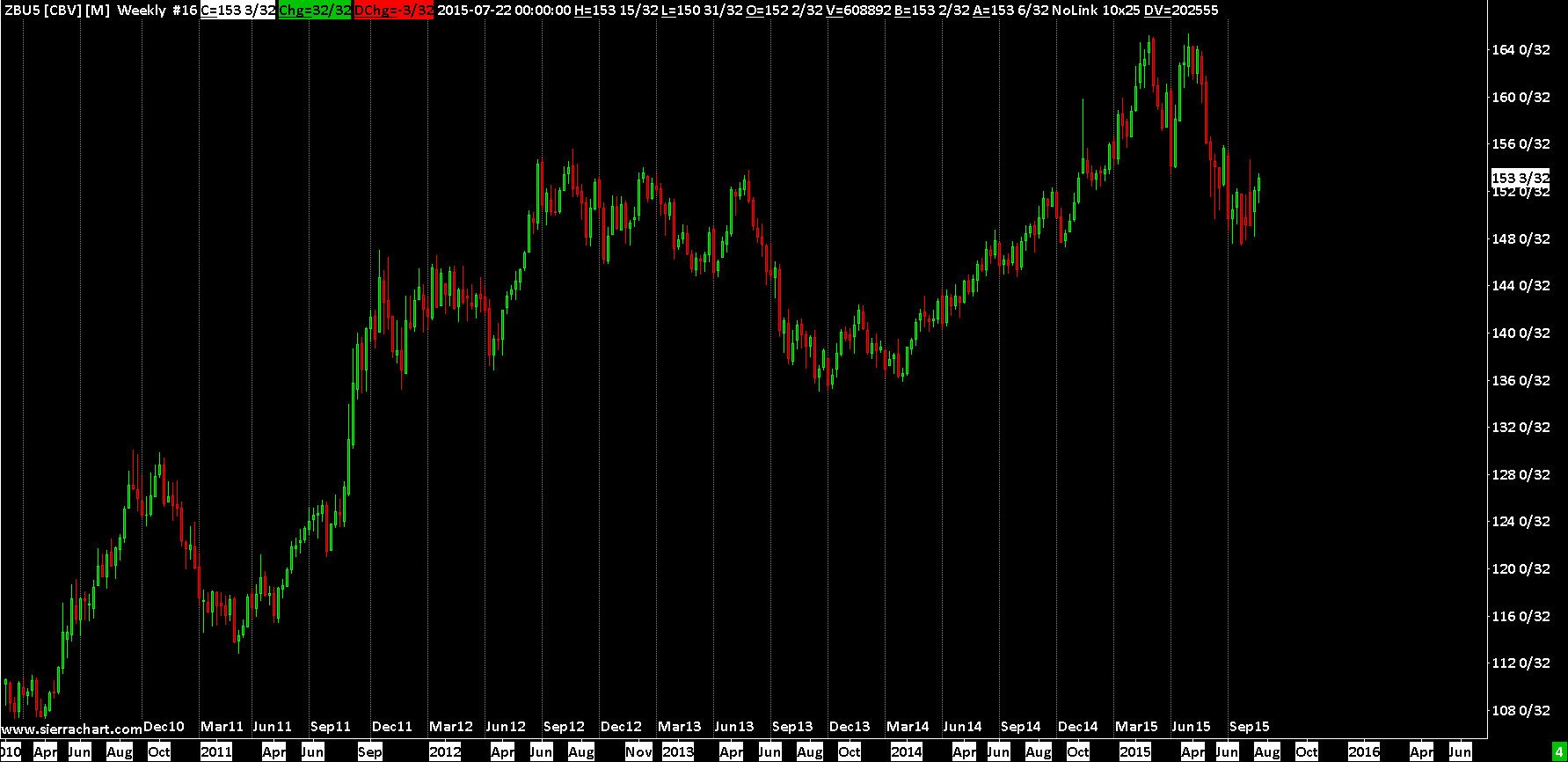

In my chartbook, I have a weekly ZBU5 chart that is showing incorrect data as though it has a bad data point. I change that chart with what looks like bad data to any other time frame, and it now shows the correct data. I've attempted to delete and reload data but to no avail. How can I fix this?

Post an image of this chart that shows the incorrect data so we can understand this better.

User927031 - Posts: 5
http://www.sierrachart.com/image.php?l=1437590196921.png

[2015-07-22 18:59:00]
I just went through all of these steps, but it didn't help. I know it looks like bad data, but I don't believe that is the case because I can flip through different time frames and all others look fine. It makes me think there is something wrong with how the weekly data function is being calculated not the data itself. If you want, I can send you a screenshot with a daily and weekly side by side, and you will see what I am saying.
[2015-07-22 21:08:49]
It is not bad data, the problem is that there is missing data. You can tell by looking at the time scale at the bottom.
Make sure you are running the current version of Sierra Chart. Update with Help >> Download Current Version.
And what procedure did you follow to re-download the data? There should be no problem with the re-downloading of data. You should be prompted to re-download data for each month and answer yes for each month starting with 2005.

[2015-07-22 21:37:48]
There is missing data. That is very obvious. This is what the chart should look like:
http://www.sierrachart.com/image.php?l=1437601150442.png
What procedure did you use to re-download the data? Please briefly describe the steps.
Also you can see the missing data more clearly by enabling Chart >> Show Rollover Dates.
