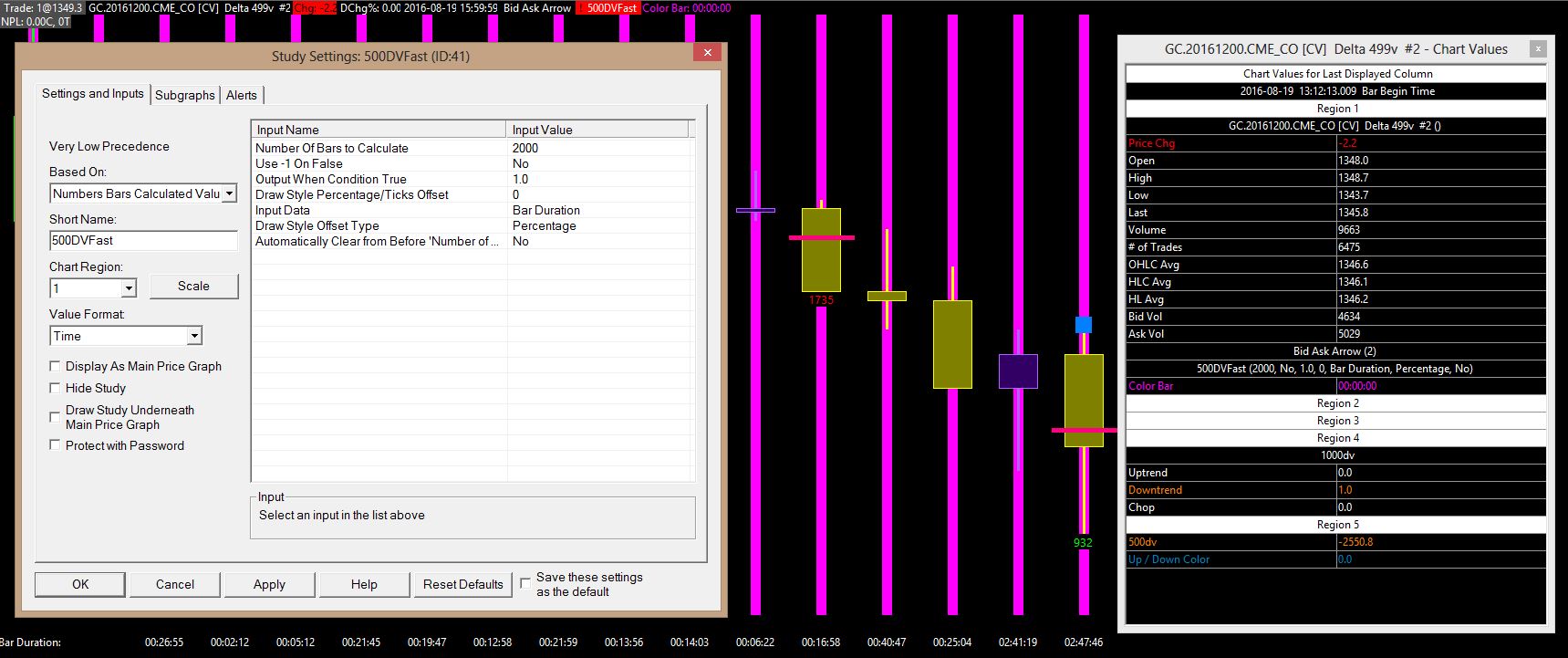

This chart is a 500 Delta Volume per Bar.
The goal is to identify any candle that closes within the specified time.
(ideally it would just be any bar that closes in less than 1 minute).
In the attached image, I want to tag the top left bar that closed in 00:06:22
The alert is configured as
=AND(SG1 > TIME(0, 6, 0), SG1 < TIME(0, 7, 0))
Date Time Of Last Edit: 2016-08-20 23:40:42
imagebarduration.jpg / V - Attached On 2016-08-20 23:39:33 UTC - Size: 104.53 KB - 445 views
[2016-08-21 00:09:02]
Sawtooth - Posts: 4355
To mark the bar that closes in less than 1 minute, try this:
=ID1.SG1<TIMEVALUE("00:01:00")
To mark the bar that closes in between 6 and 7 minutes, try this:
=AND(ID1.SG1>TIMEVALUE("00:06:00"),ID1.SG1<TIMEVALUE("00:07:00"))
Date Time Of Last Edit: 2016-08-21 15:29:53

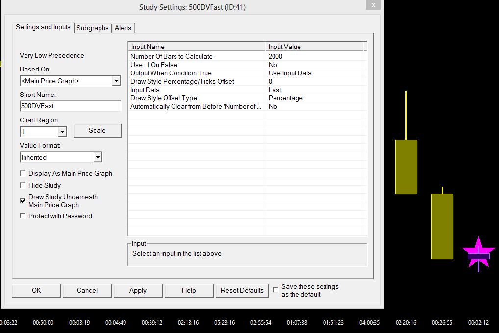

This tags every bar
=ID1.SG30<TIMEVALUE("00:07:00")
This does not tag any bars
=AND(ID1.SG30>TIMEVALUE("00:06:00"),ID1.SG30<TIMEVALUE("00:07:00"))
Date Time Of Last Edit: 2016-08-21 16:35:35
imagebarduration2.jpg / V - Attached On 2016-08-21 16:32:52 UTC - Size: 204.19 KB - 496 views
imagebarduration3.jpg / V - Attached On 2016-08-21 16:32:58 UTC - Size: 113.71 KB - 397 views
[2016-08-21 18:26:46]
Sorry, I tested these formulas using the Bar Time Duration study, not the Numbers Bars Calculated Values study. They work on the former, but not on the latter. This is the case for the both the TIME and TIMEVALUE versions.
They work (using the spreadsheet syntax) in a spreadsheet study when referencing either the Bar Time Duration study or Numbers Bars Calculated Values study, so the format is valid.
Why, as Simple Alert formulas, they work using the Bar Time Duration study, but not on the Numbers Bars Calculated Values study, is a question for Support.
[2016-08-21 19:35:44]
Bedhog - Posts: 187
Excellent - It is working with the Bar Time Duration study. Thank you!
This example will find when a 500-delta-volume-bar bar closes less than 3m.
=ID42.SG1<TIMEVALUE("00:03:00")
imagebarduration4.jpg / V - Attached On 2016-08-21 19:35:40 UTC - Size: 94.73 KB - 415 views
[2016-08-22 00:23:59]
You need to make sure the Numbers Bars Calculated Values study has a Value Format setting of "Time" for this type of formula.
