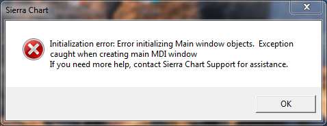

I got a error window after updating. What can I do? I can't open the platform.
imageError Window.png / V - Attached On 2015-07-15 06:36:27 UTC - Size: 33.28 KB - 591 views

crazybears - Posts: 314
HI Sierra Chart Engineering
I have the same problem

[2015-07-15 10:22:18]
This has been solved. You will need to install version 1269 from this page:
https://www.sierrachart.com/index.php?page=doc/download.php#download

We need from one of you, your Sierra3.CFG file so we can duplicate this problem. We were unable to duplicate it, so we could not fix the original problem and had to go back to version 1269.
This file is located in the Sierra Chart main program folder.
Privately attach the file here. The file does not contain any password information.

[2015-07-15 10:50:03]
nicktrader - Posts: 817
I do not have the "damaged" Sierra3.CFG because I solved the "problem" by myself. I installed my previous version and made a transferring as discribed. Sorry

[2015-07-15 10:51:33]
Nevertheless, still attach the Sierra3.CFG file you are currently using and we will see if we can duplicate the problem.
[2015-07-15 10:53:54]
maybe this is the "damaged" because as I know I made a sik copy of the complete folder and than I made the transfer.
Date Time Of Last Edit: 2015-07-15 10:58:16

[2015-07-15 11:48:59]
We still cannot duplicate the problem with this file. So we will have to add some detailed logging to determine what it is.
Hi
just come back home ,attached is Sierra3.cfg file
Private File
[2015-07-15 18:53:49]
Thank you. We still do not see the problem but we will determine the cause of the issue in a different way and solve it.
[2015-07-15 19:21:49]
We still need to do more work to review code to see where the problem could be. It does relate to the new control bar we are developing. There have been some changes already and we would like to know if the problem is still encountered.
Here is a link to the version with the new control bar:
https://www.sierrachart.com/downloads/SierraChartSetupNoCLRPrereleaseTest.exe
We recommend just installing this into another folder and see if you encounter the startup error.
[2015-07-15 19:37:36]
installed into new folder , startup error still present
[2015-07-16 19:59:49]
This problem has now been solved.
