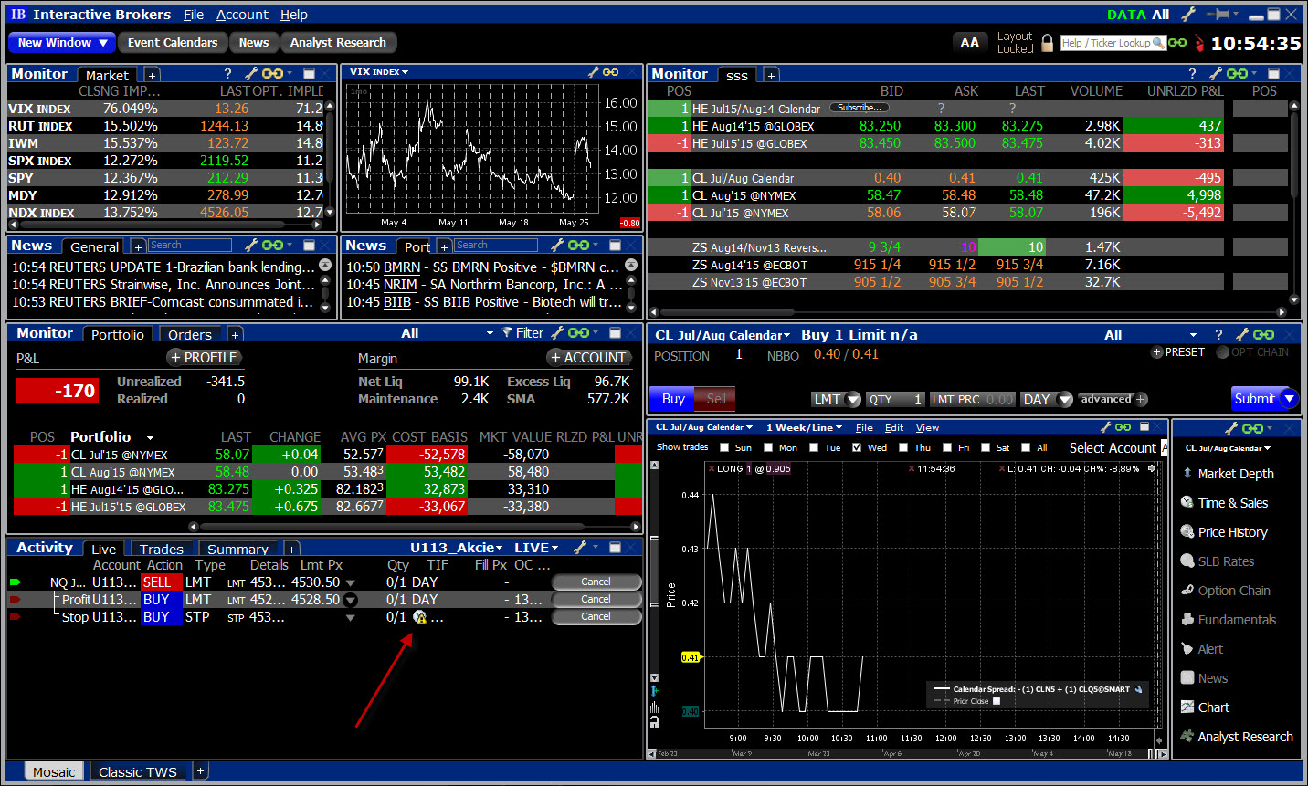

PS:
- My OCO order which I can see on IB platforma (my stop order is added with information: Order can be triggered during the trading hours 17:00CST-15:15CST (15:30CST-16:15 CST).
- The problem does not exist on my SIM account
- The problem does not exist on my IB SIM account
image20150527_01.jpg / V - Attached On 2015-05-27 17:28:51 UTC - Size: 532.93 KB - 604 views

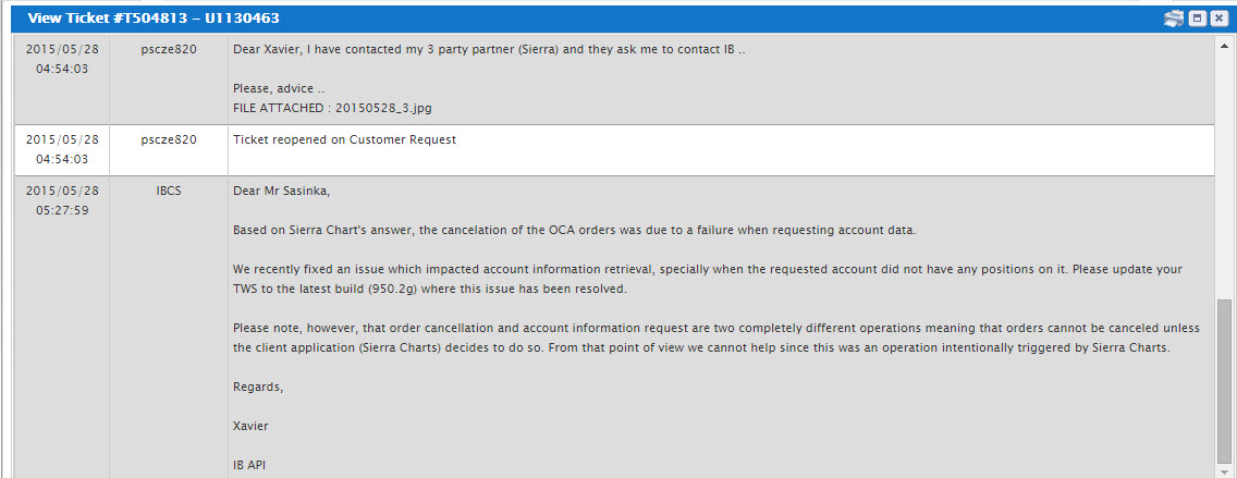

Please, note I contacted them and here is the answer. Anyway, I will do that again after your comments .. (see below)
image20150528_2.jpg / V - Attached On 2015-05-28 08:48:08 UTC - Size: 194.97 KB - 592 views

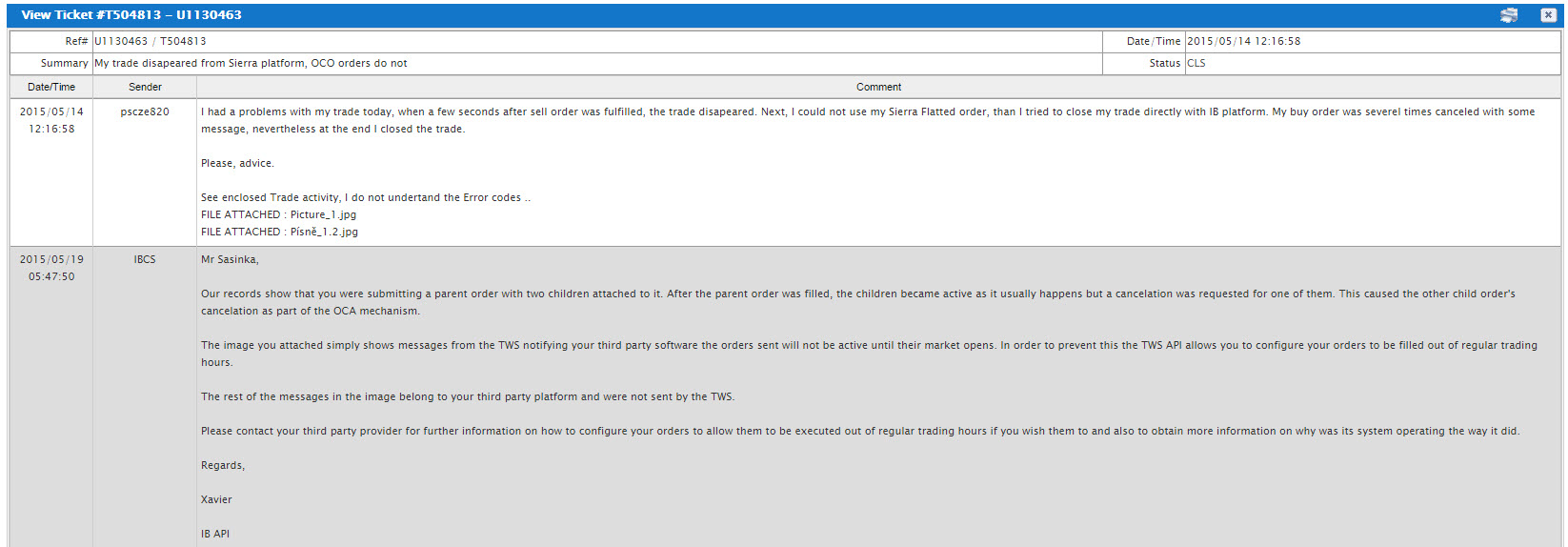

[2015-05-28 09:51:27]
User58159 - Posts: 62
IB wrote, that I have to configure my orders to allow them to be executed out of regular trading hours.
Pls advice ..

[2015-05-28 10:01:58]
IB wrote, that "Our records show that you were submitting a parent order with two children attached to it. Aftre the parrent order was filled, the children became active as it usually happens but a cancelation was requested for one of them. This caused the other child order“s cancelation as part of theOCA mechanism".
This is the truth.
The point is that I cancelled the child because my parent order disapeared on Sierra platform (I was extremely nervous, on Sierra I saw two children orders and the trade disapeared. SO, I planned to decrease the problem.)
Please, advice ..

[2015-05-28 10:18:20]
IB response:
image20150528_4.jpg / V - Attached On 2015-05-28 10:18:14 UTC - Size: 128.74 KB - 591 views
[2015-05-28 10:45:11]
OK good so you just need to update Trader Workstation to 950.2G and the problem will be resolved. Let us know if that helps.
Those OCO orders got canceled when you pressed the Flatten button to flatten the position.
Date Time Of Last Edit: 2015-05-28 10:45:28
