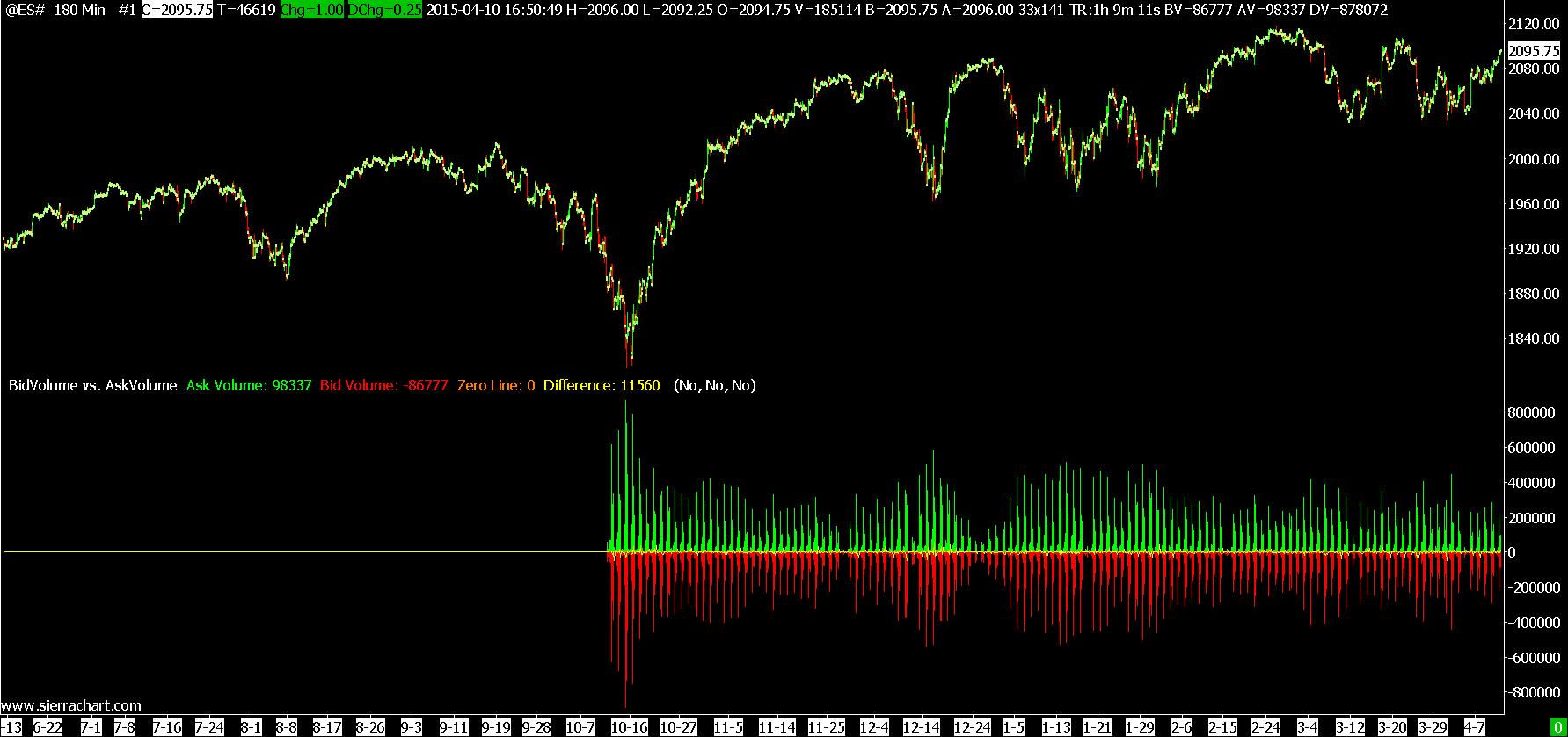

[2015-04-10 20:50:59]
We are testing this now and the earliest tick by tick data we get is:
HD Request # 7 | Timestamp of first Intraday data file record written: 2014-10-12 18:00:00
And this is what was requested from the server:
HD Request # 7 | Requesting Tick data beginning at 2013-10-07 16:44:00 US Eastern Time. | 2015-04-10 16:44:34
Here is the chart:
http://www.sierrachart.com/image.php?l=1428699052943.png
[2015-04-10 21:25:25]
JamesP - Posts: 89
Yeah, I can only load back as far as Oct 12 as well. This only happened this week though. Before this I could load significantly more data, certainly all of 2014 and then some. Do you know what the issue is? Is it on DTN's end, should I contact them? Just curious what has changed here. Thanks.
