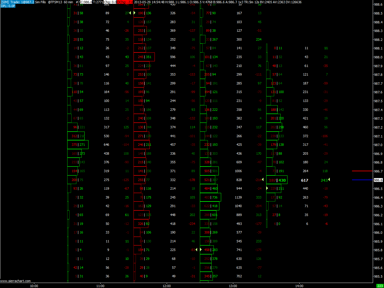

[2013-05-29 20:52:52]
c734xu - Posts: 5
Thank you for your help. I actually have that set but isn't the data (Bid Volume x Ask Volume) cumulative? What I'm looking for is to be able to see that maybe the bid/ask shows 201 x 220 but that 30 more contracts sold into the bid (making it 231) and then 40 into the offer (making it 260) and then 300 into the bid again without having to remember what the number was previously.
I hope this makes sense.
http://www.sierrachart.com/image.php?l=1369861071944.png

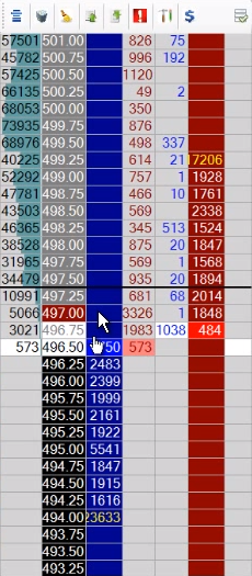

[2013-05-31 05:25:08]
c734xu - Posts: 5
I'll take a look at the Pullback Column but to be more clear, take a look at the attached picture. Just to the right of the white arrow cursor is the number 3326; that's the current volume of contracts traded at the bid, not cumulative. To the far left of the cursor you'll see 5066 which is the total cumulative volume traded at that price. Let's say price moved back up to 1497.75 and then back down to 1497.00; that 3326 would change to however many contracts just traded again, let's say 125. Then, the 5066 would changed to 5191 because it's cumulative but the 3326 is not cumulative but rather the current volume traded at the bid. The blue numbers to the right of the red numbers are the current volume traded at the offer.

[2013-06-03 22:17:07]
OK, this really is not related to Numbers Bars because the way that data is stored and presented is different.
What you are looking for is on the Trade DOM, the amount of bid volume and ask volume for each price level where the market traded at a price and stayed there. When the market goes back to that price, these bid volume and ask volume numbers reset to 0.
[2013-06-03 22:22:58]
We will see about adding this. This probably is not really too difficult to do.

[2013-08-07 22:38:28]
This feature is now available. From release notes:
New Chart/Trade DOM columns: Recent Bid Volume and Recent Ask Volume. These new columns will show the Bid Volume and Ask Volume for each price level where the market traded at before moving to a new price. When the market goes back to a prior price level, the Bid Volume and Ask Volume are reset.
