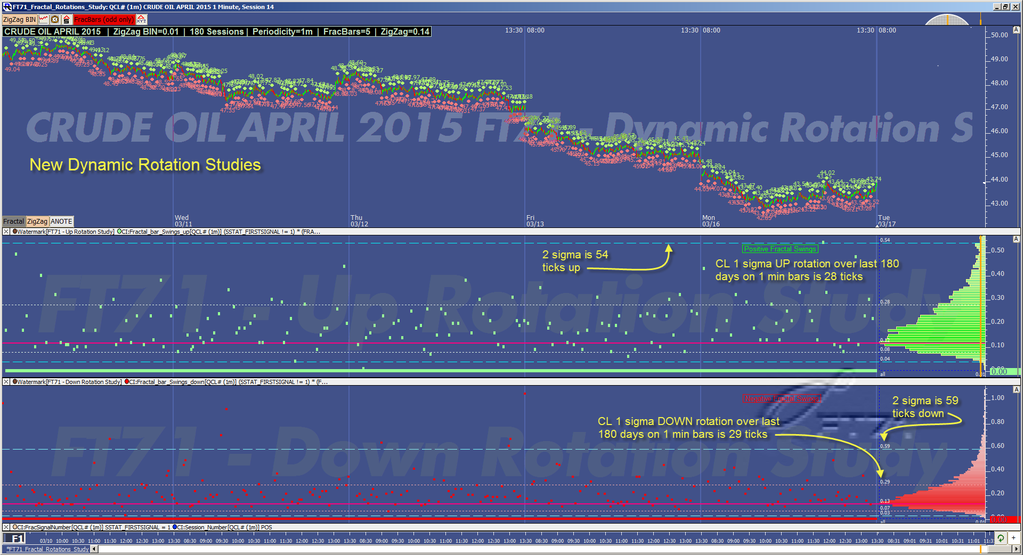

I think SC is the most customisable tool around and I love it. Just wondering if there are any studies around (or planned) similar to the dynamic rotation study being released by IRT. Basically, it's great for statistical risk analysis - eg it shows for the last X days what the 1 and 2 sigma up and down rotations have been for a particular chosen symbol. I've attached FT71's pic explaining it better than I could. I have searched in the user studies but I haven't found anything like this yet |

SC would have to extend the Volume By Price study to allow other inputs for drawing the histogram. At the moment, it uses the Price and Volume-At-Price as inputs. There are other inputs it takes from the Main Graph but those can be ignored for this discussion. SC would have to allow any two subgraphs of a study (one in place of the Price data, the other in place of the Volume-At-Price numbers) to be used as the inputs to the Volume By Price or a similar SC created study. Then any user who is willing to use ACSIL to create the subgraph data would be able to create the study in the picture above. You would also need a way to ignore any prices that have zero volume so that the histogram would not have any empty bars (horizontal volume at price bars) in the histogram. This would require SC's help so that the whole setup can be done in an efficient manner. This would also allow enough flexibility to plot pretty much any data in real-time, not just the rotations data. Just a thought. |
