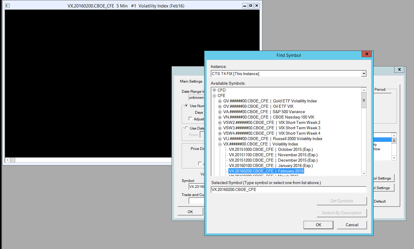

[2016-02-14 01:17:22]
ejtrader - Posts: 689
SC Team - I am trying to plot the VIX symbol from CTS and not receiving any historical or realtime data.
Would you please confirm the symbol to use for CTS?
For SC All data service - $VIX symbol would work. But trying to find the equivalent symbol that I can use for realtime with CTS. I have performed full symbol reset as well to see if I can get the data.
Also - I have the CFE data enabled for my CTS account.
Date Time Of Last Edit: 2016-02-14 01:18:04
imageSC_VIX_Symbol_issue.jpg / V - Attached On 2016-02-14 01:17:16 UTC - Size: 231.34 KB - 567 views
[2016-02-14 01:31:58]
Looking further on the message log - it appears like - exchange is not allowed for user. Wondering which is the other exchange I am supposed to have enabled. is it CBOE or CFE? I have both CBOE & CFE enabled but individually. don't see an exchange called CBOE_CFE exchange on the CTS side to enable. If everything is correct on sierra side, I would check with CTS support.
CTS T4 FIX | Sending security definition request for symbol VX.20160200.CBOE_CFE | 2016-02-13 19:26:50
CTS T4 FIX | Received matching security definition for symbol VX.20160200.CBOE_CFE. Subscribing to data. | 2016-02-13 19:26:50
CTS T4 FIX | Received 1 security definitions for underlying symbol VX | 2016-02-13 19:26:50
Symbol Error - VX.20160200.CBOE_CFE is unknown, unavailable, or improperly formatted. CTS FIX: Received market data reject: (3) Exchange is not allowed for User | 2016-02-13 19:26:50
Date Time Of Last Edit: 2016-02-14 01:32:45

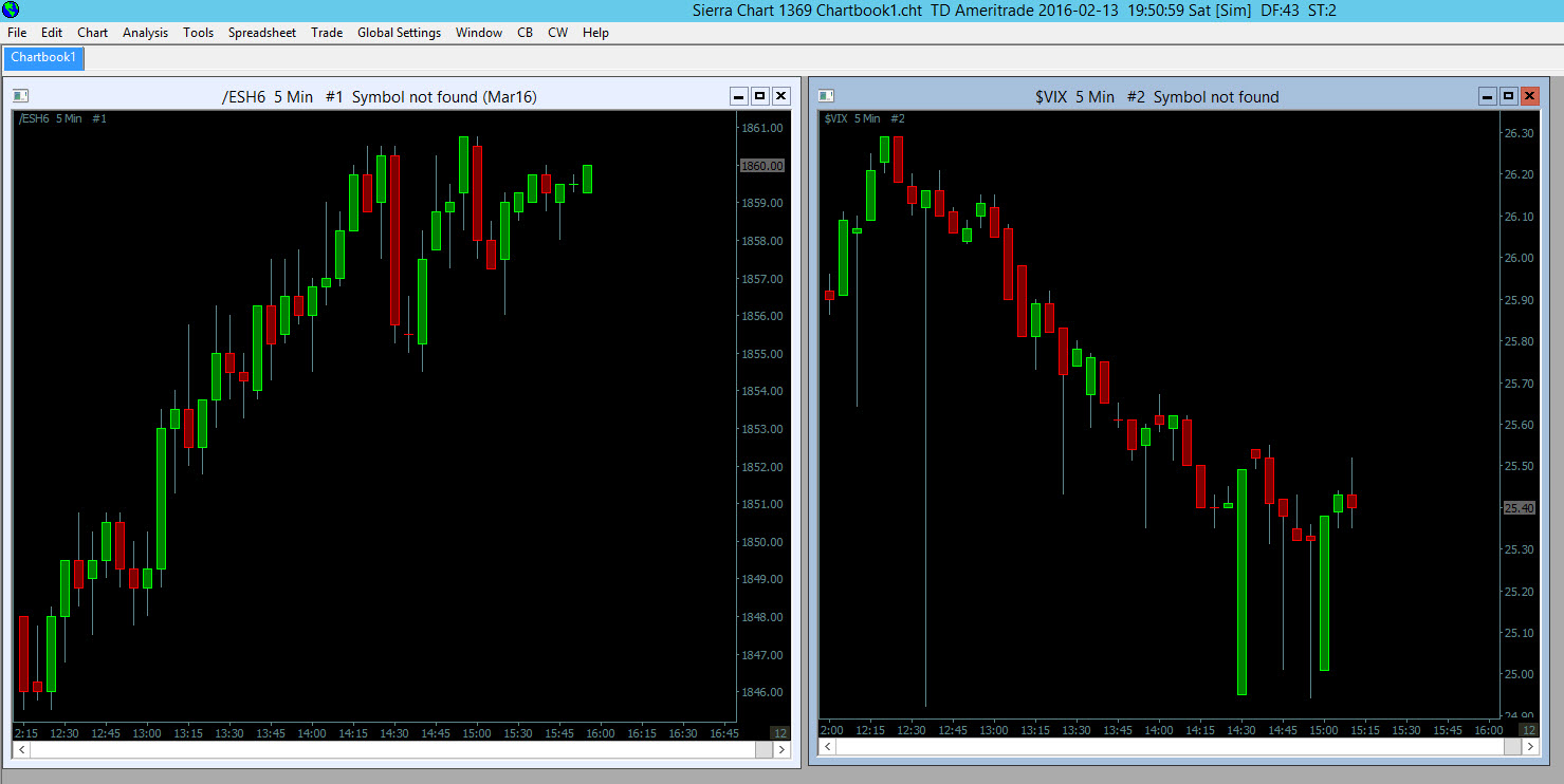

On the same note ( with the intention of receiving $VIX) I tried to use TD ameritrade( ThinkorSwim) platform for the first time with SC.
I get the data but receive symbol not found message. Is this a supported feed for the symbols listed ( /ES & $VIX - as per the image?)
I did the full symbol reset as well for this.
Date Time Of Last Edit: 2016-02-14 01:56:17
imageSC_TD_TOS_Symbol_NOT_FOUND.jpg / V - Attached On 2016-02-14 01:54:22 UTC - Size: 210.95 KB - 390 views
[2016-02-14 04:56:23]
Update on TDAmeritrade(TOS) - I could get the $VIX.X - plotted and this didn't give me the "symbol not found" message.
However the ES ( /ESH6) - it has the Symbol not found message. Wondering if this is anything to do with the Windows file name convention to allow "/" as part of the scid file as a prefix.
imageSC_TD_TOS_Symbol_NOT_FOUND2.jpg / V - Attached On 2016-02-14 04:55:29 UTC - Size: 354.87 KB - 408 views
[2016-02-16 03:07:15]
Refer to this page here for information about futures data through TD Ameritrade:
https://www.sierrachart.com/index.php?page=doc/AmeriTrade.php

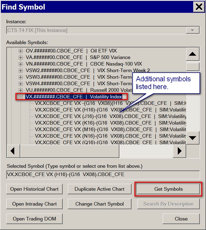

[2016-02-21 00:48:43]
Yes. We will be taking care of this before Monday. We are marking it as a follow-up.
[2016-02-21 18:21:49]
Update the Symbol Settings through Global Settings >> Symbol Settings.
When this is done go to File >> Find Symbol. You can now search on the CTS system for the available VX symbols as this attached screenshot shows.
imageCTSFIX_AdditionalSymbols.png / V - Attached On 2016-02-21 18:20:46 UTC - Size: 22.18 KB - 390 views

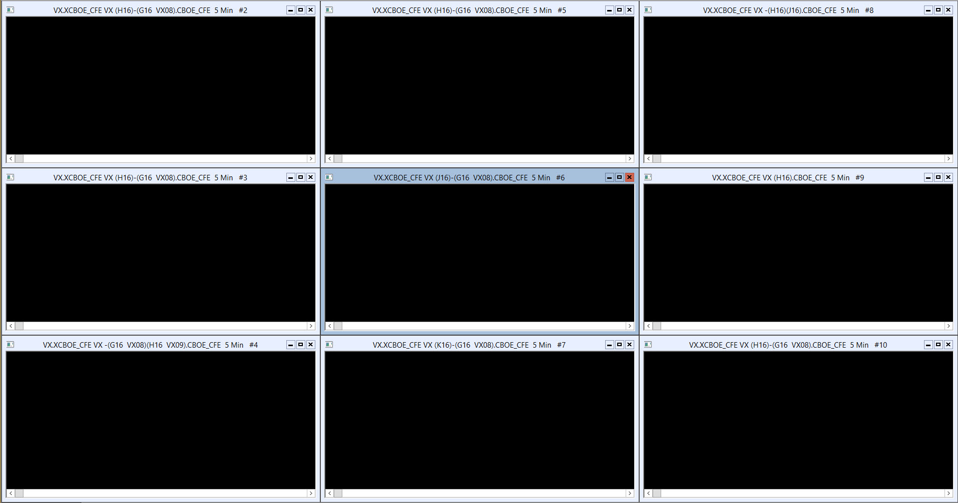

[2016-02-21 18:47:48]
SC Team - Would you please see if you can actually get the data for any of those symbols?
I am currently on version 1371 and tried the method you have described. All the symbols - gets no data. There are no errors in log file.
Any specific VIX symbol for which you can get at present?
thanks
Date Time Of Last Edit: 2016-02-21 19:38:52
imageSC_CTS_Vix_issue.jpg / V - Attached On 2016-02-21 18:48:02 UTC - Size: 419.32 KB - 367 views
[2016-02-22 14:34:19]
Was hoping - atleast realtime data would come up during RTH hours (if not historical) - but no luck.
imageSC_CTS_Vix_issue2.jpg / V - Attached On 2016-02-22 14:33:53 UTC - Size: 233.86 KB - 357 views

[2016-02-22 21:46:43]
Open a chart for one of the VX outright futures contracts.
Both of these are spreads.
