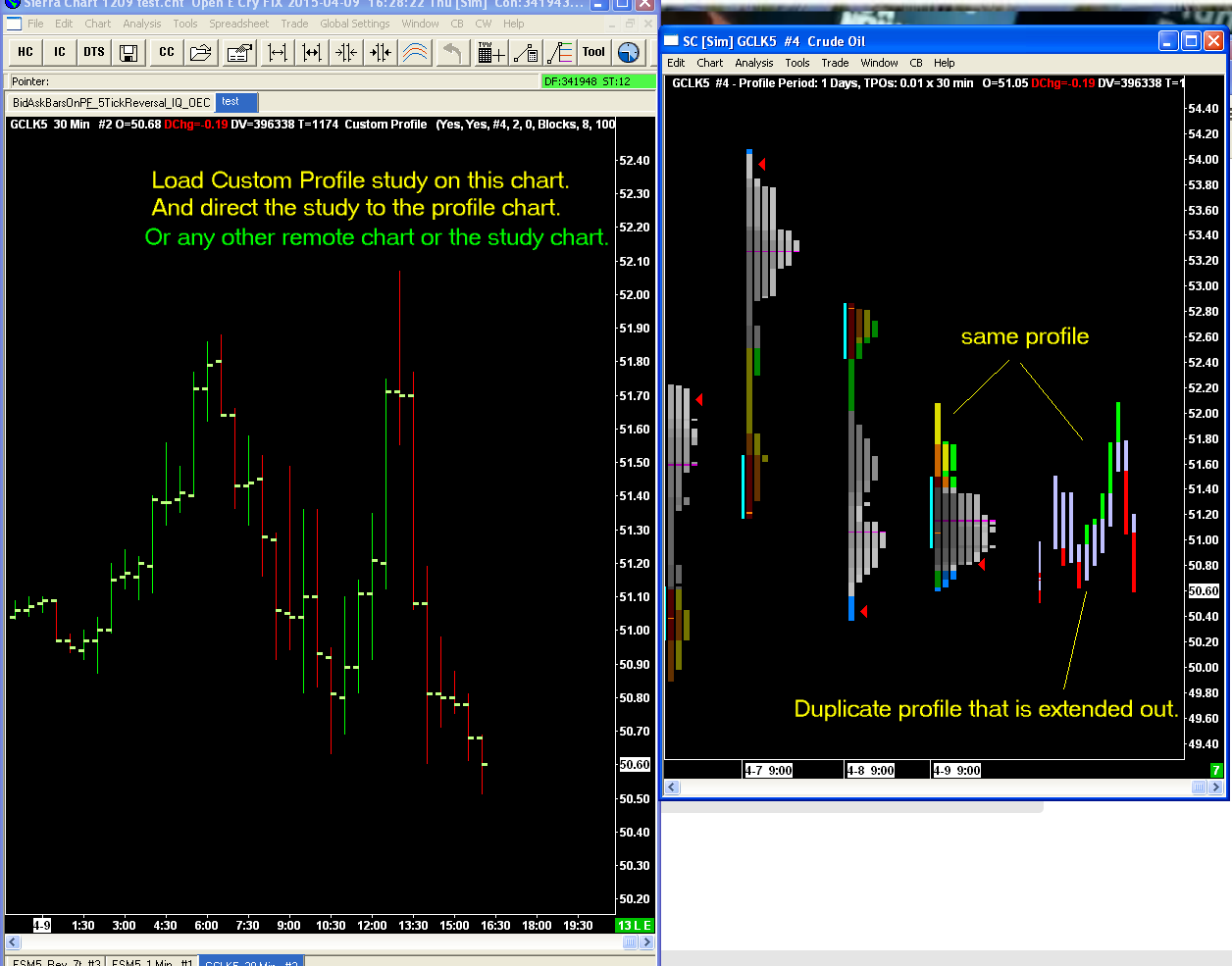

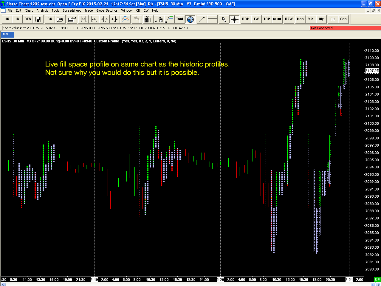

Here is a study that will create a second profile in the chart fill space after the last bar or profile. You can expand the profile or leave it as a regular profile. The bars are also color coded so breakouts and trends can be easily seen. Letters or blocks can be selected.
Just load the study on a bar chart that has the time frame you would like the profile to be in (usually 30 minutes) then direct the study to the chart that you want the profile to be displayed. So you can put a profile on any type of chart or you can combine time frames.
Maker sure the bar chart has the correct start and end times.

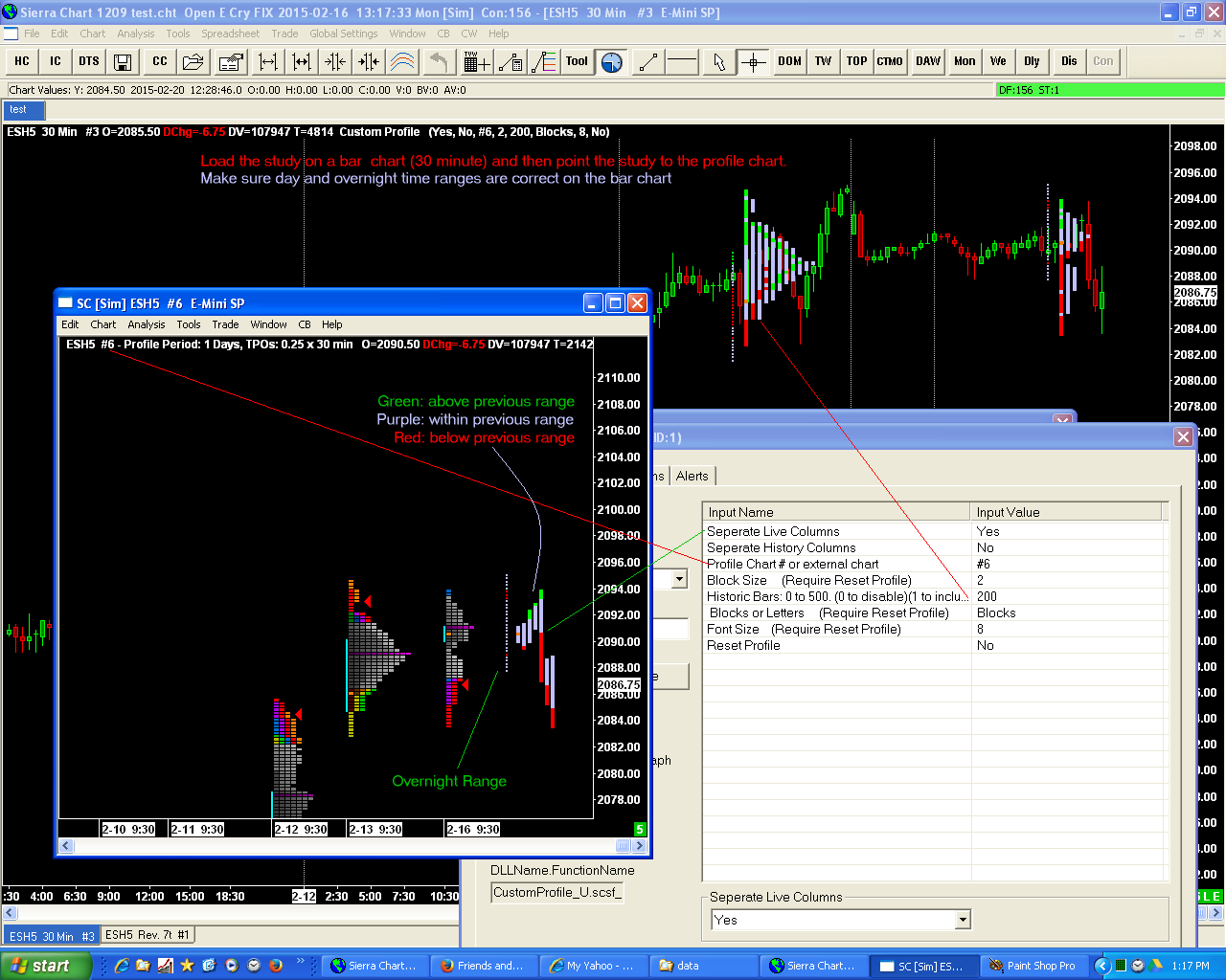

if i apply on ES with full session the profile is shown , if i use on a chart without evening session or on another instrument ,e.g CL this is the result:
http://www.sierrachart.com/image.php?l=1424442115130.png
[2015-02-20 15:23:52]
WarriorTrader - Posts: 259
Crazybears,
You should use two charts. One that has the full session (overnight included) and one that you want the current day's profile displayed on. And make sure the start and end times are correct on the first chart that has the Custom Profile study loaded.
It looks like you are trying to display the profile on the chart that has the study. That's why you have two lines for the first period. Theoretical using only one chart will work but I designed it to use two charts. You also will not be able to see the line that has the overnight range using only one chart.
For the time 9:23 that picture looks right, but for two lines showing up instead of one.
--WT
Let me know if that worked.

Let me clarify. The Custom Profile will display a profile for the current day session and a vertical line to mark the overnight range. It uses the start and end times you have set for the "Session Times" section in your chart settings.
It will also display historical profiles on the bar chart that has the study loaded. I originally wrote it to display an extra profile on an already existing TPO Chart so you can see each period expanded while looking at the TPO profile which is not expanded. But there are many possibilities even if you are not using a TPO Chart, I just have not thought of the different ways of using the study.

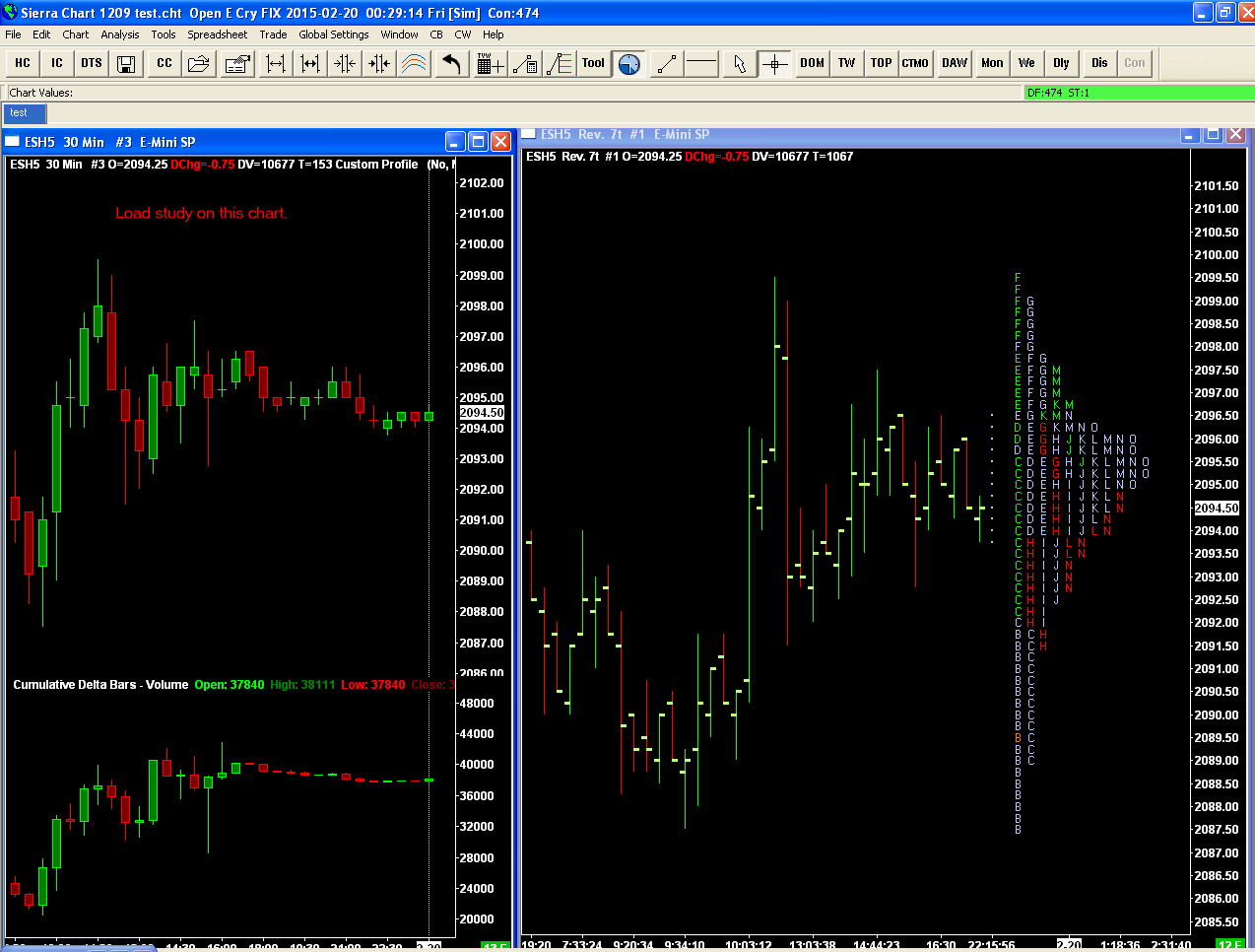

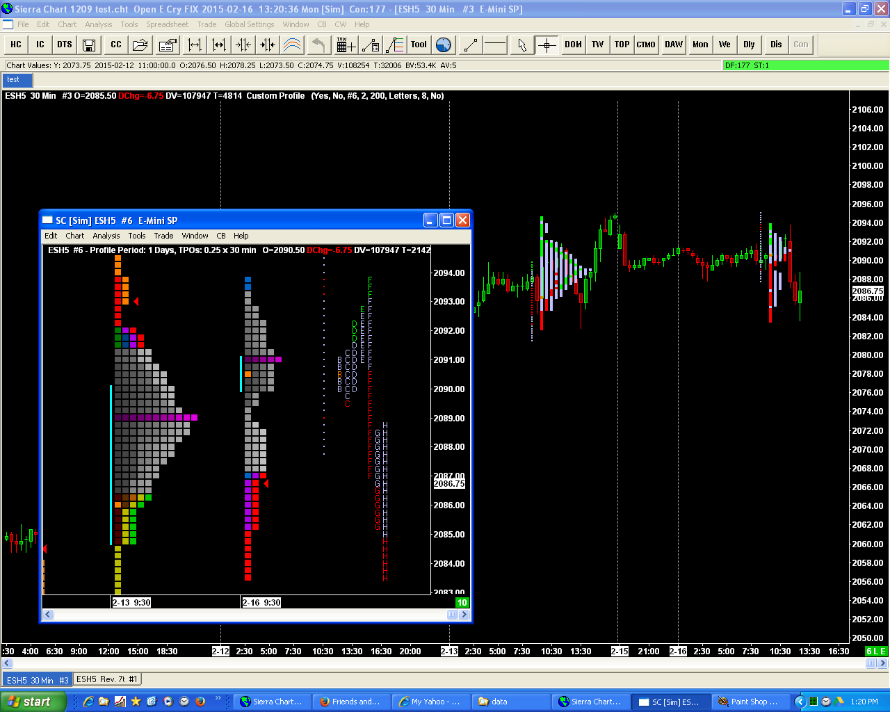

This version will delete the profiles if the study is removed. I also clarified the study setting descriptions.
The study uses Global Variables which means you should only use it on one symbol. I will change this later on when I have the time or if people request it.

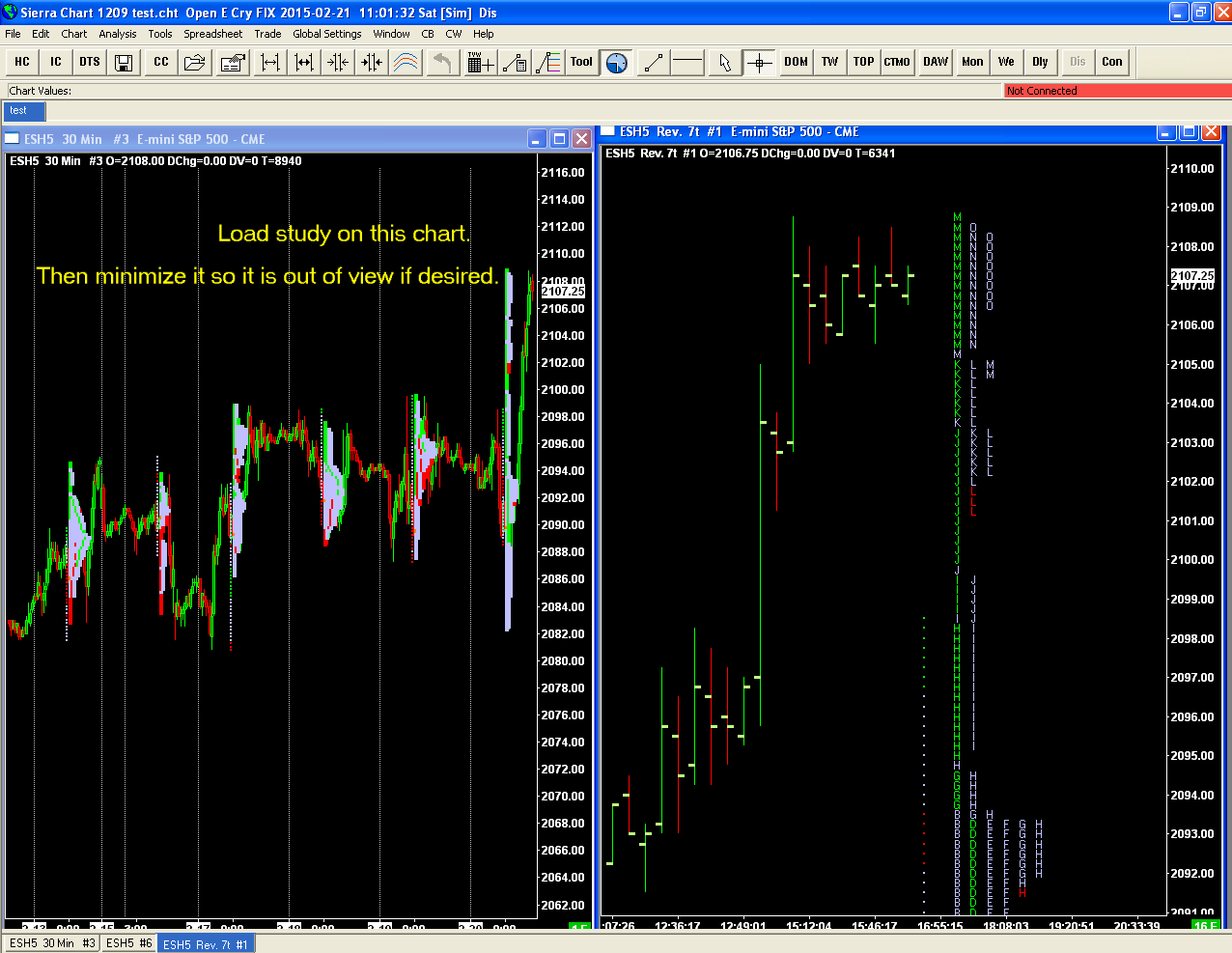

Here is an updated version. Enjoy.
