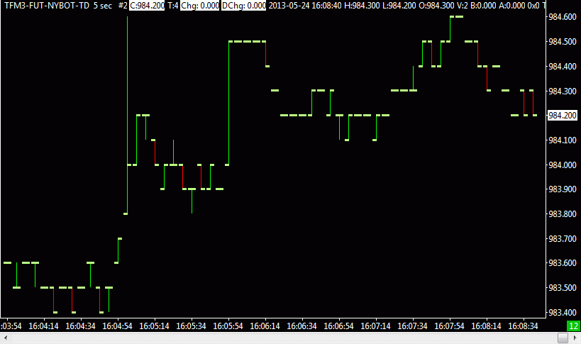

How do I get time line to display timestamps for seconds at 0, 5, 10, 15 and so on? This is IB true-data.

What is the Start Time in the Chart Settings? As long as the seconds start at :00, then you will have to ask Interactive Brokers about this.
[2013-05-25 05:35:11]
TPeirce - Posts: 27
The example pictured is from version 967. Yet in version 760 the same data file shows the correct timestamps. In both instances the start time is 00:00:00.

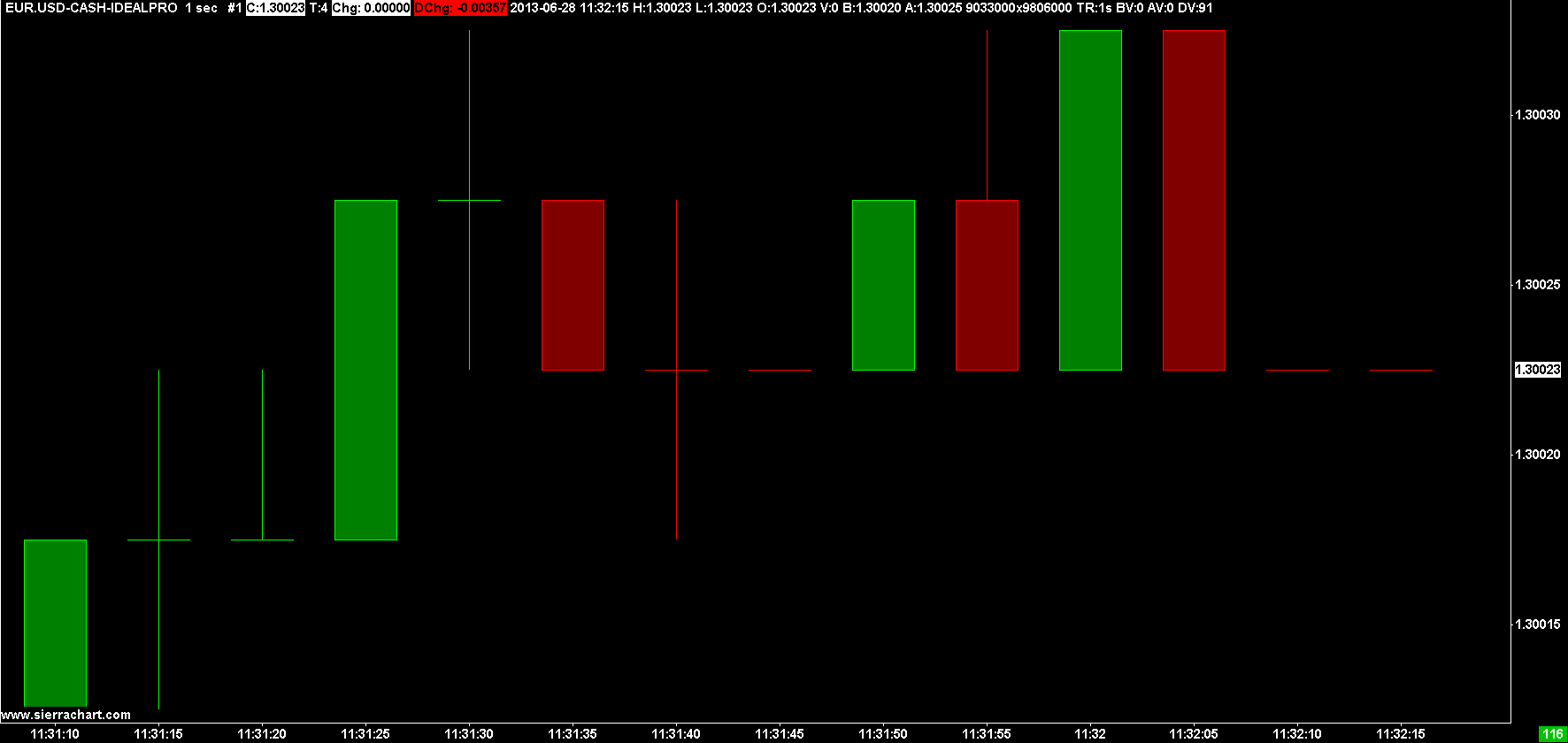

We got the information. Thank you. Here is a chart using 5 seconds data:
http://www.sierrachart.com/image.php?l=1372433541339.png
Timestamps are to times which are a multiple of 5.
[2013-06-28 15:36:14]
Not sure this matters but remove the -TD suffix from the symbol and make sure Global Settings >> Data/Trade Service Settings >> More Interactive Brokers Settings >> Record True Real-Time Data in Intraday Charts is enabled.
This is what we are using.
We see a new bar appear every 5 seconds.
Date Time Of Last Edit: 2013-06-28 21:01:04

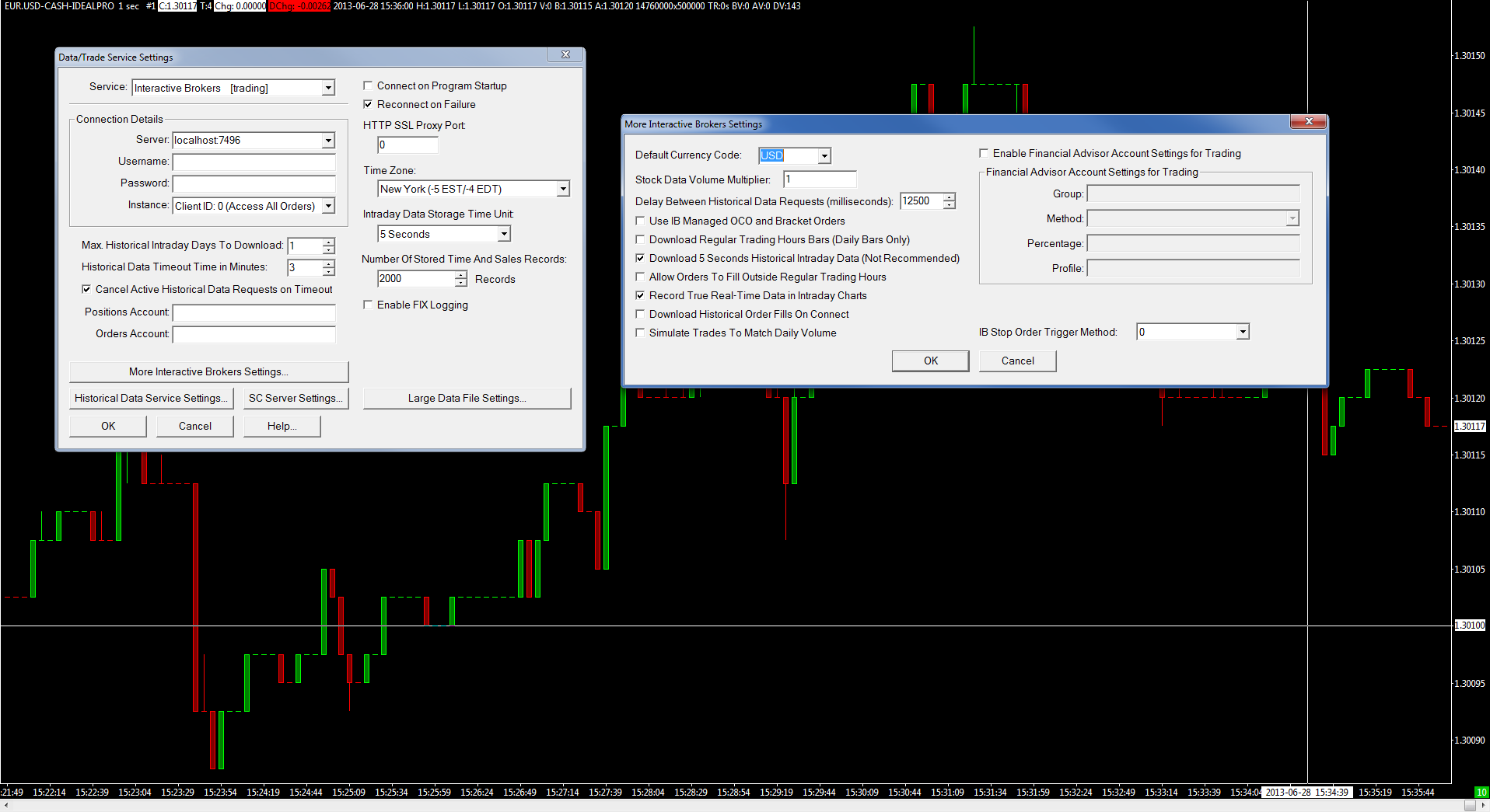

Attached is a screen capture from 982 with data settings panels. The timeline can appear to be good in one portion of the day and bad in another. Have you scrolled to other times of the day? I would be interested to review the file myself if posted here. The earlier version of Sierra Chart (760) that is working here does not have the option in post #17. Also have removed the -TD extension.

We can collect data for a day and give you the file. We will do this in the coming week.
Even though you see the timestamps a certain way in the prior version and not in the current version does not mean that the something has changed within Sierra Chart. Probably the older version is using a different TWS protocol version. Mainly the only changes with the protocol are with the version numbers. So that really should not matter but we have no idea since we do not know how TWS internally works.
