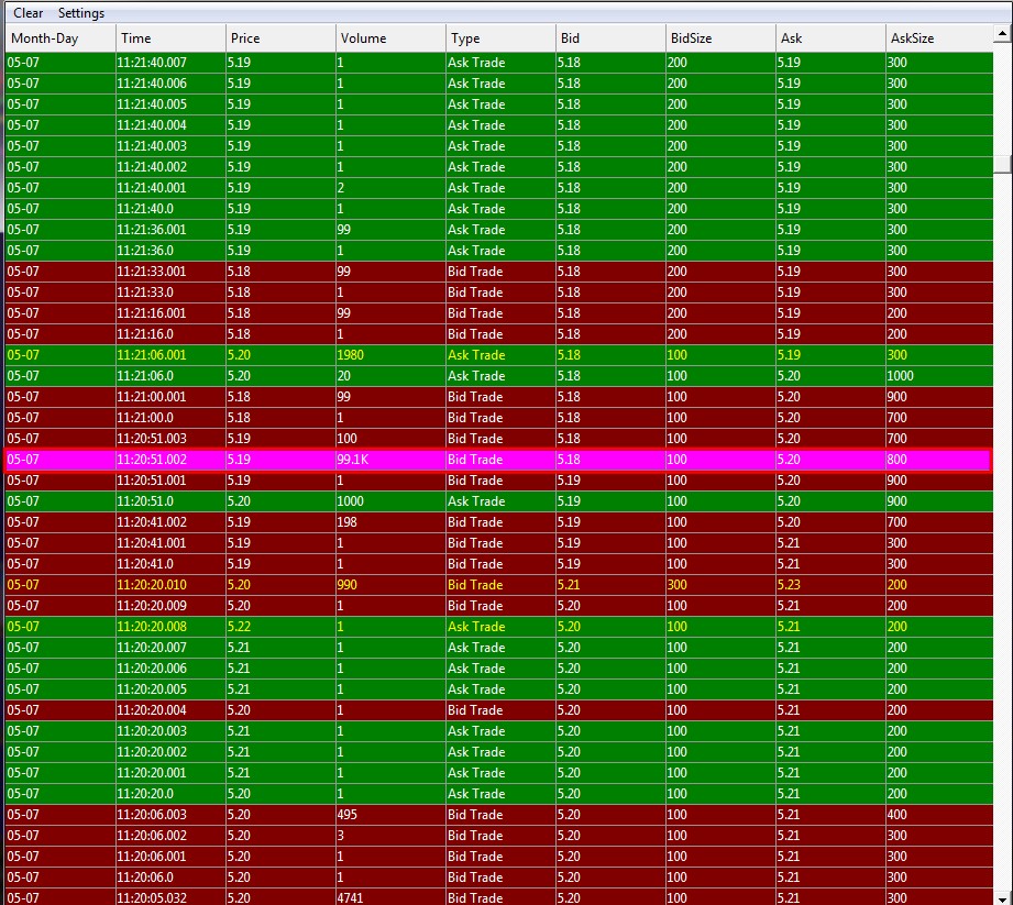

Hi, so I encountered a troubling inconsistency today with how both TD Ameritrade and Sierra are relaying Volume at Bid/Offer data.
I've attached the T&S windows for both platforms that show that Ameritrade listed this 100k trade on the Offer while Sierra listed it on the Bid.
Which is correct..and why?

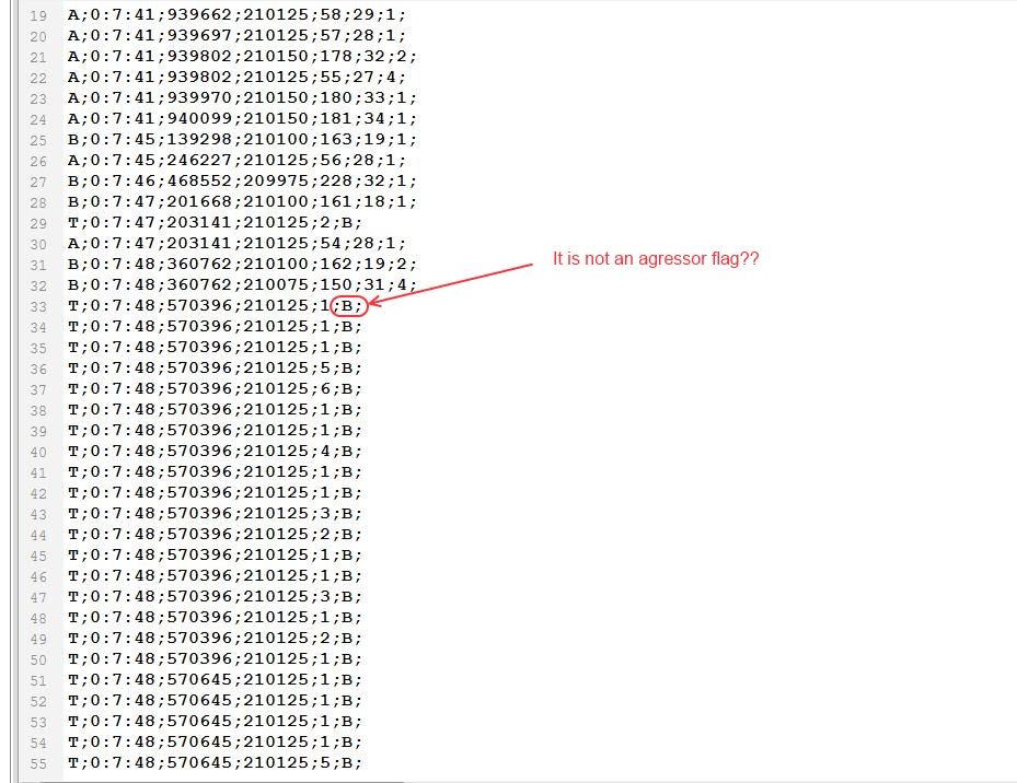

norvik_ - Posts: 106
Rithmic filters this out and we have never seen any data feed which passes this information through other than CTS.
I attached screen with row data from Rithmic API. Can you explain?

In response to post #12, there are several things to be aware of.
The data feed Sierra Chart receives from TD Ameritrade, almost certainly is different compared to the data feed used in their own software.
TD Ameritrade does not indicate in the data feed that Sierra Chart uses, whether a trade occurred at the Bid or Ask. It is determined according to these rules:

In response to post #13, recent versions of Sierra Chart do use the flag from Rithmic indicating whether the trade occurred at the bid or ask. Apparently Rithmic added that field sometime after the integration to Rithmic was originally done.
