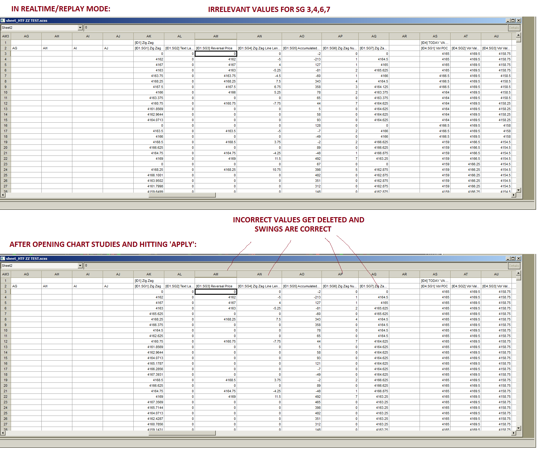

there is a behaviour in the ZigZag study that makes it impossible to create anything useful from it. see attached.
I notice the same behaviour in Swing Hi/Lo study.
imageZIGZAG NEEDS SERIOUS HELP.png / V - Attached On 2014-11-05 22:21:00 UTC - Size: 128.31 KB - 886 views

jivetrader - Posts: 410
@40winks
thank you for trying to help, it is much appreciated
Number of Bars Required for Reversal: is only relevant for ZZ mode 2 (i am using mode 1)
were you able to understand from the screenshot that the issue is related to ZZ printing unconfirmed values? see cells AM7, AM9, AN7, AN9, AN10 ....many others. these values are INCORRECT and get magically auto-eliminated once the Chart Studies page is opened and closed (refreshed) [F6].
for those struggling with studies like these swing-based studies that need manual refreshing, you can either open the studies window and close it (to refresh your chart) or just press the INSERT key (Recalclate) and old, irrelevant, half-painted values will be removed.
the reason i feel the issue is serious is that calculations (like spreadsheet calculations) cannot be based on these studies, since the studies show incorrect, temporary values until you manually refresh them. thus if i want to compare the most recent swing length to the prior swing length, it may be comparing temporary values that in actuality were not finished swings.
