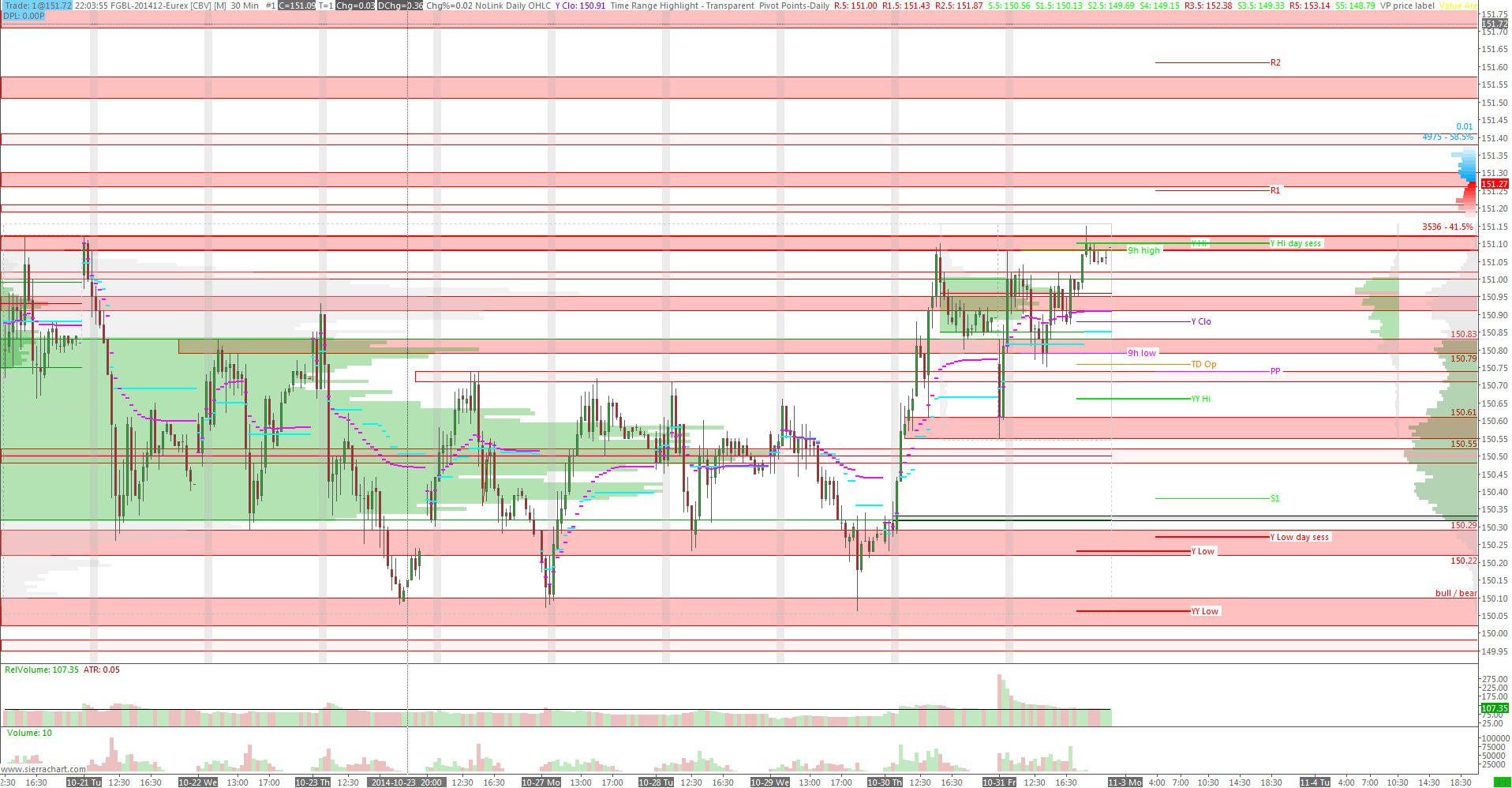

I have tried deleting and downloading data etc but still I can not get most recent bars.
what else might be the reason?
happens only for FGBL. No other symbol.
http://www.sierrachart.com/image.php?l=1415000186730.png
Date Time Of Last Edit: 2014-11-03 07:46:55

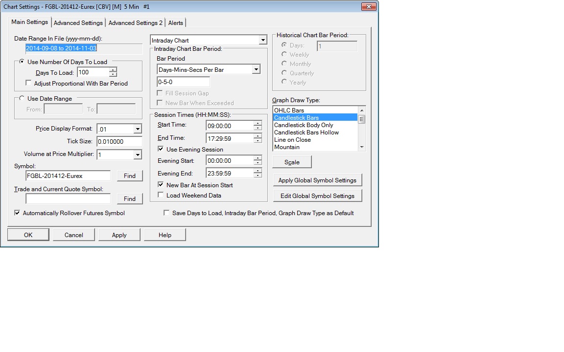

see my settings. I do change the time zone twice a day. to NY in the (european) afternoon and then back to Brussel. Can this be a problem? but if then it should also be for other symbols, shouldnt it?
when I close SC and start new all charts show "wating to download ..." in yellow. only fgbl shows "downloading continous data" in blue. after starting SC it works now again. hm, will see how long.
Date Time Of Last Edit: 2014-11-03 08:56:39
imagefgbl.jpg / V - Attached On 2014-11-03 08:52:33 UTC - Size: 152.69 KB - 512 views
[2014-11-03 09:09:54]
With the Session Times you have shown in that chart, there should not be a problem right now.
Are you aware that you can set a time zone individually for charts and not globally. Refer to:
http://www.sierrachart.com/index.php?page=doc/doc_TimeZone.html
[2014-11-03 09:22:15]
AKR - Posts: 543
oh, no did not know. great thing will check out !! thx

Also, this image is so complex it is not helpful to us:
