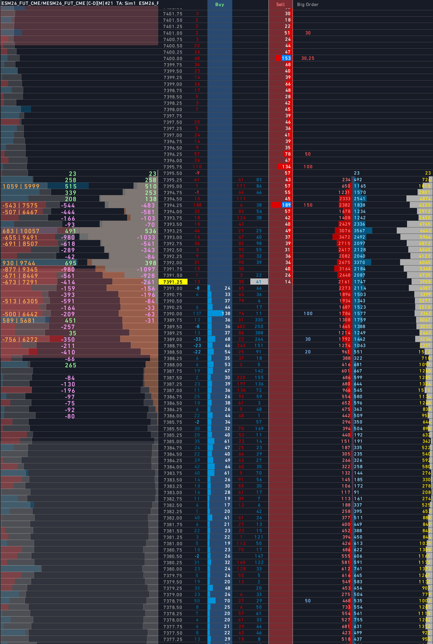

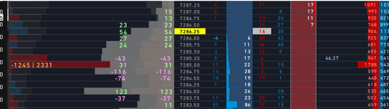

limit order is 10-20,but MBO shows 46 and more

ESM26. Sometimes wrong, but most time it is correct. Now it is right,but that error case had happend third time.
https://www.sierrachart.com/image.php?Image=1781035247934.png

User907968 - Posts: 885
Noticed similar with NQM26-CME on occasions today and yesterday - the MBO orders total exceeded the limit orders shown at price.

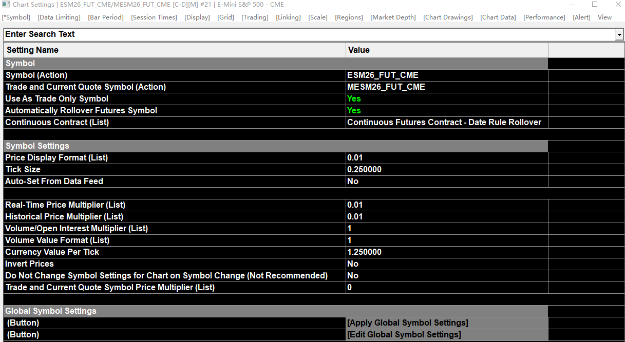

We see that you are using a "Trade and Current Quote Symbol". For that chart, what is "Chart >> Chart Settings >> Symbol >> Use as Trade Only Symbol" set to?
We wonder if you have "Use as Trade Only Symbol" set to "No", in which case the Market Depth data you are seeing for the Bid/Ask is actually from the MES symbol and not for the ES. But the MBO data is for the ES. This would explain the discrepancy.
[2026-06-09 21:33:06]
User682437 - Posts: 6
NO, my setting is "Yes"
