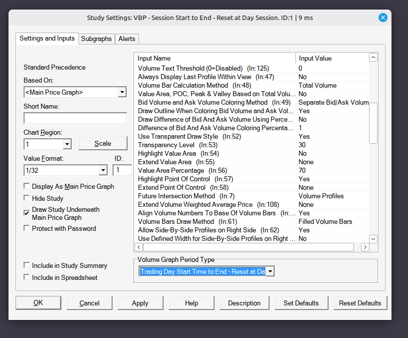

On the DOM I have the Volume by Price study set to reset on RTH. Works fine in 2915 but 2916 shows from Overnight as well.

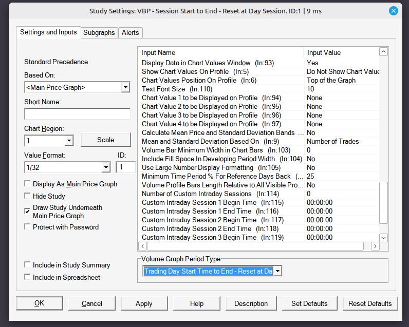

What is the "Volume Graph Period Type" set to for your Volume by Price study? And also give us any other Inputs related to determining the period.

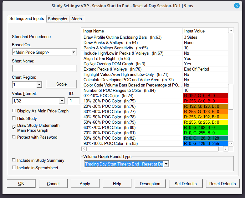

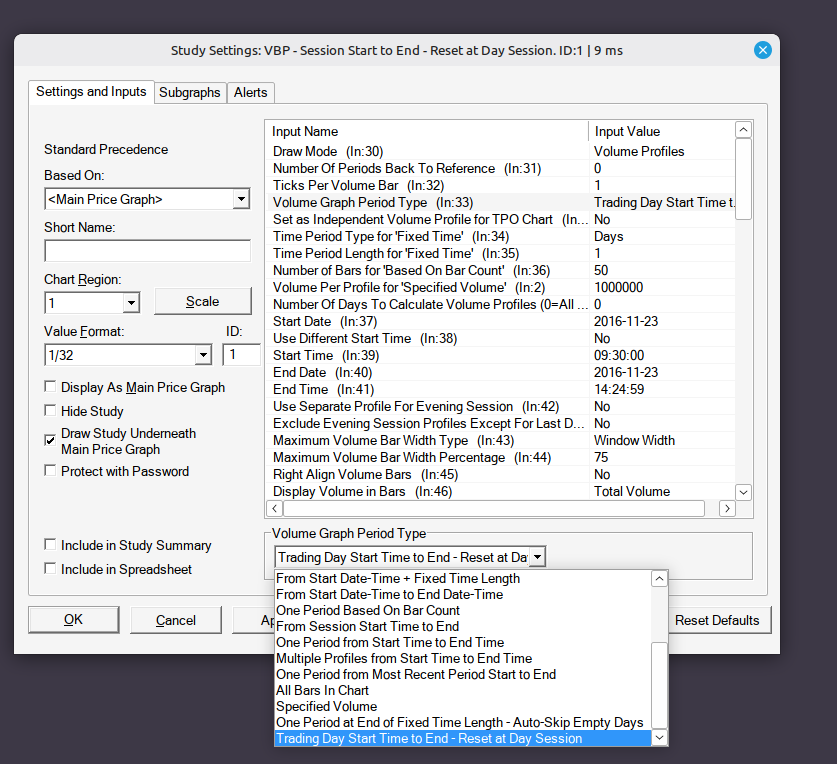

User165981 - Posts: 66
Attached are screenshots of the settings
imageScreenshot from 2026-06-04 17-42-18.png / V - Attached On 2026-06-04 21:45:11 UTC - Size: 129.5 KB - 103 views
imageScreenshot from 2026-06-04 17-44-01.png / V - Attached On 2026-06-04 21:45:20 UTC - Size: 107.62 KB - 154 views
[2026-06-04 21:46:43]
File attached
imageScreenshot from 2026-06-04 17-44-15.png / V - Attached On 2026-06-04 21:46:33 UTC - Size: 110.7 KB - 92 views
imageScreenshot from 2026-06-04 17-44-32.png / V - Attached On 2026-06-04 21:46:37 UTC - Size: 110.59 KB - 111 views

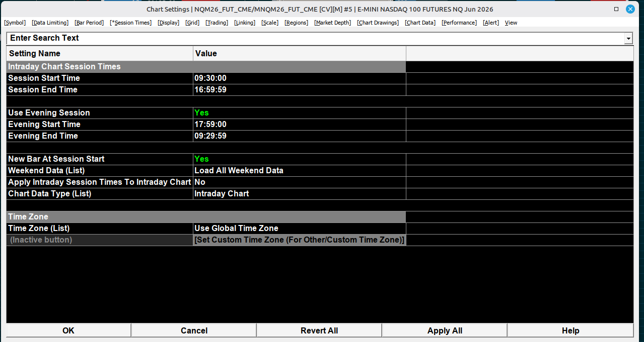

Sierra_Chart Engineering - Posts: 25491
What are the Chart Session Times set to.
We have worked on that particular Volume Graph Period Type, fixing an issue related to it. We did test it though. But maybe there is a scenario we do not consider.
Here's session times
imageScreenshot from 2026-06-04 20-24-26.png / V - Attached On 2026-06-05 00:24:50 UTC - Size: 67.23 KB - 119 views
[2026-06-05 01:52:08]
We see what the problem is. This will be resolved in the next release. This should be out, by tomorrow morning. This will be the prerelease .
