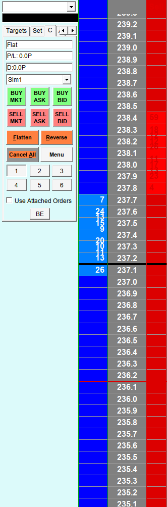

I recently subscribed to the Denali EUREX EOBI data feed and opened several DOMs. I am currently experiencing two issues:
1. On the FESBM26-EUREX[M] DOM, the bid/ask depth quantities are displaying abnormally, as shown in the screenshot below.

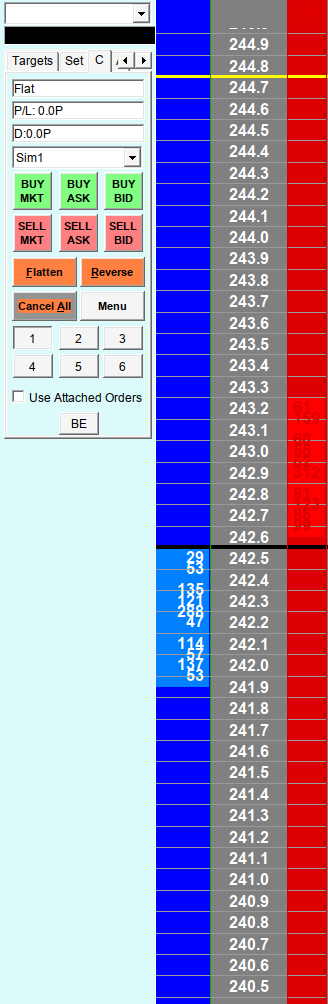

2. On the FDXMM26-EUREX[M] DOM, the quantities appear unusually low. I also checked the FDAX, and the quantities there seem abnormally low as well. I am unsure what could be causing this issue.
1. https://www.sierrachart.com/image.php?Image=1775038810211.png
2. https://www.sierrachart.com/image.php?Image=1775038864299.png

[2026-04-01 16:16:16]
Sierra_Chart Engineering - Posts: 25489
Problems like this would be due to packet loss and we checked and there is 0% packet loss today with EUREX. It is also very unusual to see a packet loss problem with EUREX.
So therefore the data must be correct.

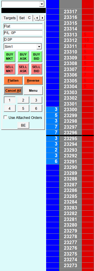

Any idea why the depth levels are not fitting properly within the column cells ?
I encounter this problem only with the FESBM26-EUREX[M] DOM
https://www.sierrachart.com/image.php?Image=1775111051226.png
[2026-04-02 12:52:52]
We have the Tick Size for this futures product set incorrectly. We are fixing this now. It needs to be .05.
[2026-04-02 13:15:28]
This is resolved.
Also follow these instructions:
Global Symbol Settings: Update/Apply Symbol Settings to Charts
