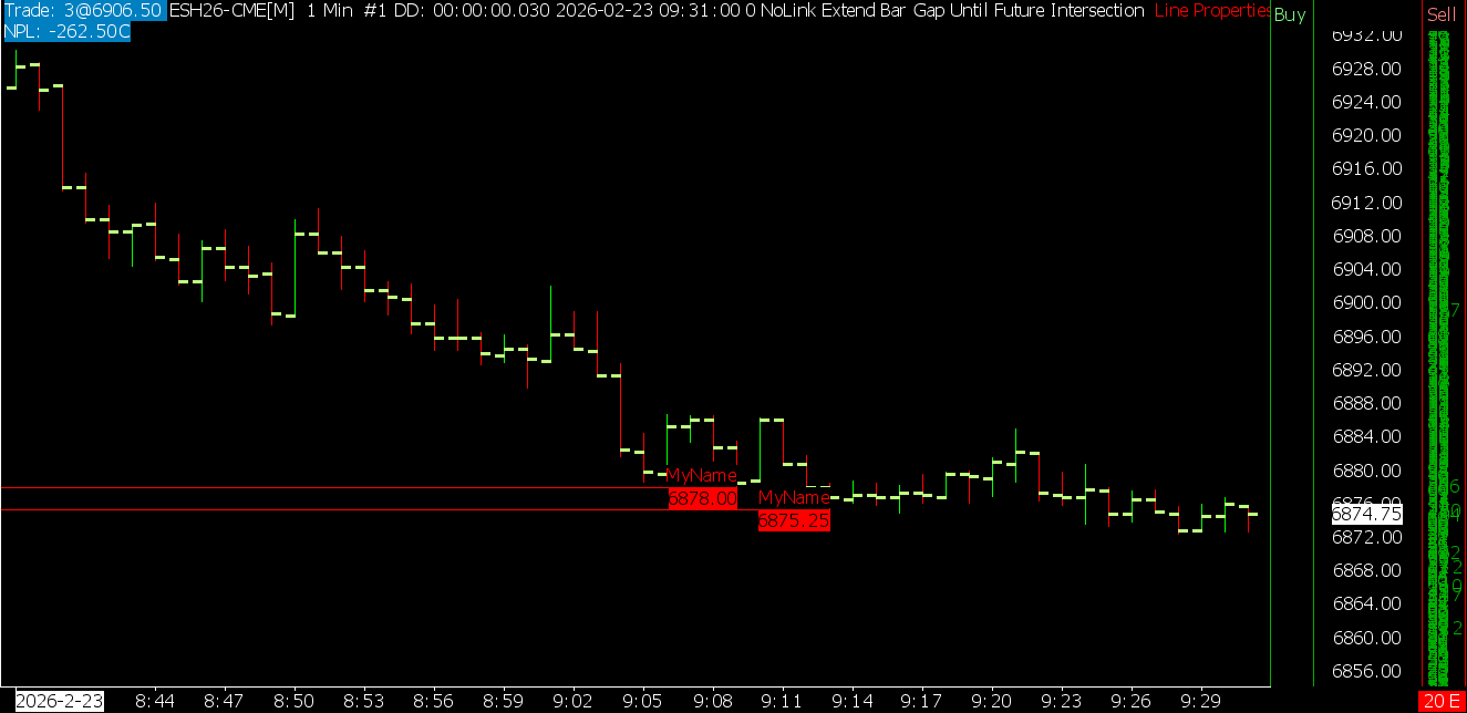

I get no Label Name.
[2026-02-23 17:14:36]
If you enter a "Label Name" then it should show at the point where the line gets intersected, and be above the Price Label if you have that set to display as well. The attached image shows what you should be seeing.
If this is not what you see, then we need an image of what you do see and we need to know how the Inputs are set for that study.
imageESH26-CME[M] 1 Min #1 2026-02-23 11~12~19.020.png / V - Attached On 2026-02-23 17:14:28 UTC - Size: 54.07 KB - 160 views
[2026-02-23 17:27:51]
TraderBake - Posts: 63
Yes, this works. But it is not possible to choose the label and horizontal align with subgraphs?
Thank you
[2026-02-23 17:44:08]
Correct, you can not use the Subgraph Name and Value labels with that study. This is because the lines are "extension lines" which are not subgraphs. The subgraph information is only there to get the color, and thickness for the extension line.
